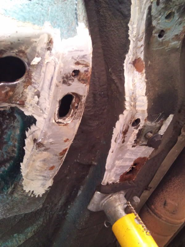

Found the rust in front wheel archs, everywhere else seems solid and these bits aren't too bad, can get the welding done for nothing.
am hoping i can fix the wings and not need to replace them

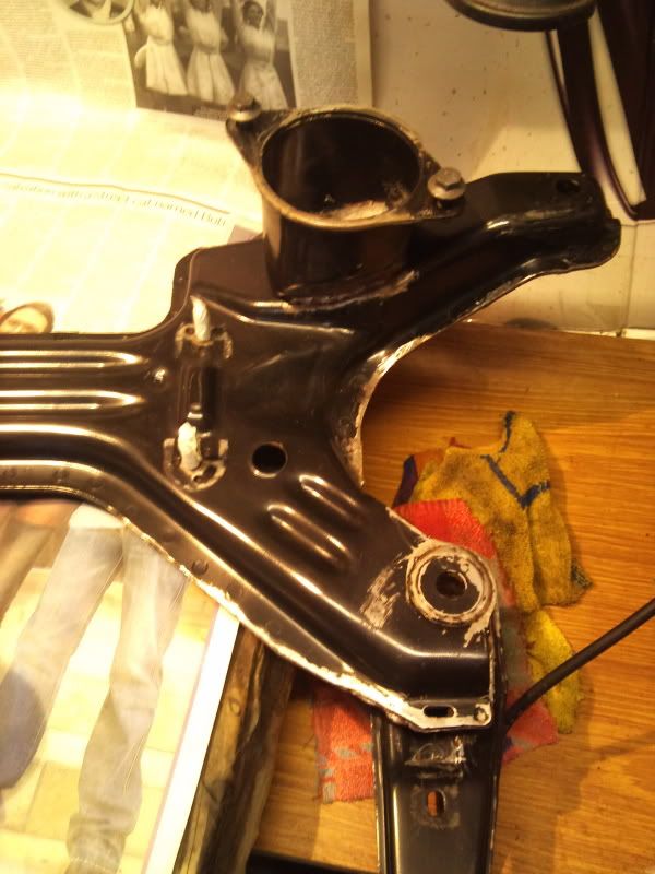

Subframe off

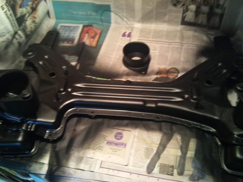

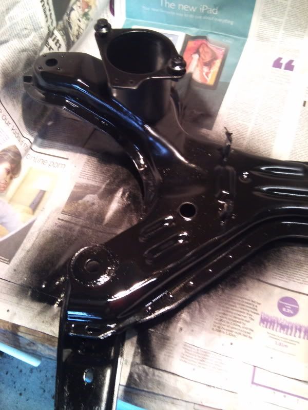

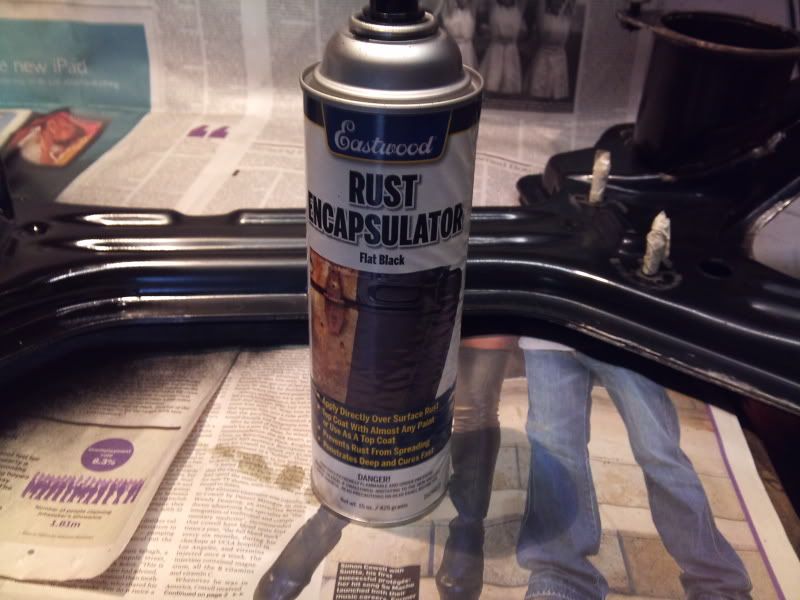

Cleaned up the subframe, got most of the rust off with Deox gel and the dremel.
Painting with this stuff for now, as a primer
First coat done, need to wait till its dry to flip over and paint the other side

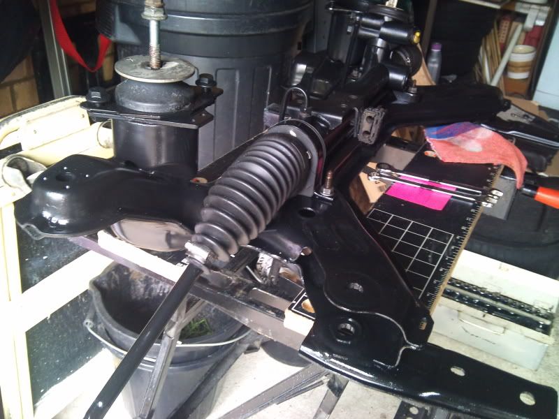

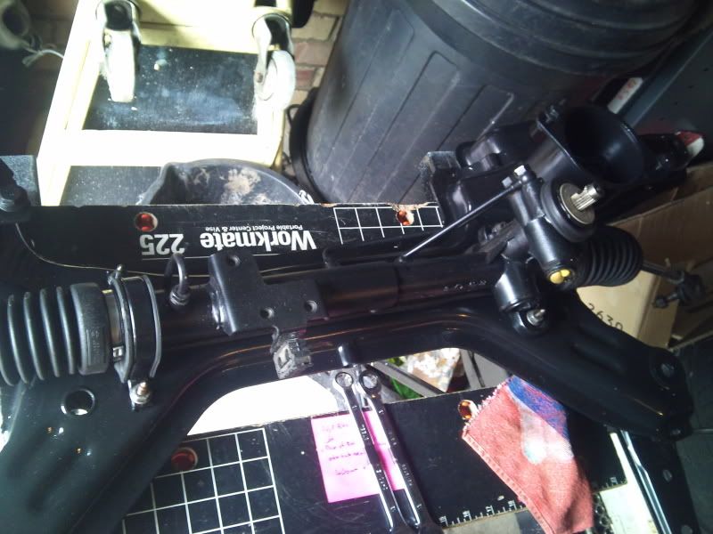

Steering rack is now cleaned up, fixed all the track rod issues and measured it all out so rack is central and the LHS track rod is to factory length.
Put it back on subframe, i used jubliee clips on the smaller of the two boot clips, as its easier to be able to undo them and spin the boot straight if needed

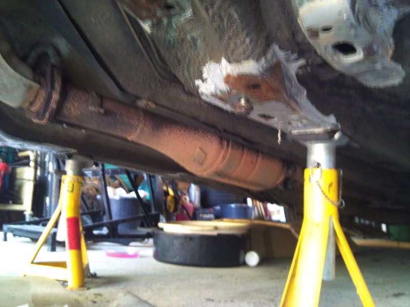

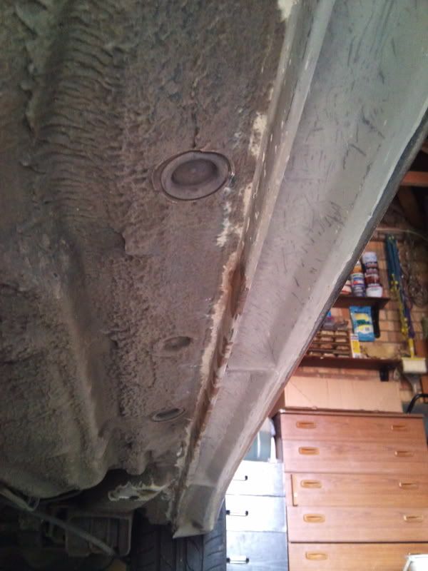

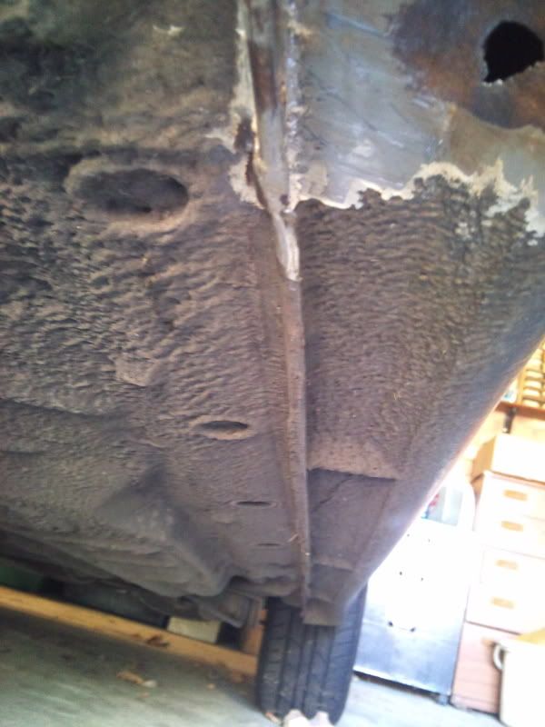

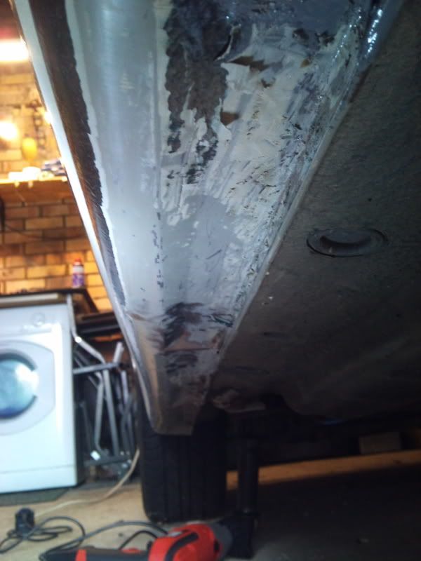

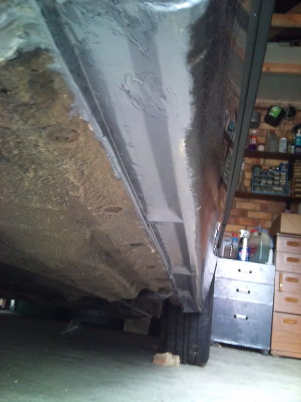

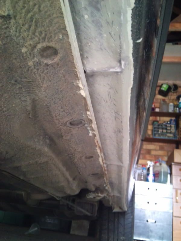

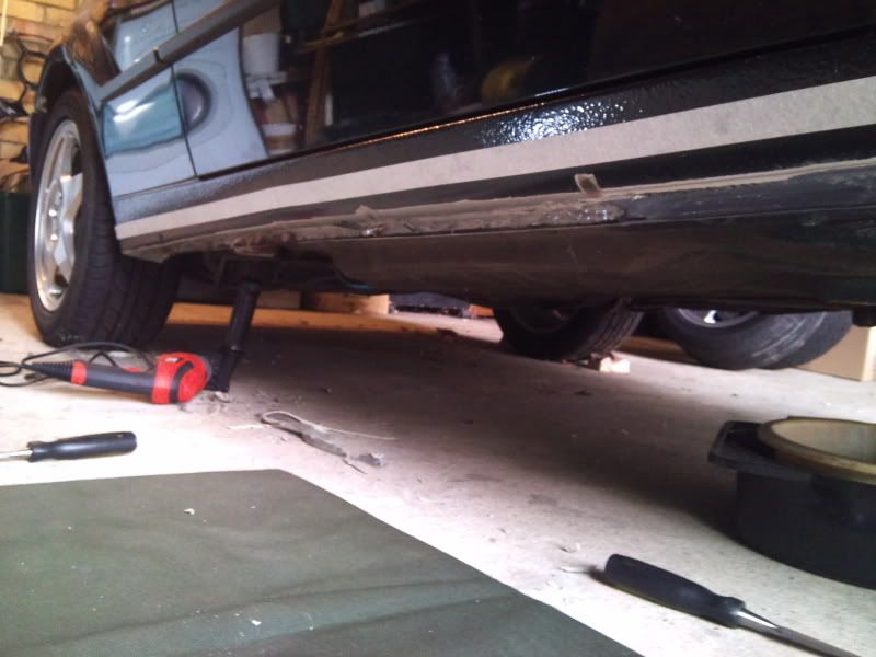

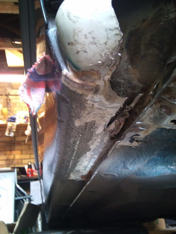

Also decided to scrape off aload of underseal as was only way to check the sills properly, took ages
Luckily all the bits i'm doing is underneath and out of eye line when stood up

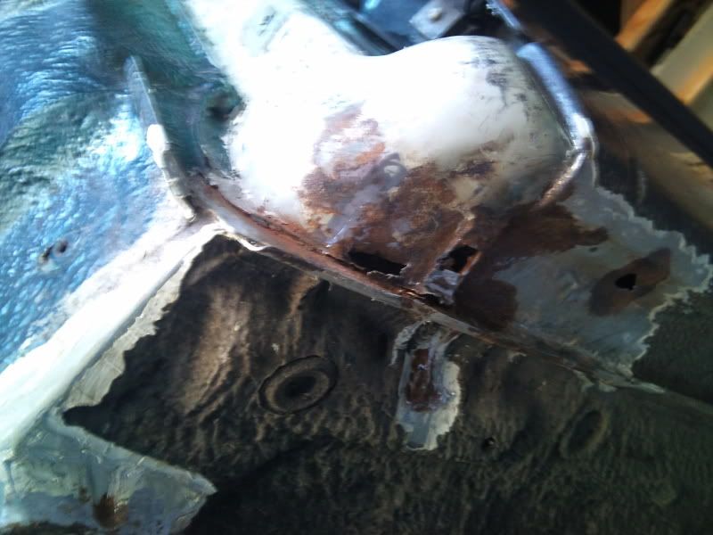

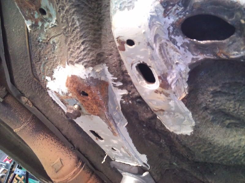

Holey rusted metal batman!
Will let photos do the talking as pc i'm on is so slow i'm about to smash it up
---------- Post added at 11:12 AM ---------- Previous post was at 11:04 AM ----------
Glad i did this rust when i did, as most of it was unnoticable. Was only a 5p sized hole that made me look.
Sills cleaned off, rather save these the most
Missing some photos, pc being annoying, so here are the last, i will update at some point.

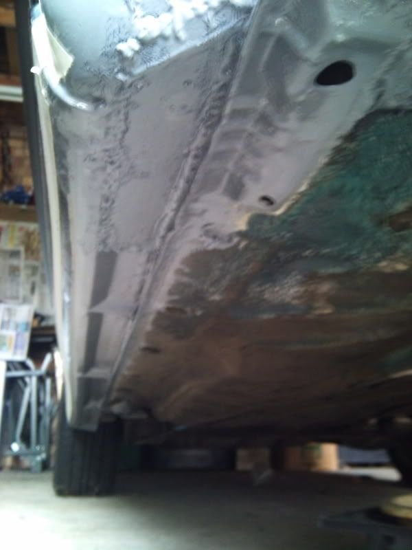

I've ground rust with a grinder.
Then used the 3 stage POR15 rust treatment, grey paint, will do another coat of POR15 in black, have sealed the seams with joint sealer, then got schutz to reapply once i can borrow a compressor. Also got new cavity waxes to apply on the inside of sill.
Welding repair isn't the most pretty, but i'm just want it solid and rust free so i can drive it everyday and use it properly

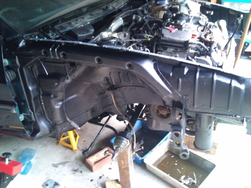

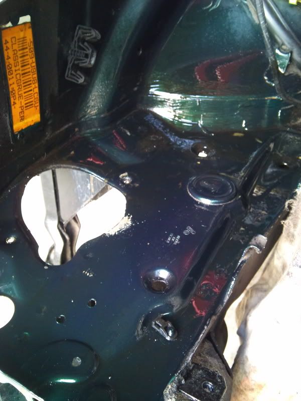

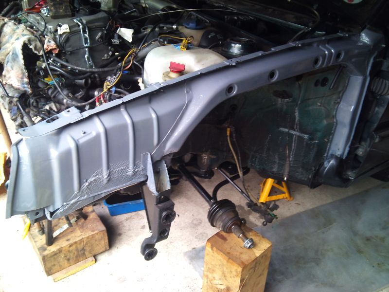

Got rid of any rust on inner wings and sprayed some wax protection on them

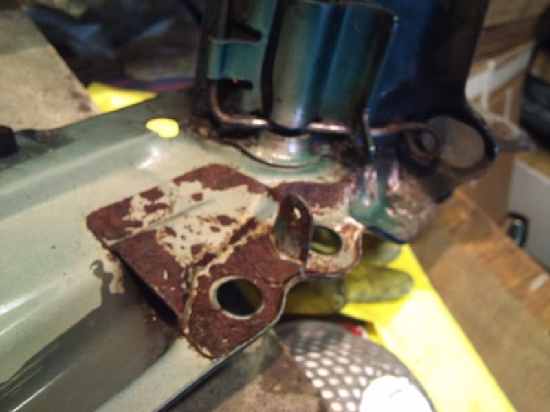

Started to sort out the slam panel, i think this rust is why the bonnet realease cable fails, the metal tab that cable pushes against has rusted and moves very slightly, meaning i keep having to adjust my cable ends

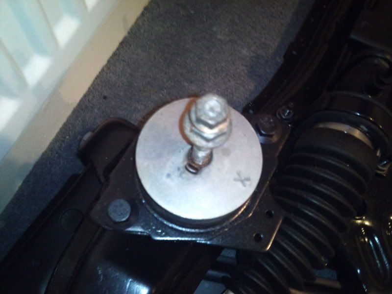

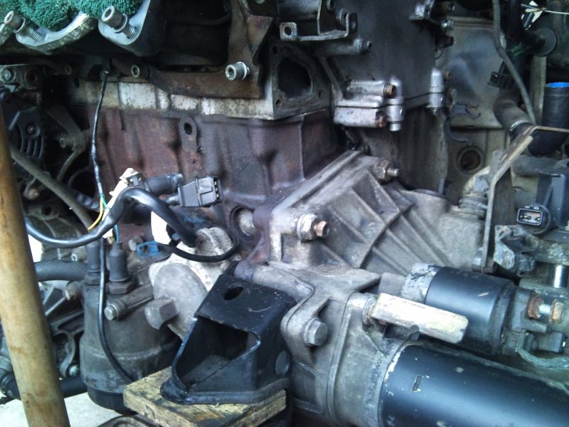

Also, does anyone know if its important which way this X goes on the gearbox mount?
Can't see what it means

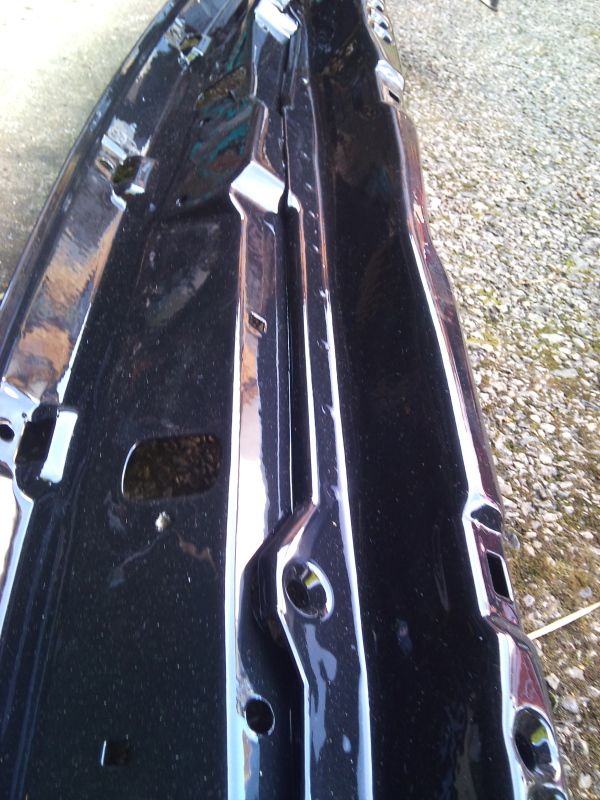

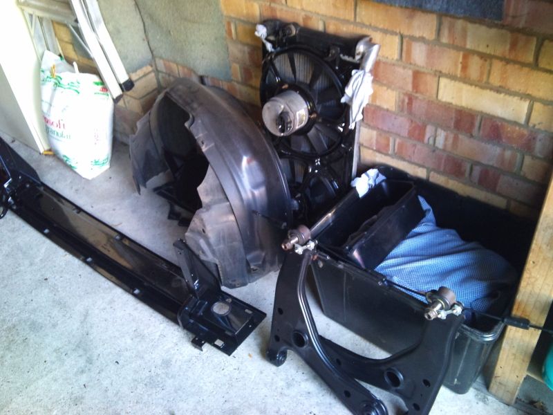

Got the front cross member and rad support off and dropped them at the powder coaters to be plascoated, will get pics when i get them back.

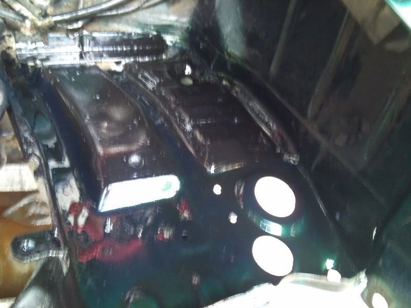

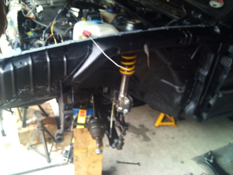

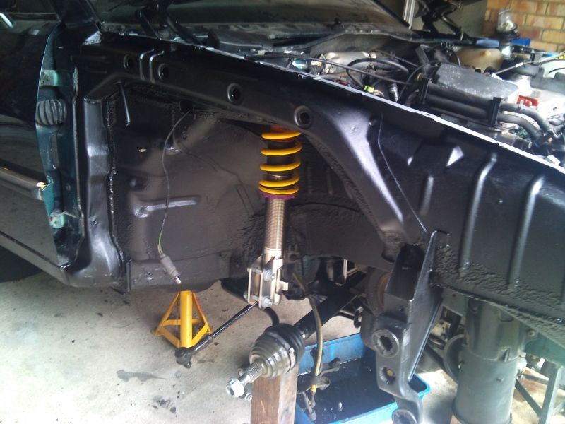

Did the inner wing bits that aren't covered in the VW stonechip stuff, painted them with POR15
Then decided to use the black Schutz stuff to go over that and also over the original stone chip in arches, Should stop any moisture and future rust.

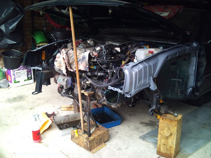

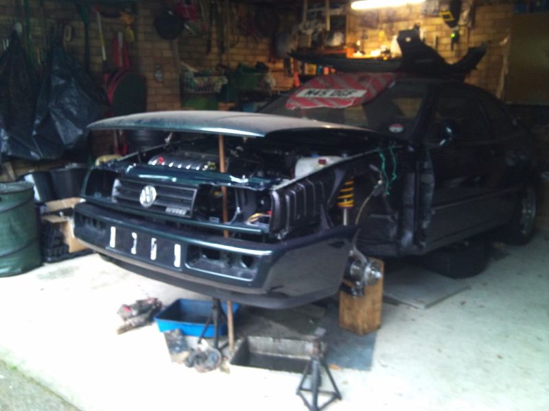

How car is at the moment
In other news, i got the subframe back on and connected the steering up.

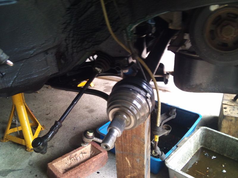

Fitted the new Outer CV joint
More stuff waiting to go on

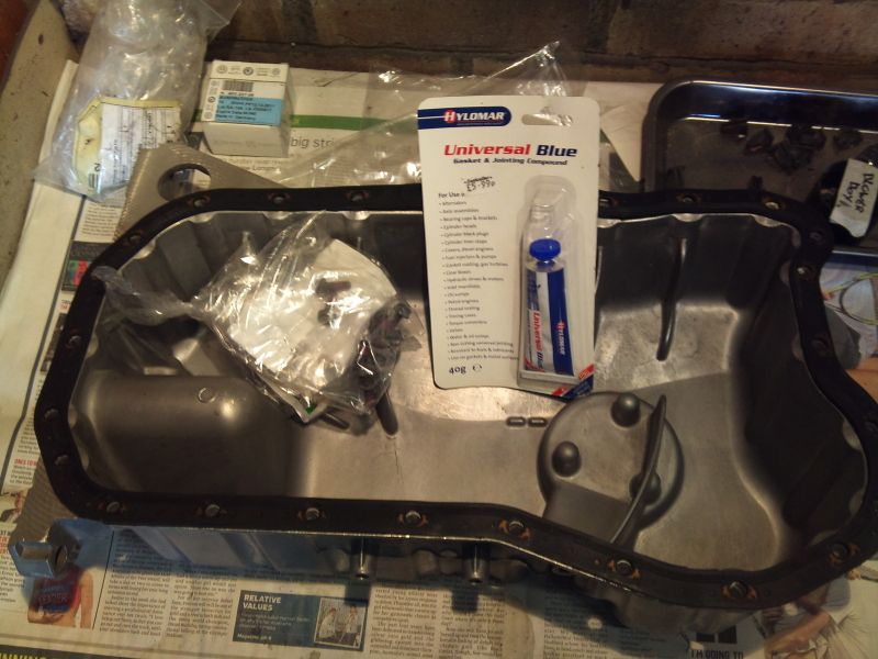

^^^For the sump do i need the gasket and sealant or just the gasket?

Don't think it matters which way round the gb mount goes.
I would use a thin bead of sealant with the gasket.
Looking good :). I second the above by the way, I think the mounts at symmetrical and I would use a small bead of sealant.
Cheers, going to use a smidge of sealant i think..

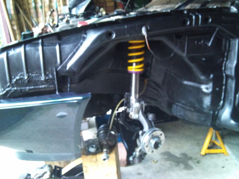

put my shocks back in

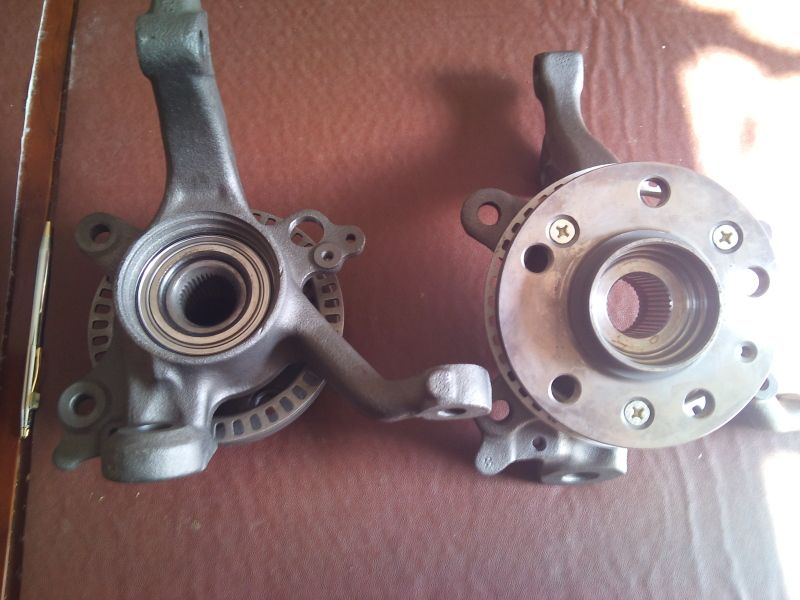

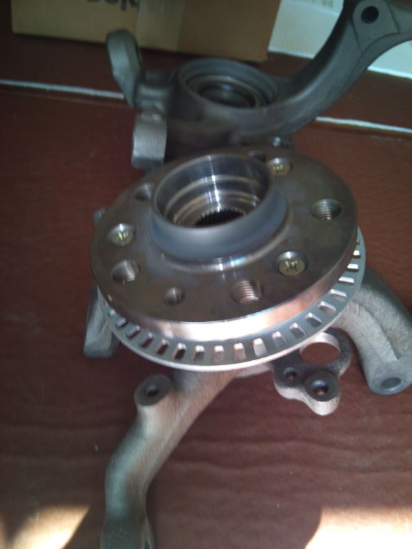

Took the hubs to garage to have new wheel bearings pressed in, then i can fit them and maybe get car on its wheels again.

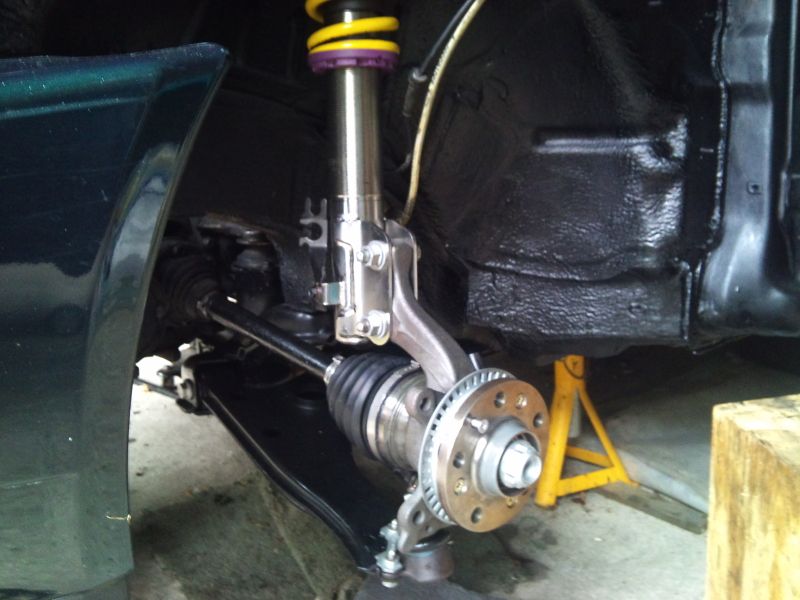

Just picked up my hubs, had to get a garage to press the bearings in for me.
Can put them on now and complete some of the suspension/steeering :! Just the brakes then i can put wheels back on.
Although might leave one side as gearbox is coming off to do timing chains
Slung them on the car

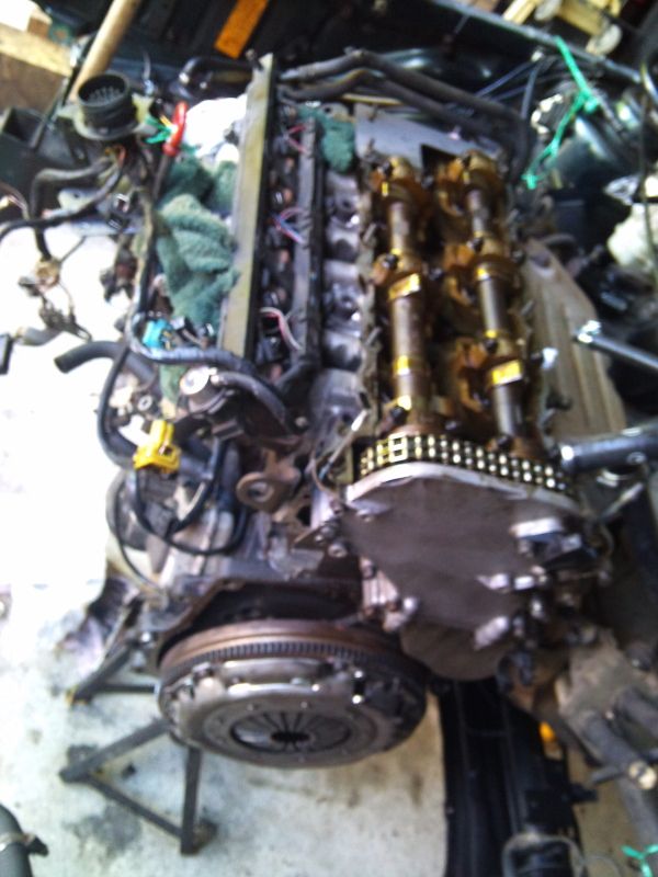

Cleaned up engine some more and stripped **** off ready to do timing chains, hopefully this weekend

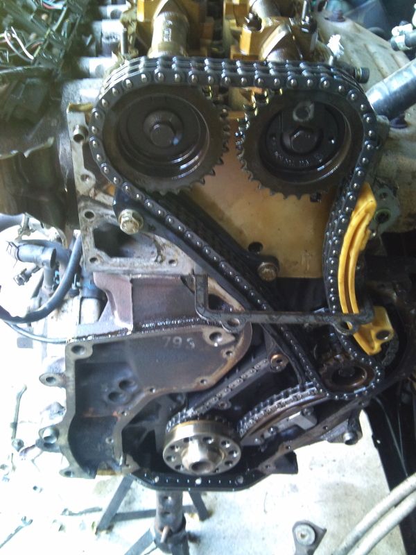

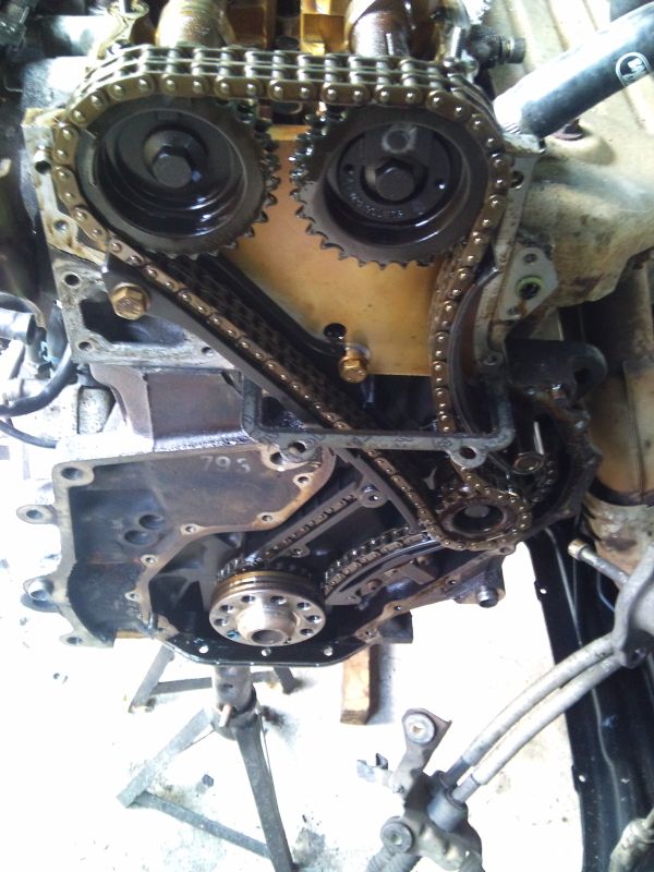

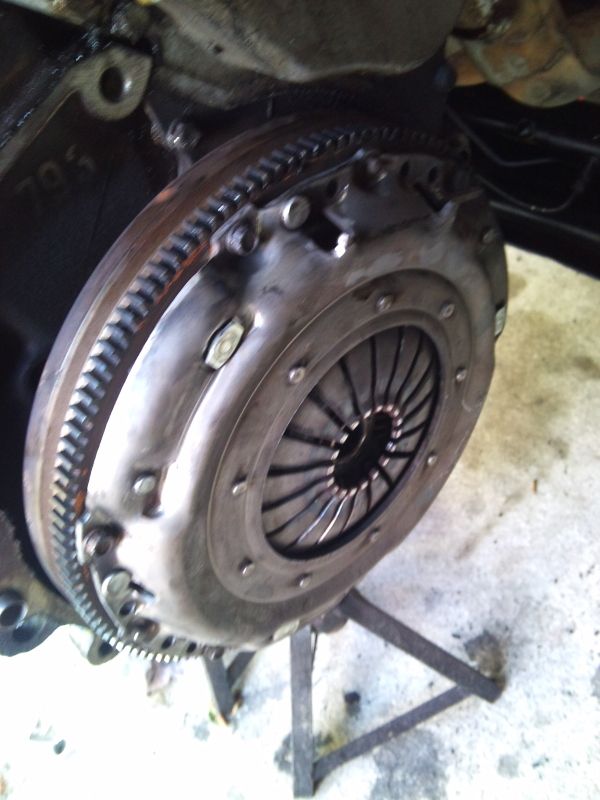

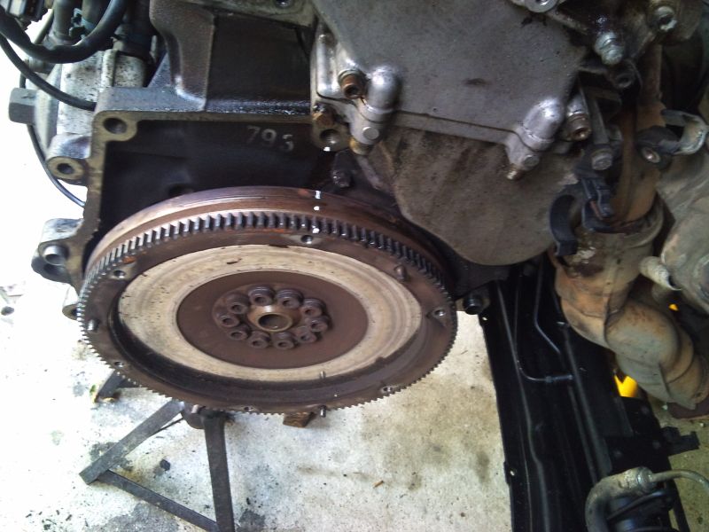

Got the timing chains and associated bits done yesterday. All went really well using the guide from here and some help from a mate.
Some pics, didn't get them for every step as was busy cutting my hands on the gearbox
This is where the gearbox was
Took clutch and flywheel off
BEFORE:
AFTER:
Has the mk4 upgraded top tensioner now. Will get pics of what came off, bits were snapped in half and the top tensioner worn right the way through and starting cutting into the metal part :! was shocking
Got bits back from powder coaters
Fitted that and the cross member, Those bushes are tough!

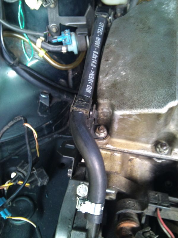

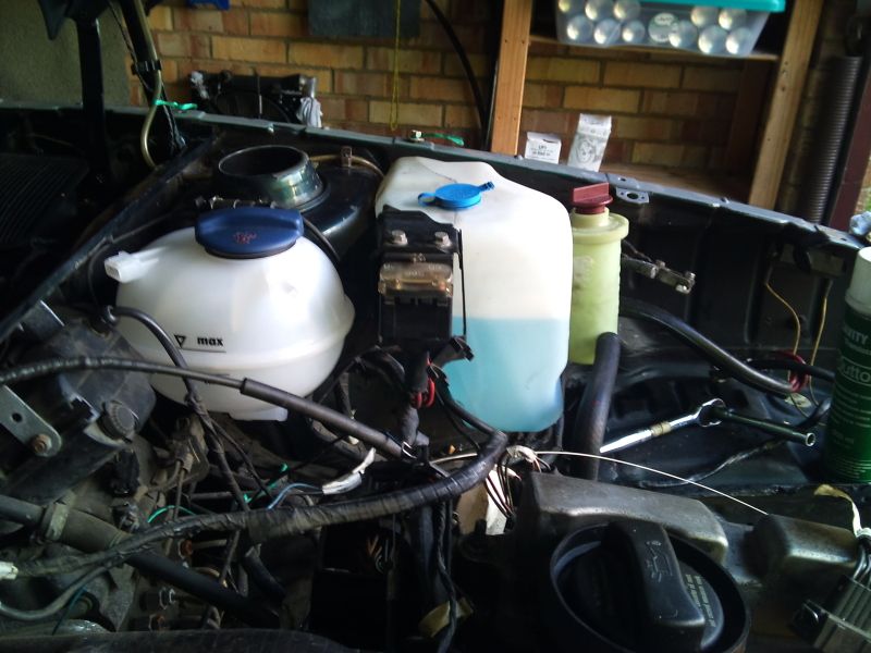

Did a few other bits today, like new header tank, new PAS bottle, new fuel lines
Got quite a bit done today, but its hard to see what i have done tbh
Pretty easy really, i did watch my mate did it and was telling him what to do (once he got stuck in he wouldn't stop), i reckon i could of done it. The hardest part was getting the gearbox off. Really awkward. Still got the deep cut in my hand :lol:

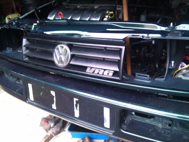

Done some more bits, painted the slam panel up and trail fitted with the grill, mainly because it looked cool
VR6 means the engine it has

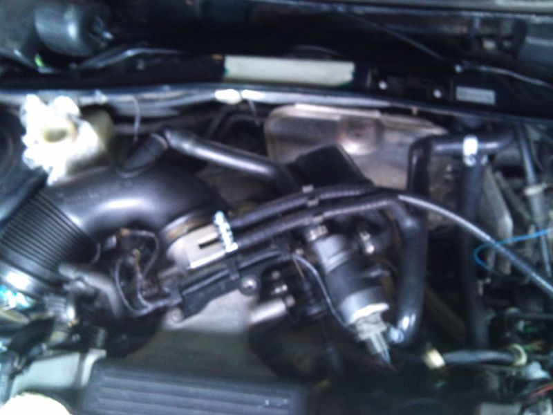

Aux water pump/thermostat and some samcos back on
Throttle body all connected up

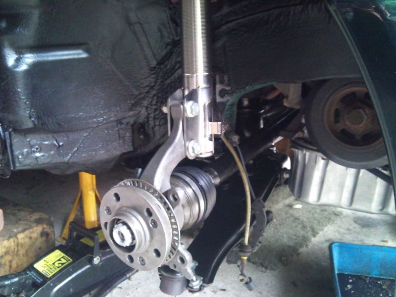

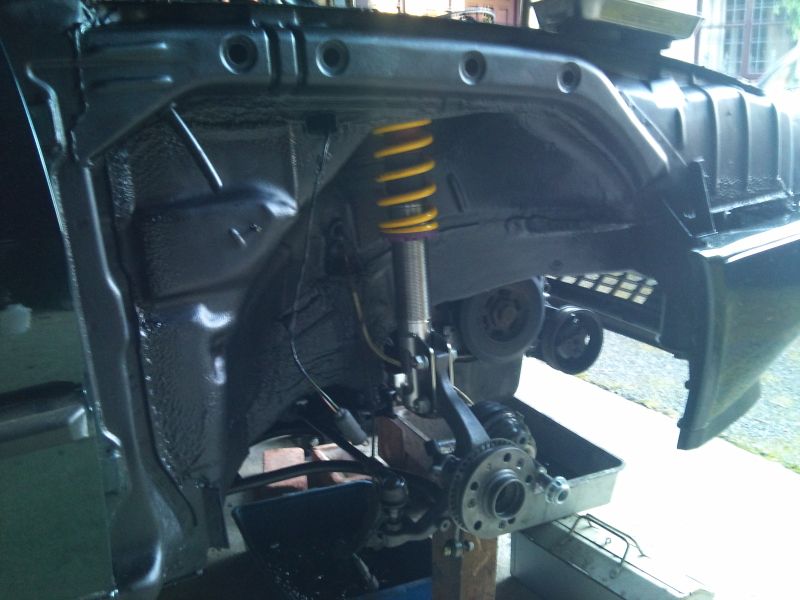

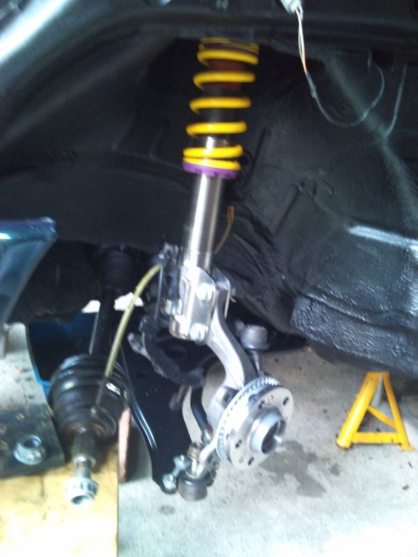

Suspension/steering back on both sides now.
