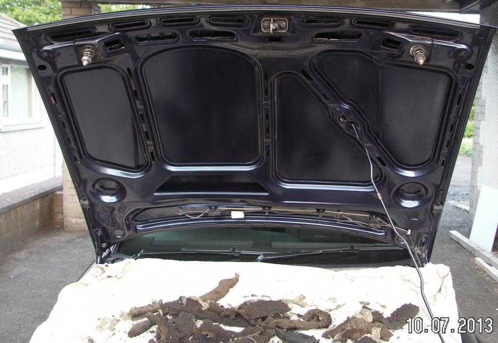

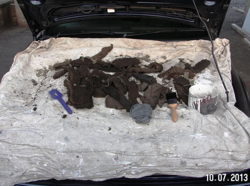

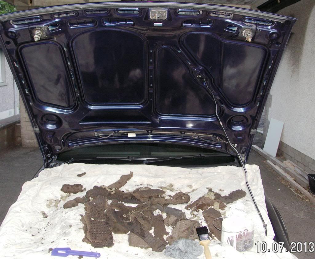

BILLCOR 1 Posted July 11, 2013 Well, another job I wasn't looking forward to... removing the bonnet insulation Started last night around 9pm, was all off and clean by 9.40 :smug: Scraped most of the crap of first, then gave the remainder 3 good soaks of white spirit, again scraped off the bulk of the adhesive, then some more spirit on a cloth to get the last of the scummy film, clean up with a dry cloth. Still got to wash it down with some car shampoo before sticking the new GB Insulation back on, just waiting for some spray adhesive arriving Dry scrape White spirit and scrape Finished off Quote Share this post Link to post Share on other sites

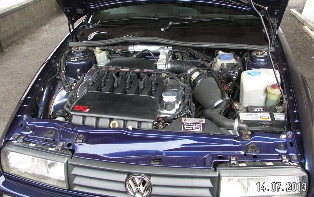

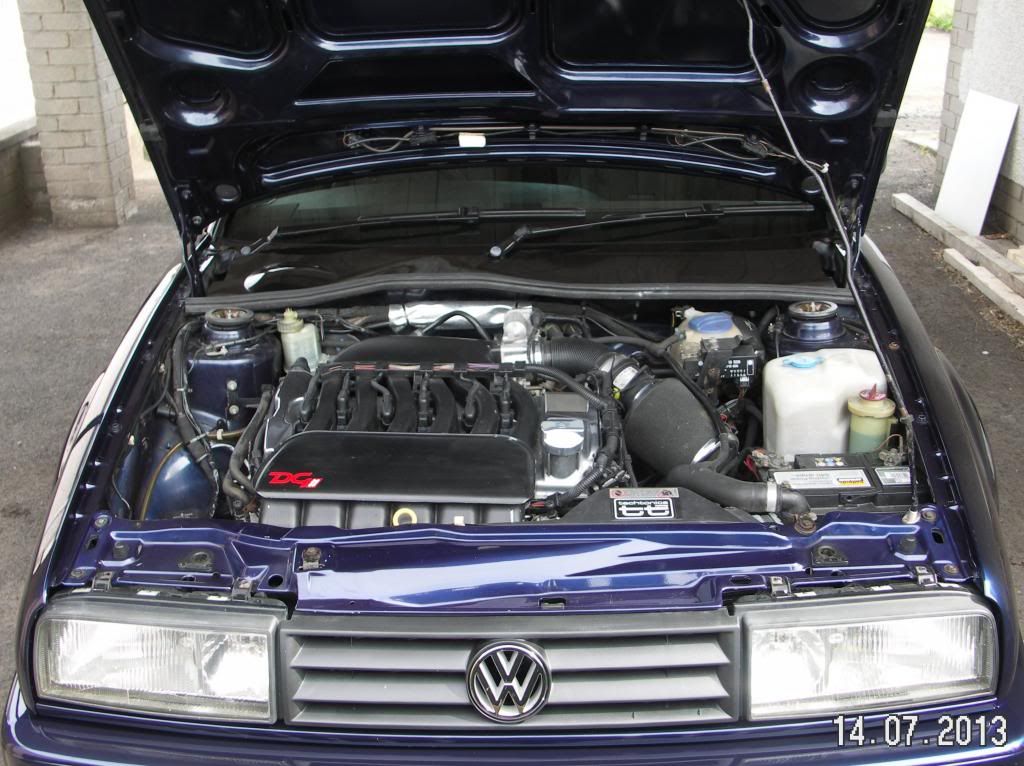

BILLCOR 1 Posted July 14, 2013 Fitted the SWG one piece scuttle, looks a lot tidier under there now Quote Share this post Link to post Share on other sites
