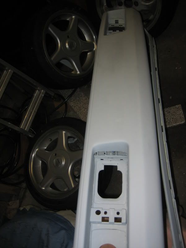

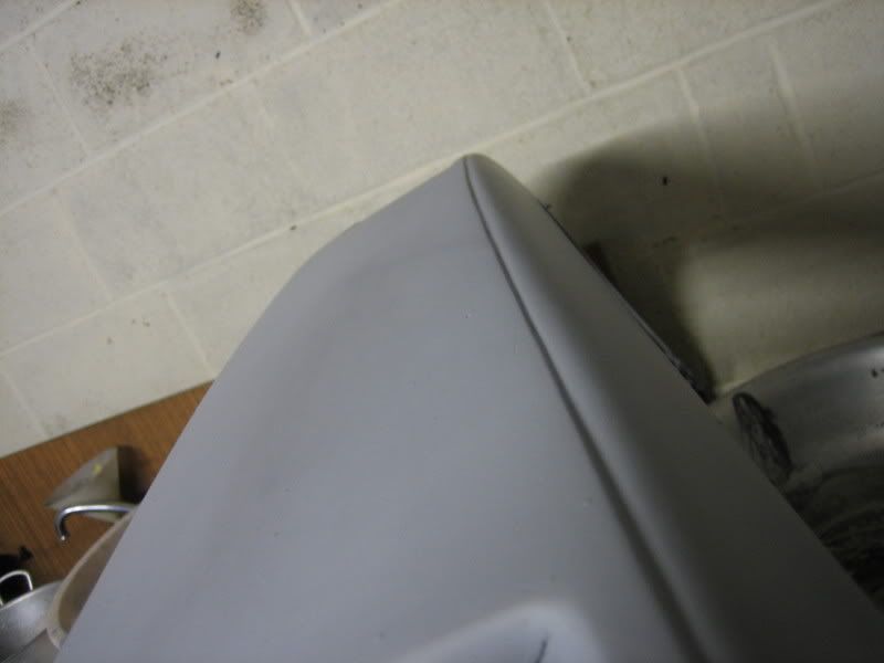

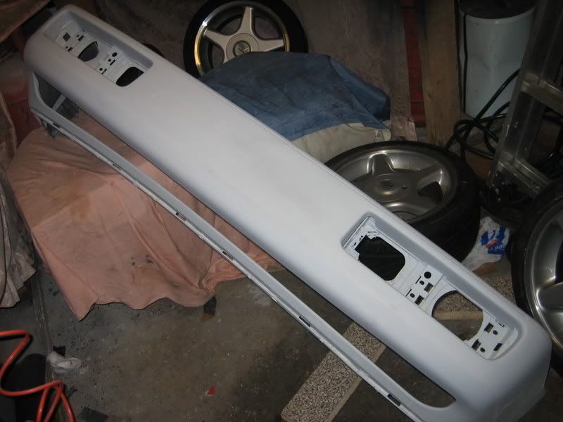

Bobby 0 Posted December 24, 2006 i plastic welding the recess first then skimmed it with some plastic padding fibre glass, heres some pics of mine. Quote Share this post Link to post Share on other sites
