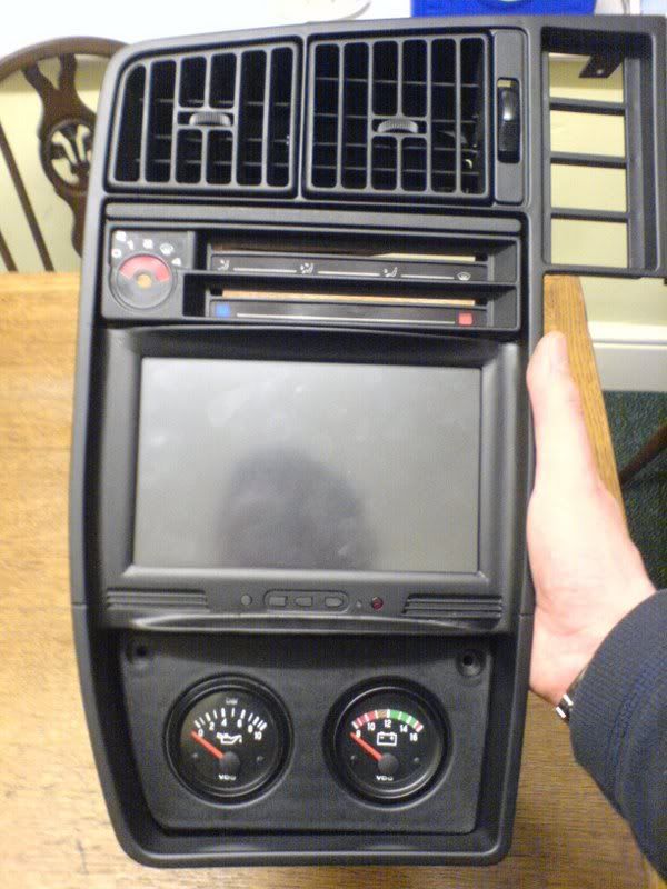

My carputer was one of my first projects on the rado, got sat nav, all my music, wifi, getting a new radio for it soon. My specs not quite as impressive as yours, its an epia mini itx 900mhz (17cm x 17cm) 512mb ram 30gb hdd dvd drive, seems to do alright performance wise.
I'm using an m1-atx 90w "intelligent" power supply, it has delayed startup and shutdown options and an amp remote to avoid amp pop when the computer switches on and off.
7" touchscreen fits quite nicely in the dash
th_DSC00372.jpg[/align]

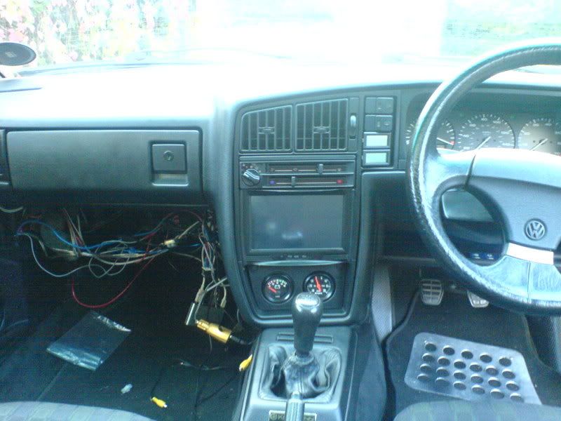

you can see a usb hub dangling in the second pic, I use an extension up to the glove box for plugging in my memory stick if i want to update anything. Other than that the main pc is in the boot, don't have any pics of that will take some tomorrow.

That is a really nice piece of work g60ff :thumb right: . Looks really smart.
