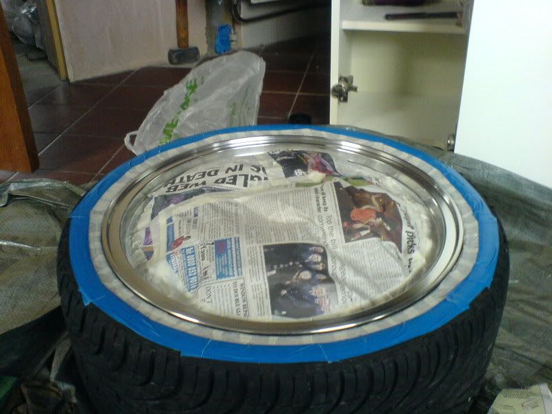

heres a pic of the wheel masked up and ready to spray (which i havent got round to as it decided to feckin rain!)
its not as difficult as it looks, to be honest the masking was the fiddliest job!
took me about an hour to get the lip gleaming again. Just take your timeand try to keep the sanding motion circular if you know what i mean, that way you wont see random scratch marks when you polish it up
