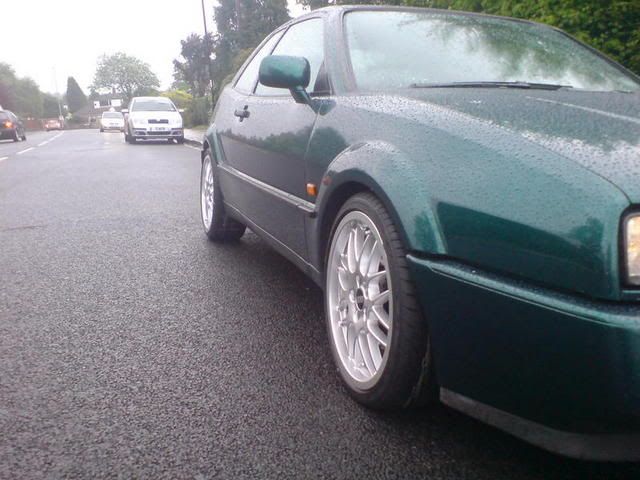

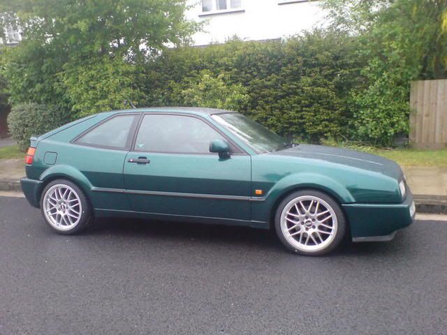

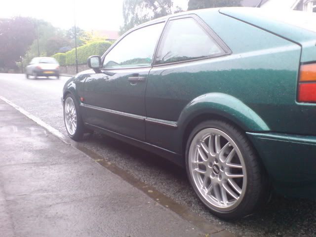

ziderapple 0 Posted May 8, 2007 Had a Brand spanking new set of BBS RX's delivered this morning, sporting Eagle F1's. 8) Pic's are not great as thay were taken in the rain with my phone not long ago, took awhile to remove my locking wheel nuts with out the key... 5/8 whit and a lump hammer works a treat! Really pleased think they look cool, OEM +.. Quote Share this post Link to post Share on other sites
dukest 0 Posted May 8, 2007 RXs always look really smart, good choice! 8) anymore piggy banks left to break open then chris?! Quote Share this post Link to post Share on other sites
CrazyDave 0 Posted May 8, 2007 They look really nice! 17's? Quote Share this post Link to post Share on other sites
Goldie 2 Posted May 8, 2007 Lovely, very good choice... Quote Share this post Link to post Share on other sites
ziderapple 0 Posted May 8, 2007 anymore piggy banks left to break open then chris?! :lol: Thats it untill the end of the year I'm afriad :( Next to do is coilovers, not decided on H&R or Koni yet, and eibach ARB's then It'll be pretty much sorted....(yeah right) I got the BBS at a price I couldnt refuse really, cost about the same as the tires! I am doing the head and a set of rings over the next couple of moths though. Next year its all cosmetic, a mate of a mate is a car trimmer, all ready sorted out a deal to get some alacantra trimmed in... :D Quote Share this post Link to post Share on other sites
ziderapple 0 Posted May 8, 2007 Yeah 17's, (17x7.5 runing 205 40 boots). Booked in tomorrow for tracking and camber... at last, been out since I did the chains :oops: Quote Share this post Link to post Share on other sites
herisites 0 Posted May 8, 2007 Thats much better now Chris! They looks spot on and some nice grippy eagle f1's to put that power down! When you get the coilovers and ARB's it will be awesome! Quote Share this post Link to post Share on other sites

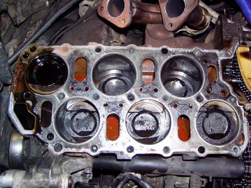

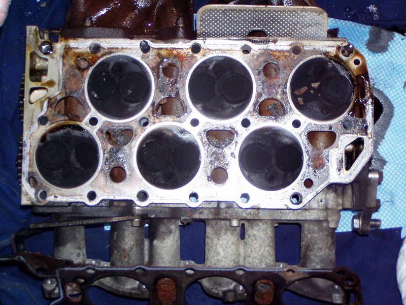

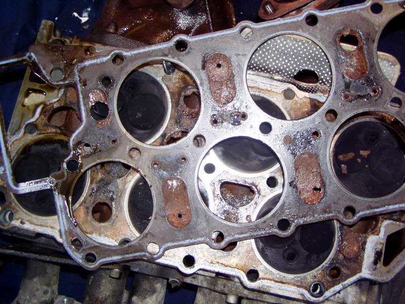

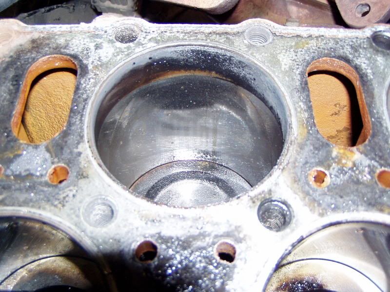

ziderapple 0 Posted July 21, 2007 Well I was up early this morning, went to pick up a headgasket set, set of rings, new big ends, head bolts and 2 gallons of synta.... yup finally got round to sorting the headgasket and rings. Few pics: Glazed bores anyone?? They're like mirrors!! :lol: Replacement head (Thanks Karl) is nearly built back up, sumps off so in the morning its pistons out, hone the bores and all back together, should be done my monday night, no more embarrasing blue smoke!! Yay! Quote Share this post Link to post Share on other sites
KADVR6 0 Posted July 22, 2007 you dont waste anytime do ya chris :) at least i know where to come when i need my headgasket done :) did you get any BBS dust caps?? only asking as i was cleaning out the garage and found my spare set, and i dont need them. karl Quote Share this post Link to post Share on other sites
ziderapple 0 Posted July 22, 2007 Its needed doing for months but I've only now got the time and money to do it. I'm a bit worried the gearbox may have to come off as I'm not sure I'll be able to get the pistons out without turning the crank which means setting all the timing up.... :( Fingers crossed I wont have to. No I didnt get any caps in the end.. so I'd gladly take them off you. :D Quote Share this post Link to post Share on other sites

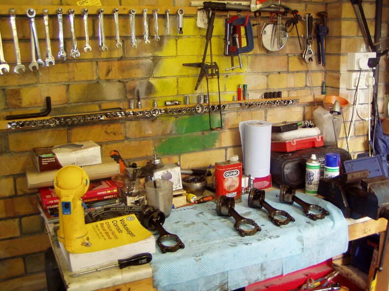

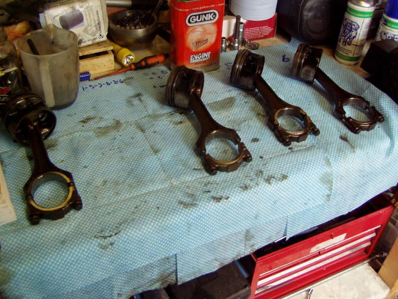

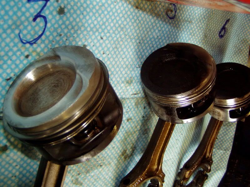

ziderapple 0 Posted July 22, 2007 Few pics from today, only got four of the pistons out as I need to turn the crank so I can get a socket on the remaing two but I need someone to hold the top chains to stop them jumping a tooth or two on the intermediate cog and they was no one to help me :( Still gave me a chance to give the garage a good clean out. My little work station Quote Share this post Link to post Share on other sites
