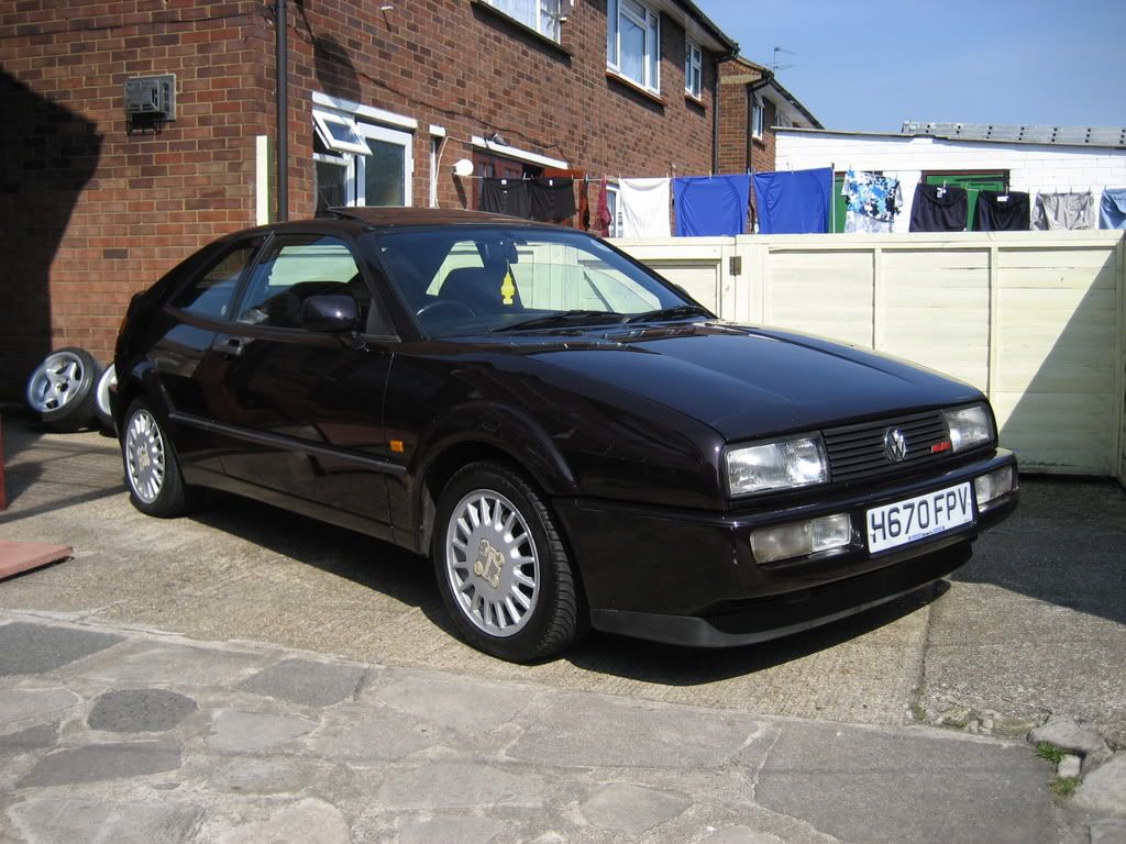

Before:
After:
Lovely wheels 8)
I have 9x16's on m VR all round. et30 on the front with rolled arches and et15 on the rear and i have angle grinded the lip away and mine still catch. Yours being a 16v however it has a narrower track than the VR so i would imagine just getting all 4 arches rolled would be enough to stop catching.

by the way, they make a world and a half of difference - the car looks great! goes from being average hatchback to mean-machine! what drop have you got?
