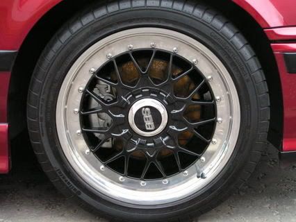

Ive got a set of BBS split rims that came off my old 328 BMW and i fancy trying to get them on my rado. I know im going to need to get hub adaptors and have spoken to performance alloys where i got my last set of Porche ones. They say the thinnest set i can get ar 20mm. Now considering the Wheels are et 41, with the adaptors this will make the offset et21. The wheels are 7 1/2 front and 8 1/2 rear and i know the standard VR6 et is 43. Just wanted some opinions as to whether you lot think it will be too much work to make them fit or if they will stick out a mile.
I know a few people are running 9s at the back with 20mm offsets and just wondered how they got on with them?
I realise that the arches will probably need to be rolled and i will need a bit of a stretch on the tyres but i would love to see them on the car, just dont want to waste alot of money if its not worth it!
Could do with your thoughts and ideas please?
