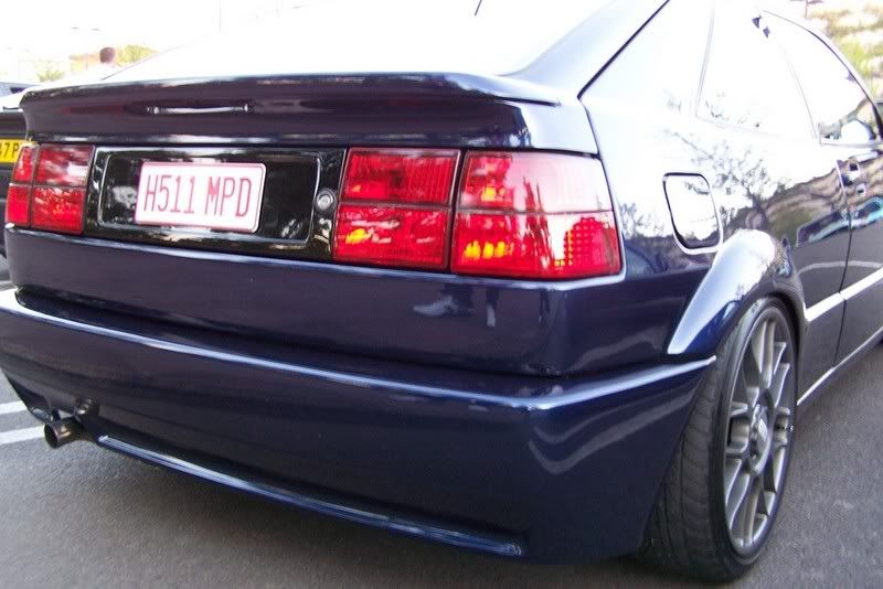

Hi mate, I used metal polish to remove the chrome... & when I get the chance paint the tops in matt black.. Ive dechromed the middle line too... look alot better... 8)
You can also use wet and dry paper to remove it, then primer, then paint. It's what i'm currantly doing to mine.
As Bally has said they look loads better when they are not chrome.
Pics are on their way........
i did mine with wet and dry, smoothed all seams and then used plastic paint, as well as tinting the clear sections so they're all red.
finish isnt crystal anymore, but prefer the look as more oem.
Thanks for that chaps. Looks leagues better without the chroming. Bally, do post up some pics of yours when they're done.
pic taken from bluewater vag meet lastnite....
