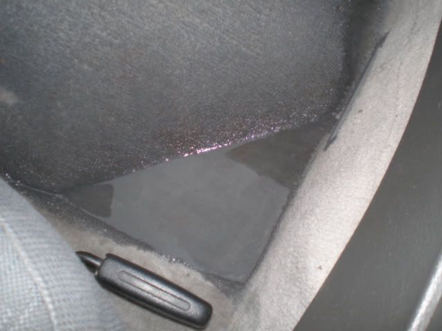

Glad im not the only person whos had this problem. Came back from Silverstone earlier this month to find my passenger footwell looking like this
Only the bottom of the carpet was wet not the sides or anything and it was only the passenger side. I took out the carpet to dry it off and give it a good clean and i havnt had the problem since. Im going to replace foliage cover after reading this thread and hope for the best!
