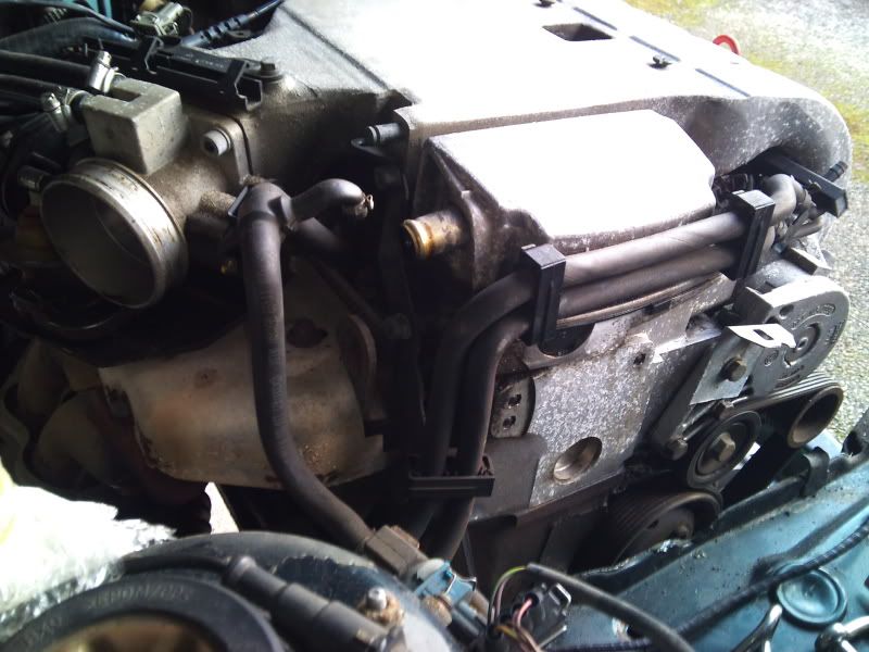

Jim Bowen 1 Posted February 4, 2013 Here is my Heath Robinson bracket, could probably make it a bit better these days, but its worked fine for years and tens of thousands of miles Quote Share this post Link to post Share on other sites

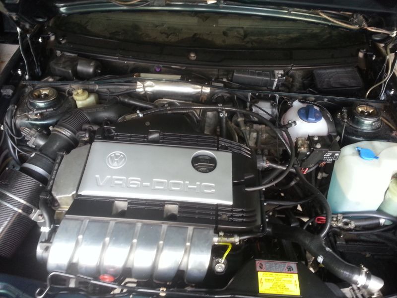

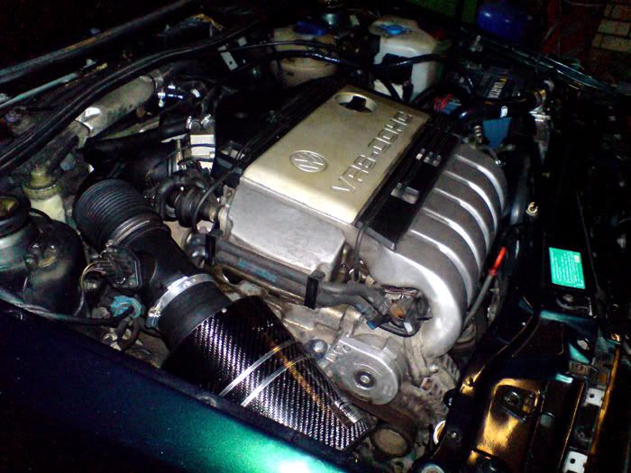

CazzaVR 0 Posted February 4, 2013 (edited) One of mine with Dave's 'test' bracket... Mark, you should have: silicone MAF coupler inc 2 X jubilees; the circular mounting bracket that goes around the BMC; corrugated metal intake hose + jubilee (not fitted on any of the pics above); mounting bracket (attaches to tensioner). Edited February 4, 2013 by CazzaVR Quote Share this post Link to post Share on other sites
