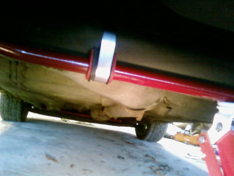

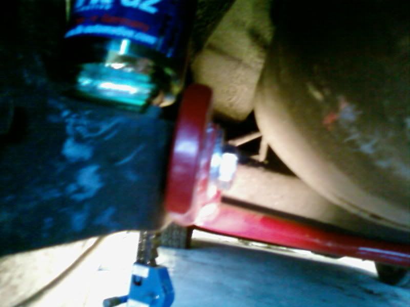

As the title suggests i just want to check ive got this right before i go bolting it all back up properly. Nothing came up on fitting in the search.

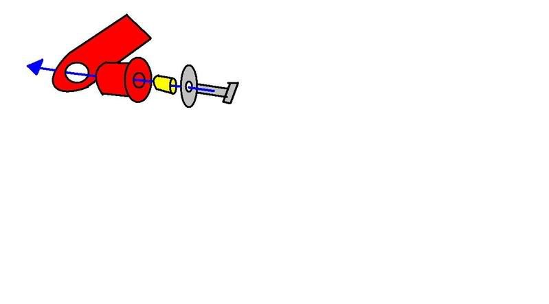

My excellent paint skills show how ive fitted it to the bottom shock mounty bit:

Yep thats fine, that bolt should be 85-90mm rather than the standard 75 and should be torque'd to 70Nm
Make sure you spray some white grease on the ties that attach it to the beam as they go rusty as fooook...

Looks all good to me.
