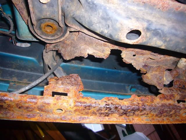

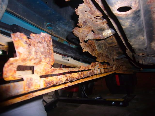

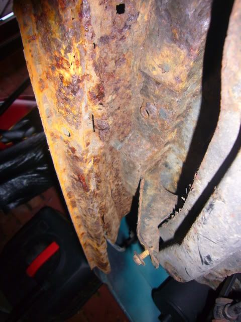

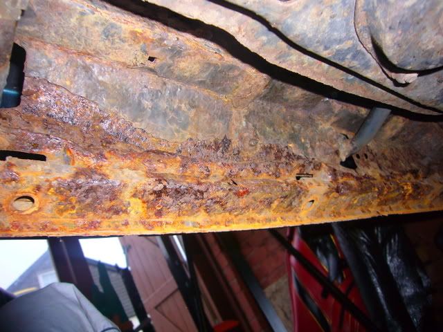

rajarella 0 Posted February 17, 2009 Well after almost a year I have finally got around to tring to sort the rust behind the front bumper. As you can see from the pics it is very bad :pale: . Has anyone got the part code or part name for the piece that needs replacing? I will need the metal strip that joins the spoiler to the bumper as well. Quote Share this post Link to post Share on other sites

rajarella 0 Posted February 17, 2009 No it is for a 93 vr6, does that make a difference? I know the cross member is the bar that runs parallel to the bumper but does it also incorporate all the the thin metal in front of it? Thats the piece I need, as you can see from the pics it is almost non-existent on my car. Rich Quote Share this post Link to post Share on other sites
Dec 1 Posted February 17, 2009 The metal 'sheet' that is rusted through in your photos is separate to the actual crossmember. You can see how it attaches to the chassis once the crossmember is removed. Just a note: You should support the crossmember with something like a jack when you have removed the two main bolts on either side! When they are out it is only the small middle bolt supporting the front of the engine, and that bolt only secures to the top section of that rusty sheet! Quote Share this post Link to post Share on other sites
rajarella 0 Posted February 17, 2009 Can you buy a replacement for that rusty sheet separate? Is it the £175 part mentioned in the earlier post? Quote Share this post Link to post Share on other sites
__Andy__ 0 Posted February 17, 2009 the bit i have is deffinately the bit you need, whether its actually called the front cross member i dont know, it will also have the engine mount on it. i dont think my crossmember will be of use to you though as it has the valver engine mount, the vr6 crossmember is slightly differnt to allow for the differnt engine mount, however you may be able to seperate the lower section and use my bit which is the bit you have that has rusted through. (if that makes sense).. diagrams enclosed should show what i mean... Quote Share this post Link to post Share on other sites
rajarella 0 Posted February 17, 2009 I see what you mean, that is the bit I need. Would you be willing to split them? The cross member isn't much use to me if the engine mount placement is different. Rich Quote Share this post Link to post Share on other sites
