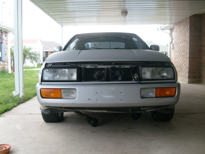

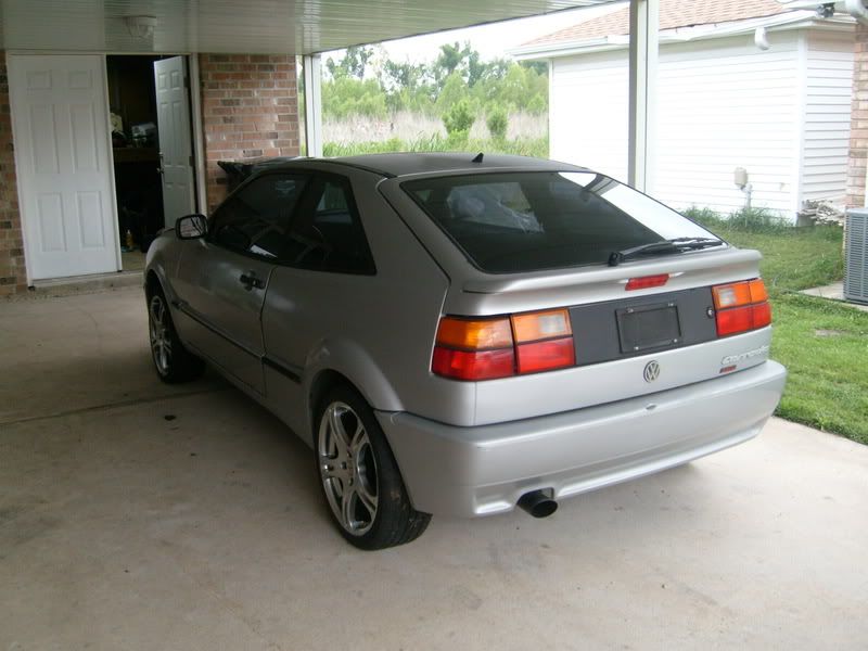

EXTERIOR:

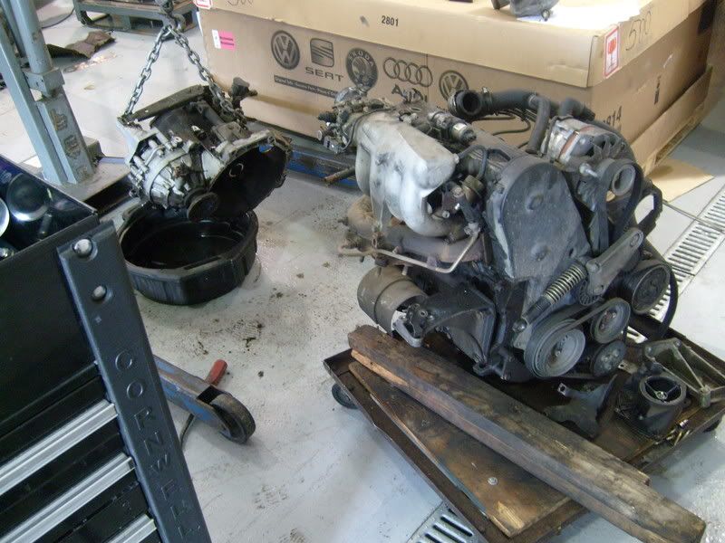

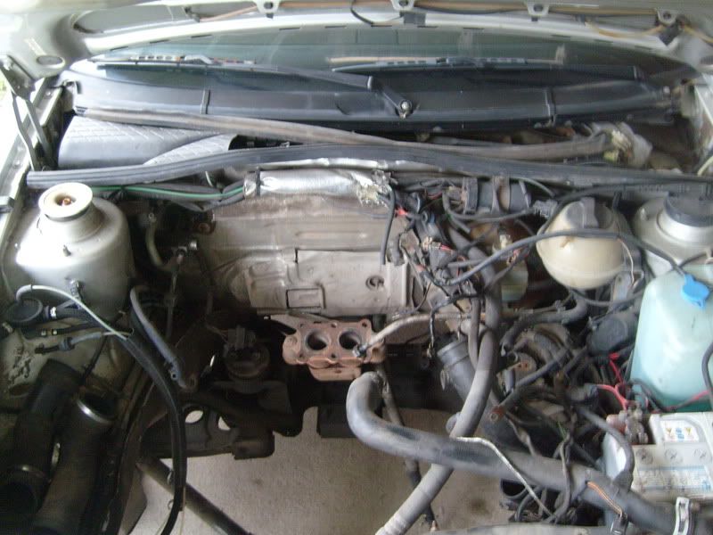

ENGINE / ENGINE BAY:

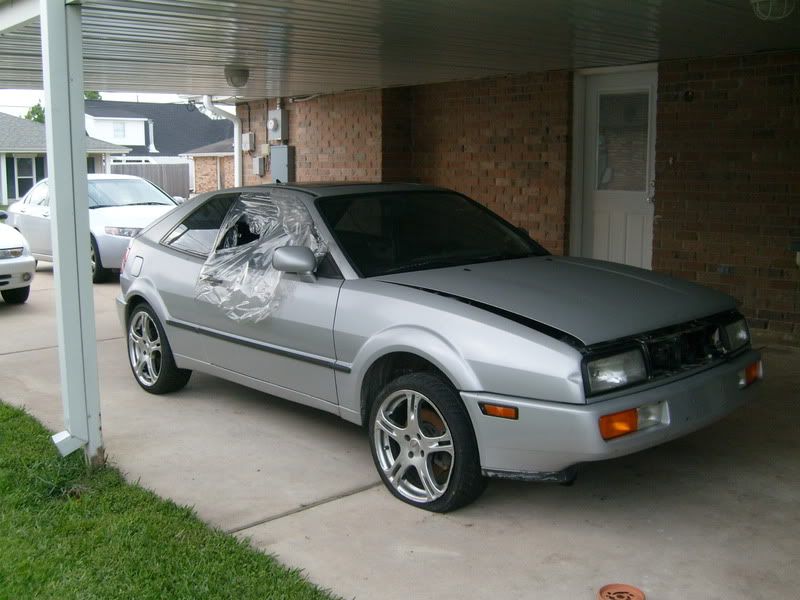

PROGRESS SO FAR:

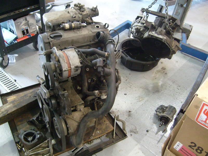

I've started stipping down the engine and been degreasing everything. the rear main seal was leaking and caused a bit of a mess. :pukeright: I have a full engine seal set, and plan on purchasing the internal mods and sending off the charger within the week. I checked out the injectors and found one to be total garbage & the rest only mediocre... the injector harness was trash so i made a new one today using genuine AG wiring...well Porsche AG. Perks of the job 8). Judging from the state of the "green tops" i'm just gonna spring for some "red tops"
I hooked up a battery and tested a few things out to see what works and doesn't...to my surprise the spoiler is in good working order along with the headlights, wipers (well front ones at least), horn, locks and drivers window. passenger window needs a regulator. while i wait for the goodies to arrive i'll be stipping the interior and prepping it for new sound proofing and start on some minor body work.

some new rims?
is it me or does that front one look like it has a flat spot :shock:
i haven't quite decided on wheels, however, i do like the Racing Hart CR 2 pc wheel. not sure if they still make them tho.
and, yes, that is a flat on the rf

Welcome :wave: . If you really want to free your engine then you are looking at 2 other mods. Firstly get rid of the crappy side mount intercooler and get a fron tmount one (preferable from a Golf G60 as they are a direct fit). Secondly a flowed head, especially if you are going to use a modified cam. Assuming you are in the US, then Bahn Brenner would be your first port of call....
Heres a link to my old members thread - I did a lot of work to my old G60 and it got daily hard driving. Being a bit lazy but check the list - you might find more mods that will work for you viewtopic.php?f=11&t=19558&st=0&sk=t&sd=a&start=30.
As JMC said - the flowed head is a great move - you can go one step further though and get a big valved head - one of the best mods I did to it. I'd confidently say the other best mods done were the engine mounts, oil cooler and suspension. The rest were certainly secondary... The ISV reroute is usually not advisable. And you may find you dont need the 3.5FPR - well not at first anyway - at 203bhp 197lbs/ft mine didn't need it. Supersprint exhausts are heavy but well regarded - I was happy with mine and it was of good quality - but eventually the weight pissed me off. Consider sticking with the std air box and just replace the filter - dont get a cone filter.
After going on track with it I realised the springs were too soft at 250/200, OEM bushes the same (despite being new), the 280mm single piston brakes were highly insufficient, gear ratios could do with changing a bit and the water cooling was not up to par. The power and delivery felt good! Had I of kept the car, those shortcomings were what I was going to next focus on.
Plenty of reading to be found on G60s here - but just ask if youve any q's - happy to help out. You're doing what I always wanted to with mine - good luck with the project :) Might be easier for you to use a thread under the Members Gallery too for a build diary?

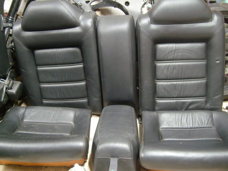

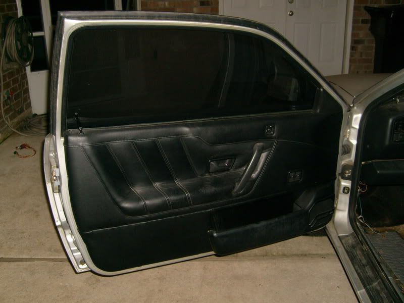

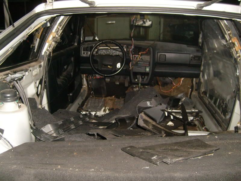

Here are pics of the sub par interior as i got it

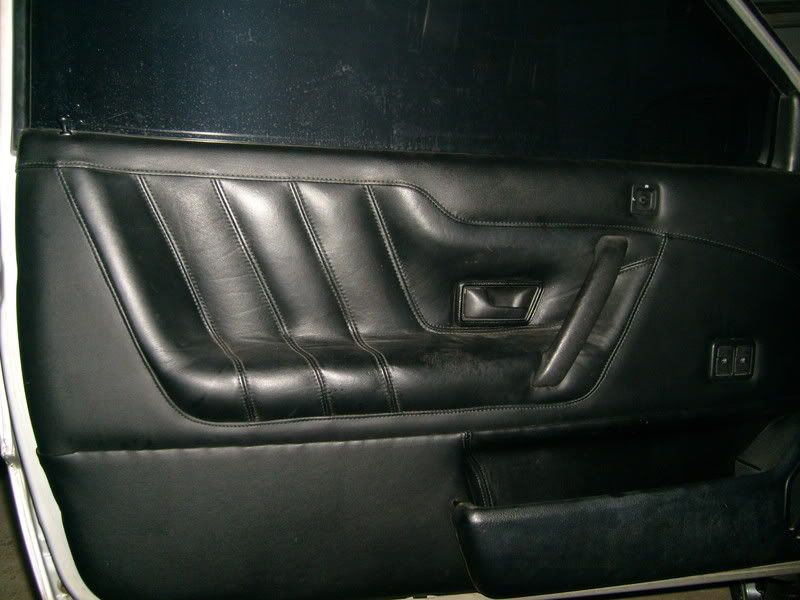

Door skins in good shape :clap:
Chaos

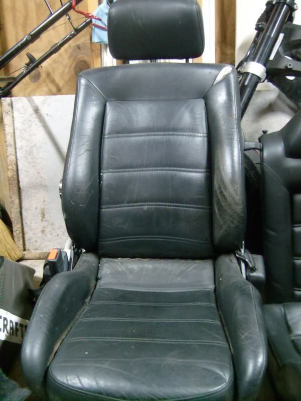

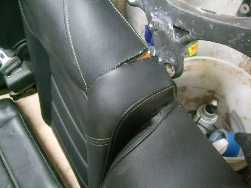

Front seats need recovering. Leather is hard and worn also split at seams
Stitching gave out in a few spot :(
Rear seats in good condition

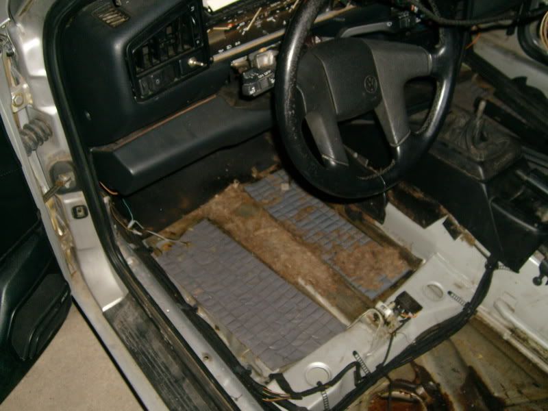

- CARPET -
-After searching and searching and searching, I got one of the parts guys at work to look up the carpets. we found out that VW only has the front carpets still available as old/new stock :bad-words: The middle and rear hatch carpets are no longer available. So once we had the part number we searched for availability and found out that there were only 2 left in the country and they cost $600 USD :camp:
Luckily I found a guy on eBay that is parting out 2 C's and snagged a full carpet set and headliner off him for much less than the $600 the front carpets would have cost me :nuts:
I also have Dynamat Xtreme on the way, so within the next week the interior should be well underway. :salute:

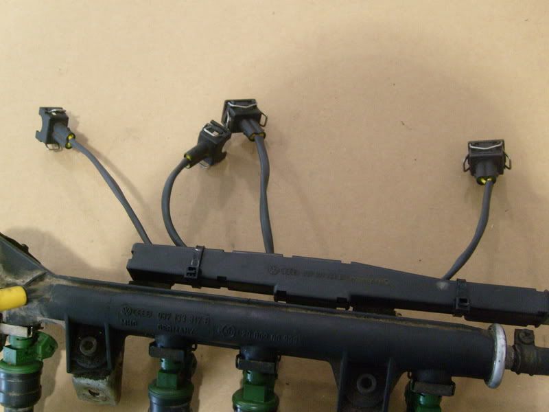

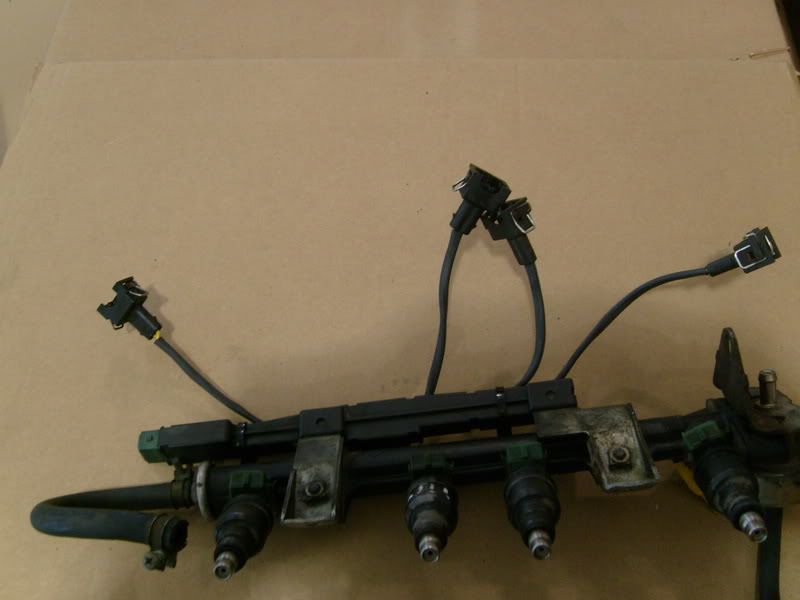

Can't wait to get all the engine work going, but for not i've just been checking all the wiring for each system and replacing the brittle or frayed wiring with new stuff. I'll try to get a pic up of my newly made injector harness up within the next day or so, as i am quite proud of it LOL
Thanks for the help and support guys!
here's some new pics of the injector harness

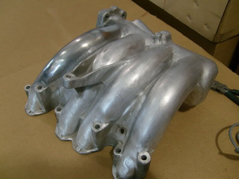

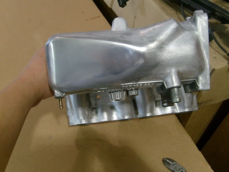

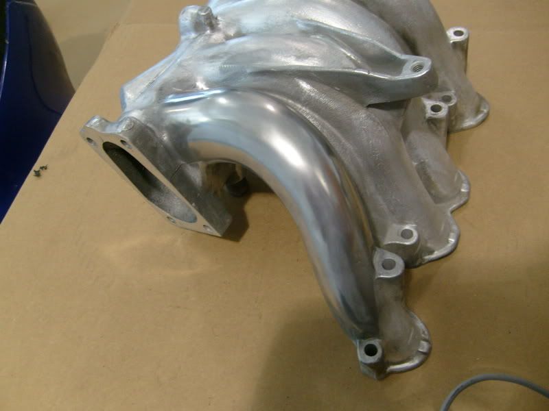

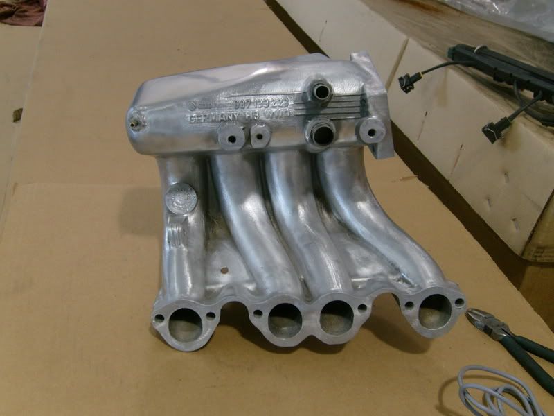

Polished manifold (i know you can hardly see it once it's installed, but whatever)
if anyone's interested i made some progress this weekend. I shipped off the carger to Bahn Brenner and got some OE parts in (not yet installed) which include full wheel bearing set, knock sensor and new clutch kit.

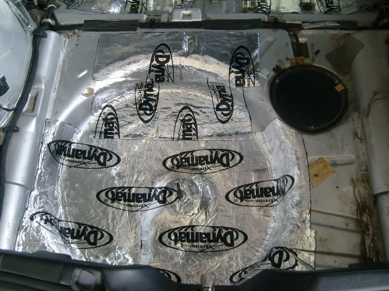

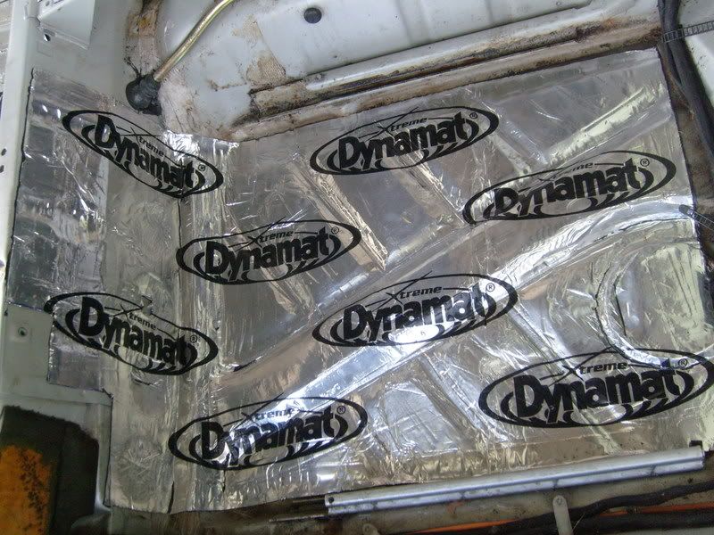

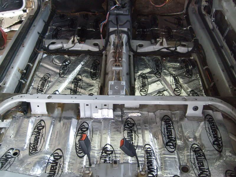

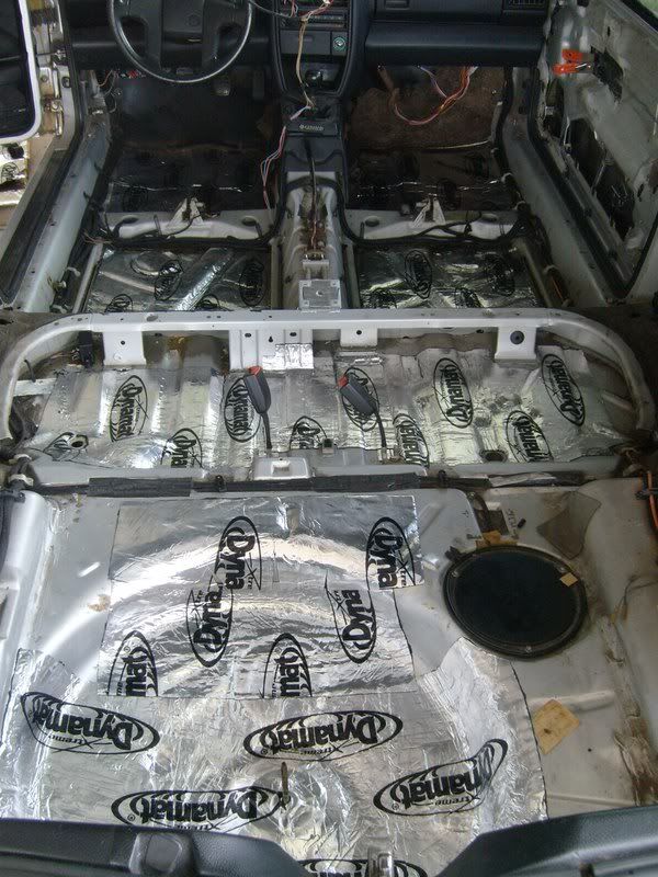

also this weekend i installed dynamat in the interior, check it out!
looking good mate, bet all the sound deadening wasnt cheap! lol
you getting everything put back oe i mean you getting the seats redone black or going for the showcar look? :)
still up in the air on that, as i haven't gotten a price yet :roll:
I have 3 options in mind
1. recover in stock black leather
2. Black leather with gray alcantara inserts
3. buy the recaro's a buddy of mine has in his garage collecting dust
Looks really good mate - the soundproofing should make a big difference. As for the seats - I have black leather with grey alcantara and can vouch for thembeing a) very comfy, b) not making you slide around on them when cornering and c) being warm in winter unlike the all leather ones. :clap:
thanks for the kind words. To answer the question of price, i actually found the Dynamat really cheap at ikesound.com it was $110 USD for 36sq ft and $45 for the door kit. The package only weighed 20lbs, so i don't consider that much weight to add for what it's gonna do. plus i look at it this way, stock flywheel weighs near 30lbs and i'm getting one that's only 8lbs, so i'm right back where i started 8)
I was VERY pleased with how much that one pack covered, but now after looking at it again i'm contemplating getting another pack and doing a true pro quality job. One of my main goals is to make this car feel just as fresh as any new car out today, yet keep the retro style.
I love the logic behind this! strip unnecessary weight to improve something else. Genius :cheers:
