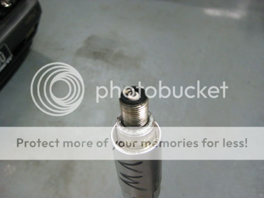

PaudieG60 0 Posted September 30, 2011 Bringing this back from the dead!! After reading the whole thing i have a quick question, My timing was set up according to autodata with a timing light so i presume its at 6deg btcd!? The car ran so much better after this so happy out. My question is that my engine has a small bit of work done so will it still be ok at 6deg? Reason i ask is in th2 300 miles sense the ignition timing was set ive developed a slight miss up tru the revs. Did a compression test sunday {125 across all4} and the plugs dont look good! All 4 look like this, Is the issue with my ingition timing? Quote Share this post Link to post Share on other sites
steveo29 0 Posted September 30, 2011 mainly mixture that effects the plugs ...they all go black on the threads other than that it just looks clean a tuner would try the car at 6 degs then try more until it pinks , you can do this if you know what to listen for , ideal set up is just before its pinking Quote Share this post Link to post Share on other sites
Supercharged 2 Posted September 30, 2011 7 to 8 degrees is safe but you must stick to good 98+ RON fuel - maybe worth marking the dizzy at 6 so you can go back to the base settings if required. Try to setup on a hot day if you can, take a ratchet spanner with you and back off if it pinks. Quote Share this post Link to post Share on other sites
