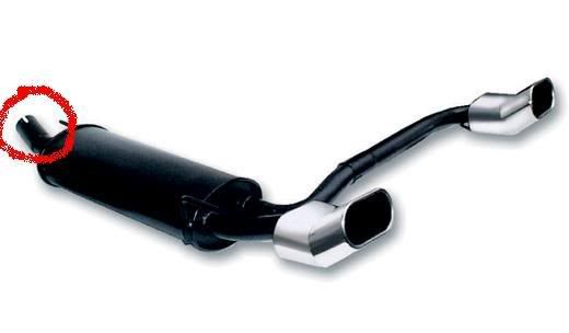

Valerian 0 Posted October 7, 2008 how are you passing the exhaust through the emergency wheel ?? The pipe will sit between the wheel well and the rear valance/apron. I'ts going to be a tight fit and i'm not even sure it's going to sit exactly were i planned. Might have to sit it lower, and if that's the case, i'll have to think about fitting a bigger rear apron :nuts: . The rear exhaust section i had made up by a French company called Ultra Tuning. It's the joint that's circled in red that is causing the problem because it isn't long enough to reach the existing mid section joint of my Scorpion system. Also need to move a couple of the hangers. So now i am having to wait for a mid section pipe to be made up. Quote Share this post Link to post Share on other sites
