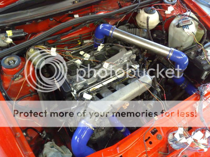

barryarginnraddo 0 Posted September 12, 2008 photo shows boost runs, and some of the wiring in proress Quote Share this post Link to post Share on other sites
