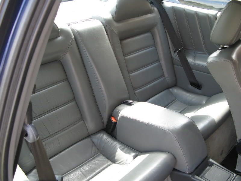

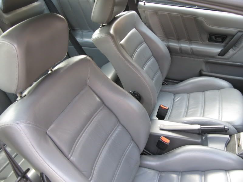

I used Meguiars aloa cleaner and leather cream on my platinum leather I bought a few weeks back, and that was heaving filthy! I also used the Armour all leather wipes which are surprisingly good and removed loads of grime from the seats you couldnt see, I dont think the interior could have been cleaned properly for a decade!
It came out absolutely spanking, mind it took 3 evenings of graft and a bottle of aloa and a tube of Armour all wipes, having looked at a few other sets of grey leathers this one is definately in very nice condition in comparison, and its lovely and soft too, maybe being covered in grime has protected it in some way over the tears :shrug: looks new again now :grin:
