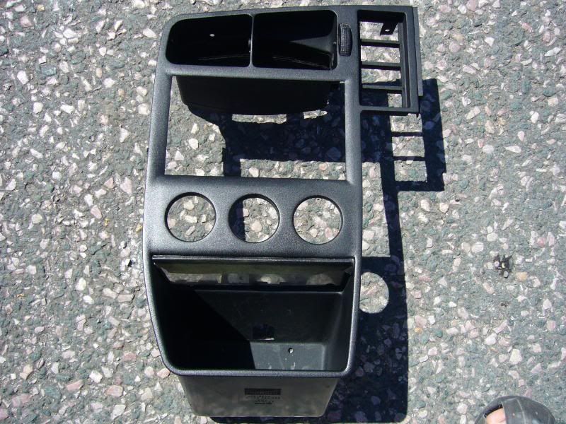

with the centre console out of the car i set on cosmetically changing it :norty: the plastic bars had to be removed and the plastic around the top of the console jut below the heater vents also had to be removed....
this was quite time consuming as i had virtually no tools (as i left them at work) and i didnt want to scratch any plastic that you can see once this is finished....

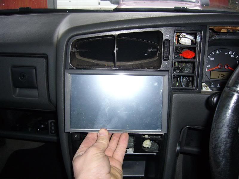

with the bits cut out i decided on a dummy run, ok thre screen and newly located heater controls are not fixed in but just rested in position for the photo's ,they kinda almost fit!! :clap:
as you can see needs a lot more work to get it looking right but this is a good start i feel....
the next thing to over come is the screen surround is a different colour plastic to the rest of the dash....
now should i bond the surround into position with araldite etc and use filler to blend into the centre console so it looks almost factory.... then texture paint it black to match the other plastics...
or do as above but also incorporate the heater controls too, so yea i would looose the fan numbers and the diagrams around the controls but it would look as one unit i guess.....

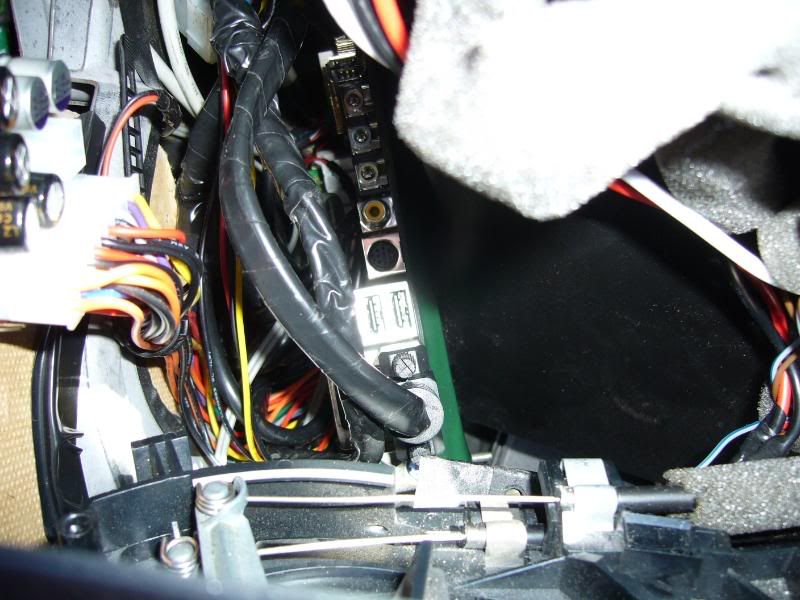

the only prob i can see with the above is putting the heater controls back in???? the steel wires how the hell would i connect them back up???? :shrug:

Or get longer heater control cables from a different car and cut them to length so you can move the controls.
remove the surround from the screen, use fibreglass or plastic filler to mould into the heater control panel and fill the gaps at the sides and get it painted the same colour as the rest of the dash.

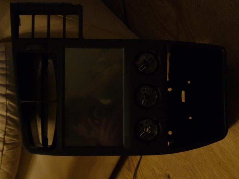

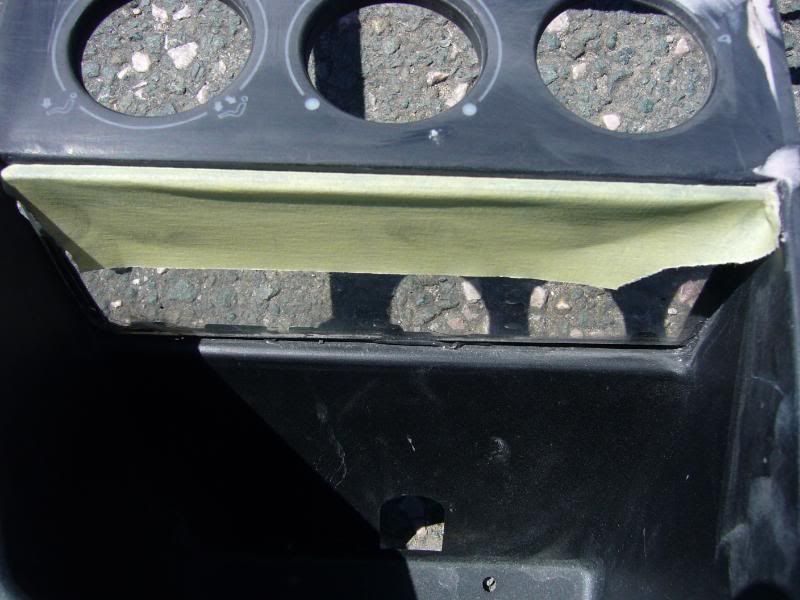

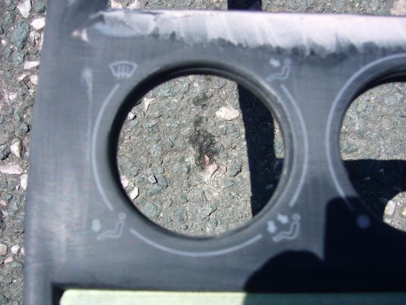

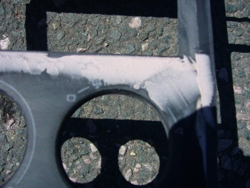

as you can see in the pics it looks a bit of a nightmare....had to bond the screen surround in place then fill it to get it to look as though it fits...same with the heater controls....yes im going to loose the illumination....for the time being....
the frame is all sanded down please note im no good at filling sansing at all............. wish i was as this job would turn out so much nicer .......

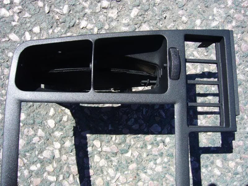

anyway pics below are now of the centre console filled primed and texture painted to match the other black plastics....
looks fairly good but need some more filler work really , it does however look better in the flesh and when it is fitted it should look fine....

th heater control clips in to the facia panel, then at the back of the heater controls is a screw point which luckily is only 3-4mm away from the original ashtray fixing point so it will be fixed securly in there... i will post pics up when i have achieved this

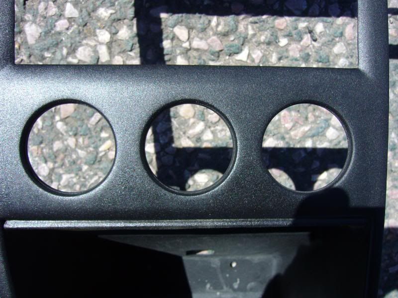

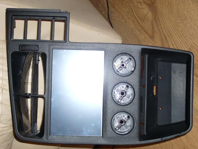

with all the lumps and bumps you could see in the last few pics i decided it wasnt good enough, i had to strip the dash down again and well not start again but certinly get the filler and sand paper out...

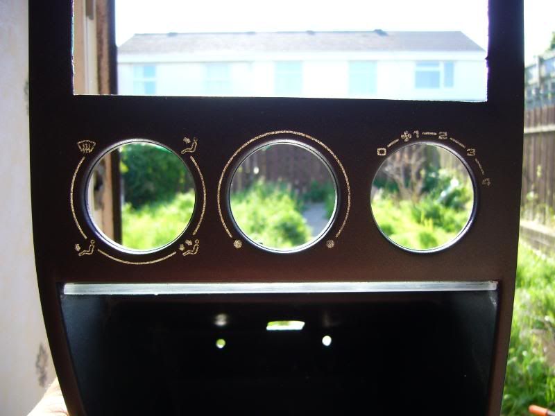

in sanding it right back it luckily revealed the heater controls,
very light dust with texture paint and looks like we're good to go!

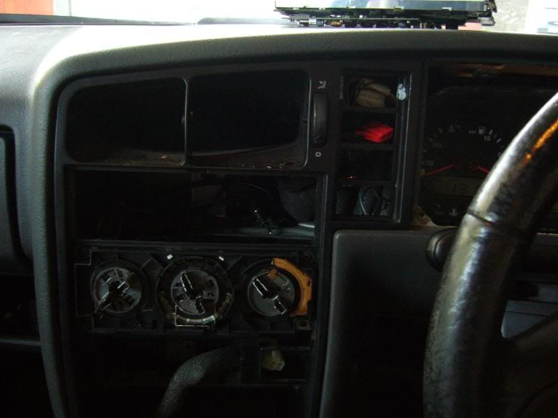

dash all ripped out looks kinda daunting , its all good though fixed the dreaded heater sticking problem while it was all out

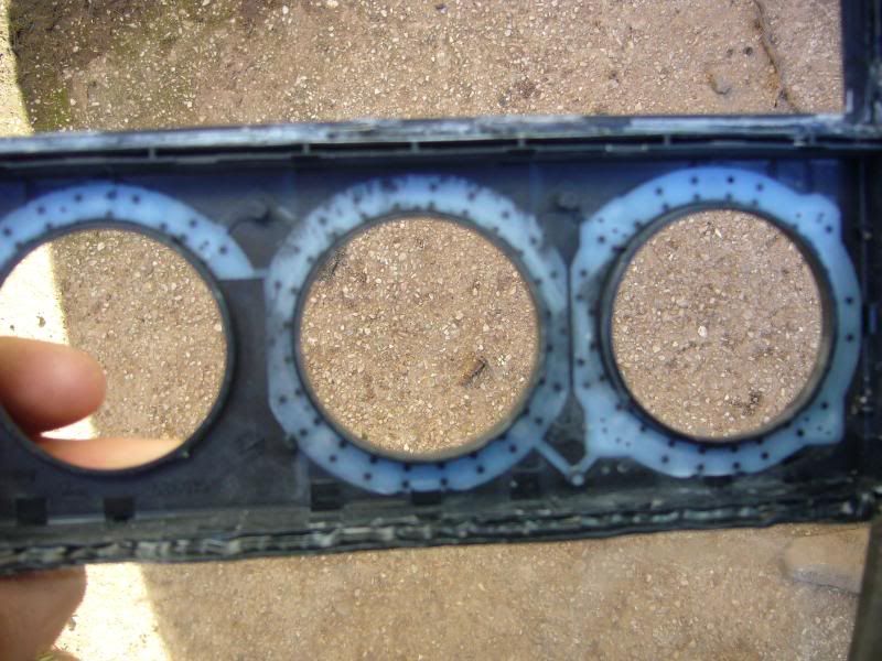

made sure all the rings were clear of any over spray need them as good as poss for the light im going to stick in behind them.

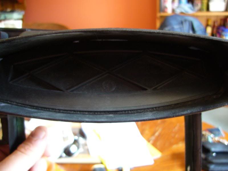

pic of the screen surround from the back

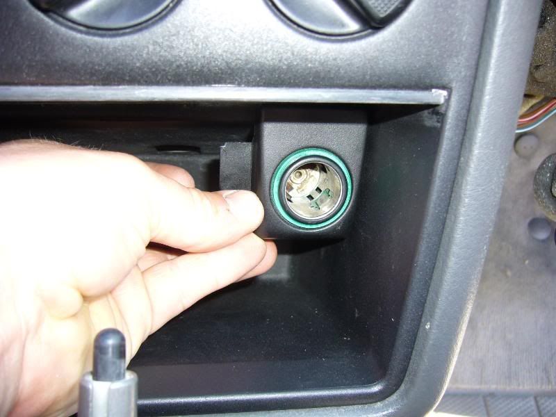

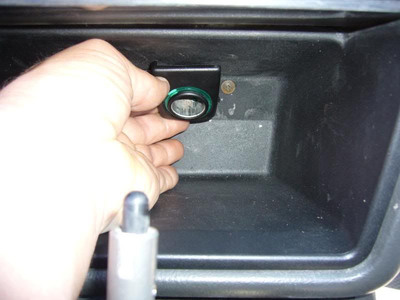

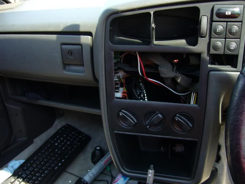

dummy run to see what it looks like and where the hell was i going to stick the 12v socket??

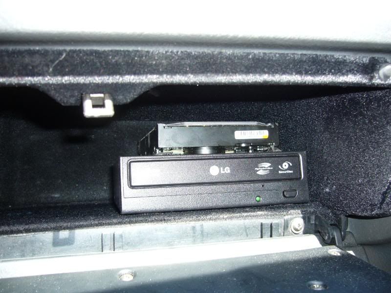

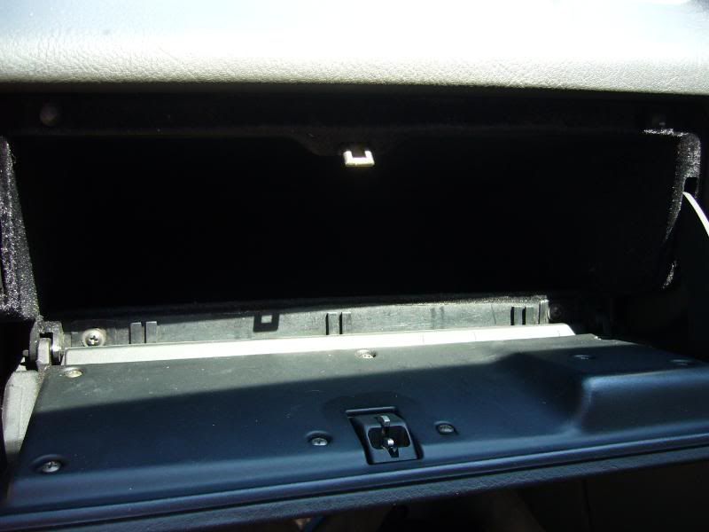

get the glove box out and cut the back out of it enough to pass through hard drive and cd drive cables through
should look like this

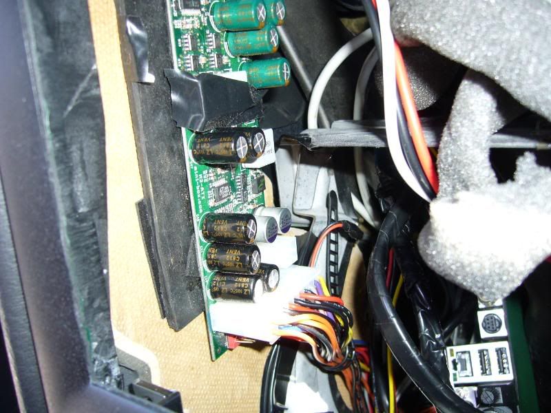

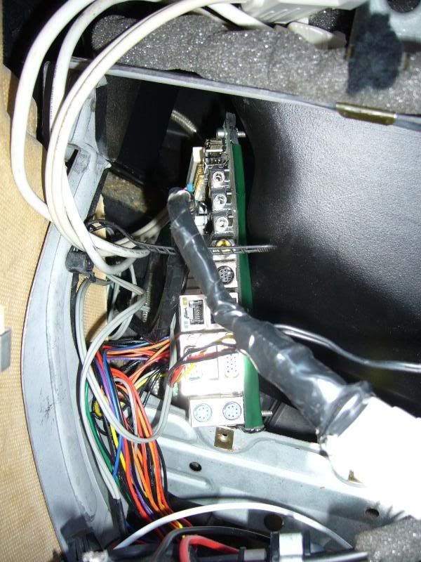

mother board sits in the back of the centre console on the side of the heater matrix housing, easy acess to add /work on by taking out the passenger side shelf
power supply sits up front on the side of the dash itself
very snug wiring is a bit shite but then its not finished yet!

now the paint is dry

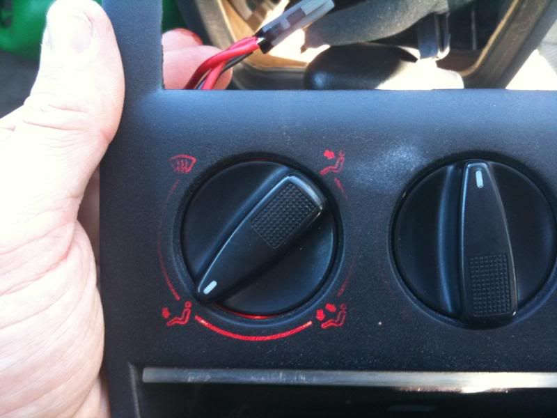

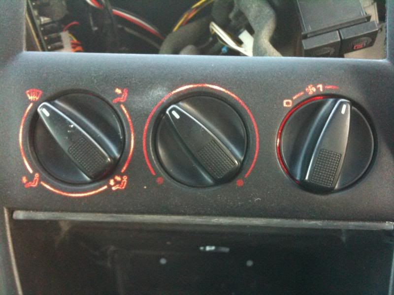

hold up to the light and you can see the heater controls!! yippe!!

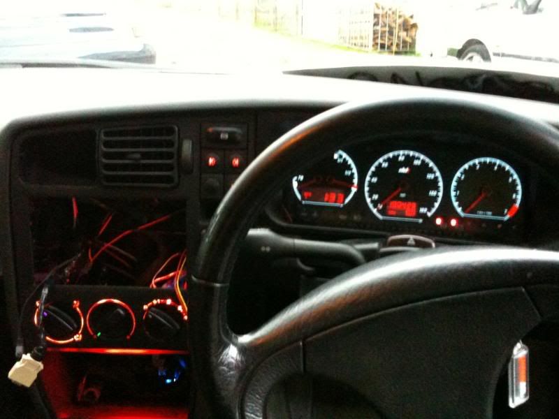

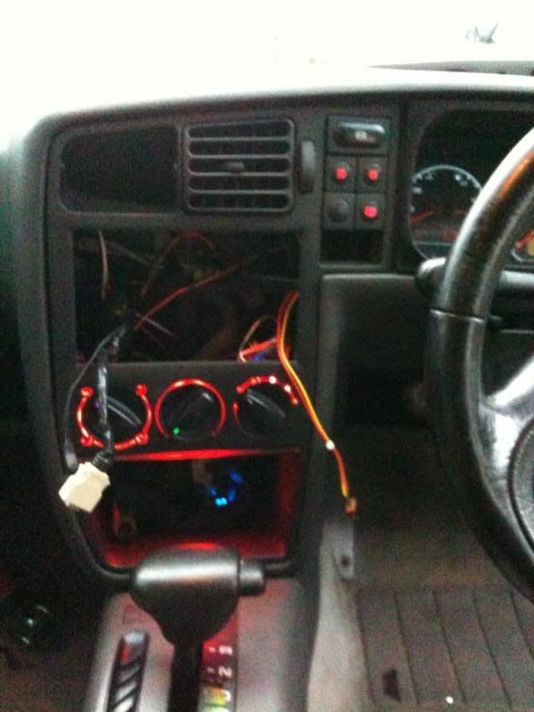

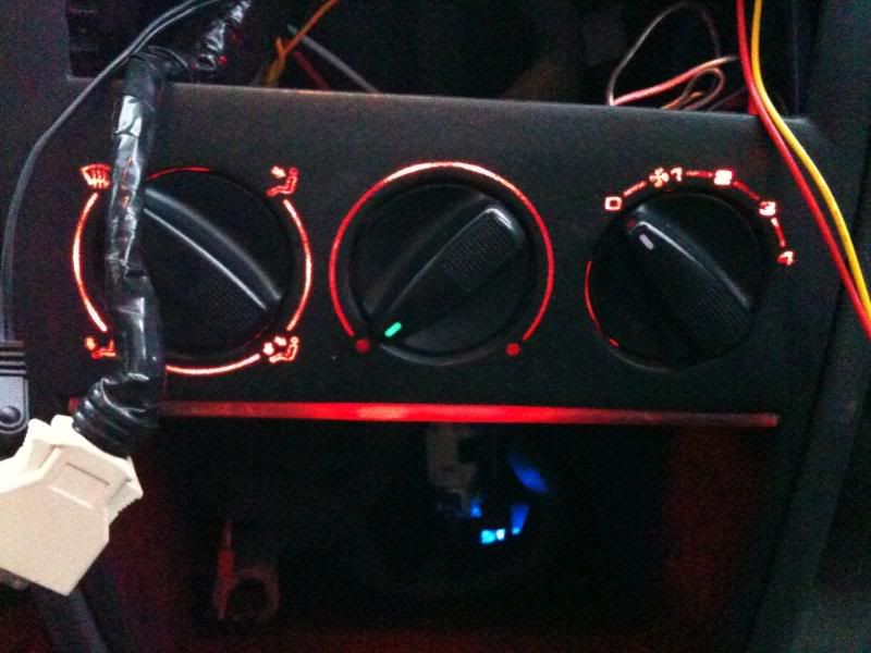

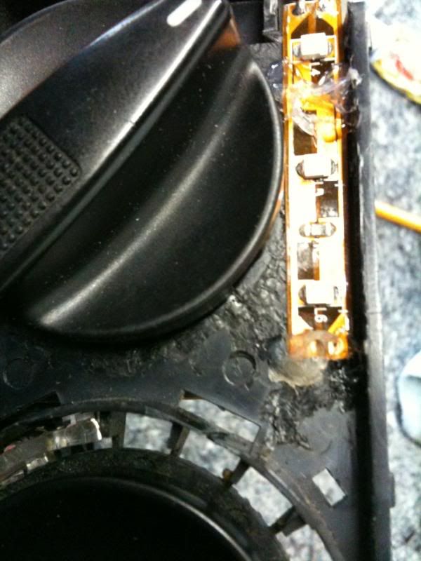

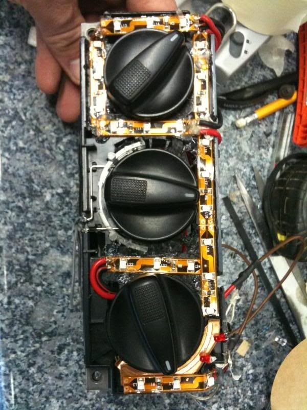

once the unit is rebuilt the next problem was the lighting,

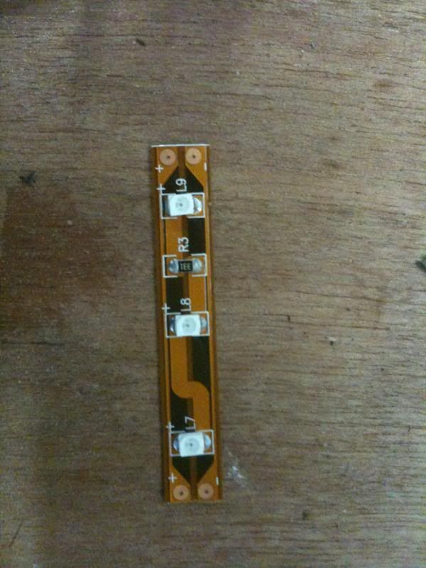

chose the red led strips more of a modern look and the only ones bright enough to shine through..

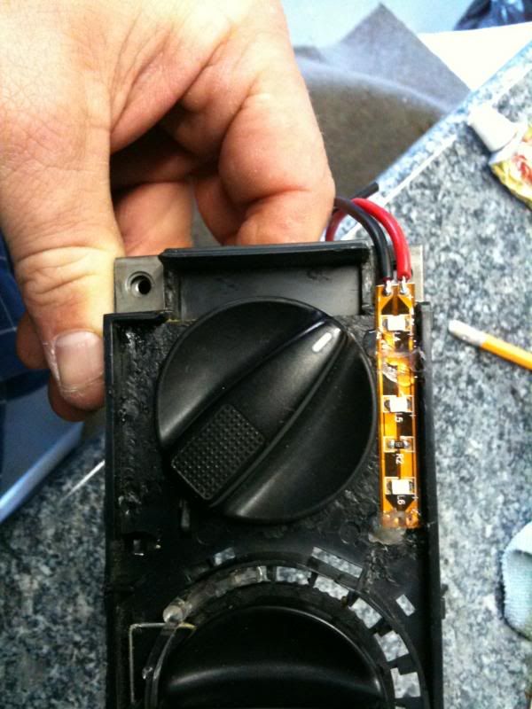

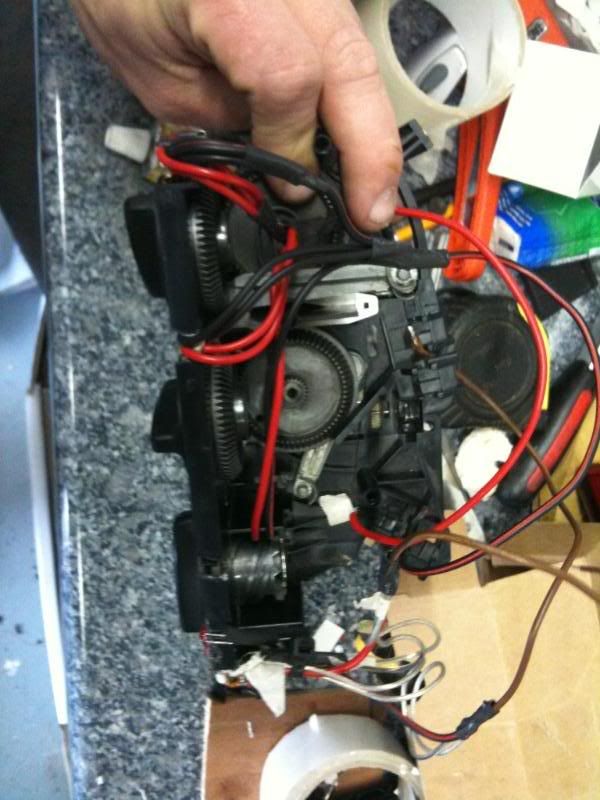

had to cut out melt all of the webbing on the back of the heater control panel, did this to get the leds to sit as far back from the heater face plate as possible , so i could attempt to get a better throw of light through the icons.
a bit untidy looking but you aint ever gonna see it!! so not massivly important

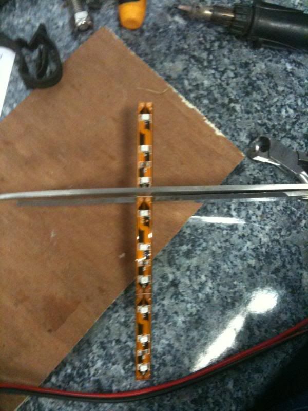

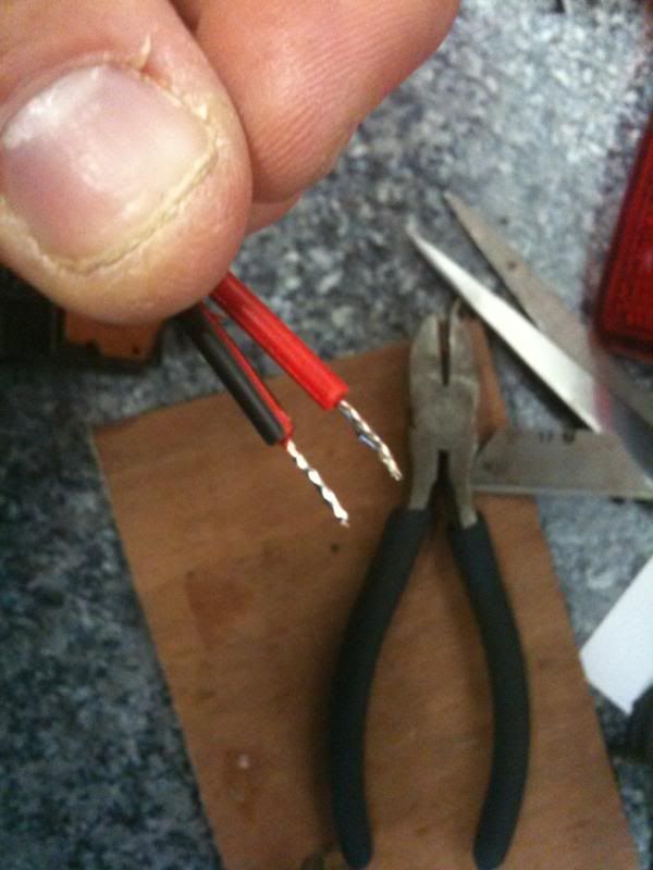

a few issues with the lighting i couldnt get numbers 2 and 3 to light up , another trip to maplins and picked up 1 more led strip had to make it fit pain the ass that was but got there eventually and the result is below.....

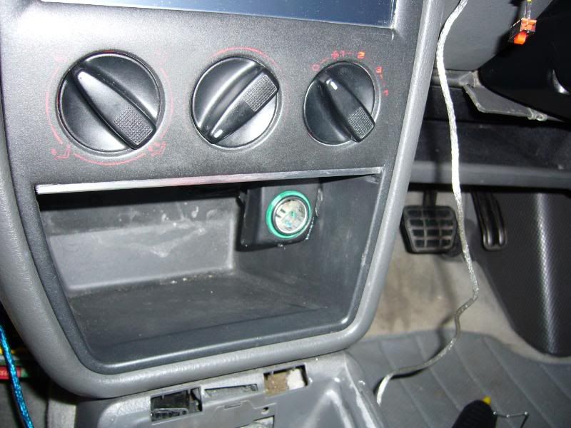

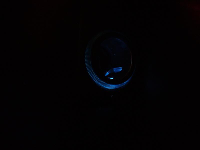

ciggerette lighter location decided
and light up

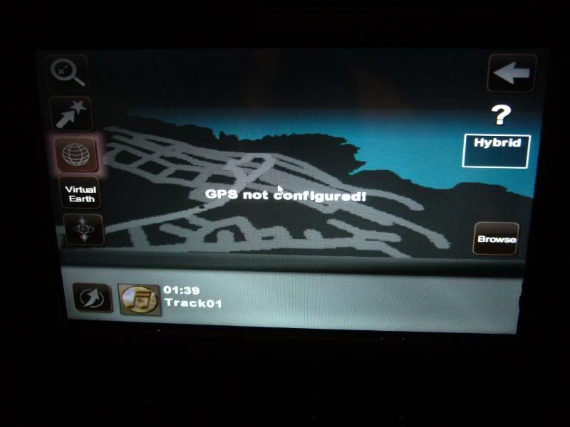

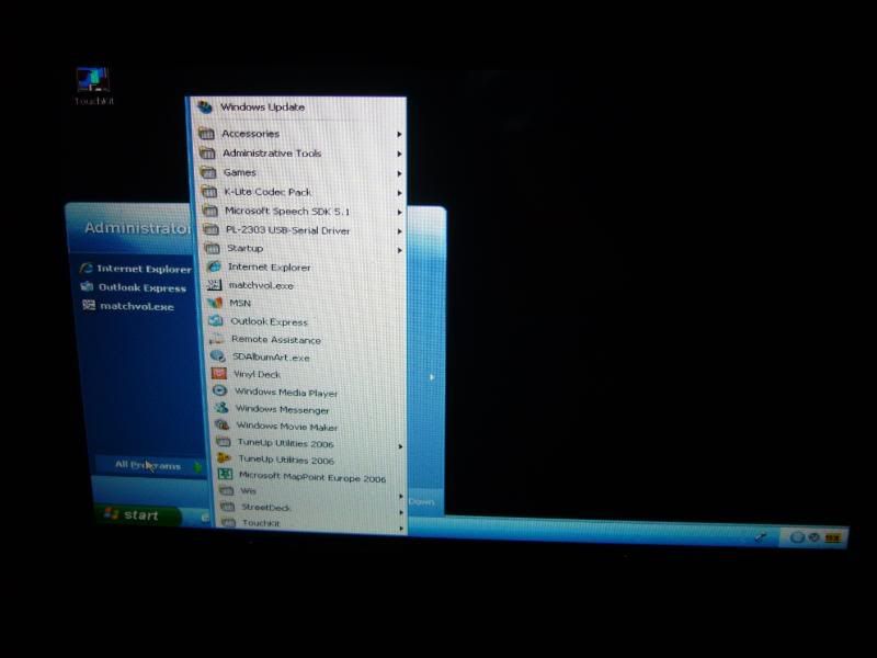

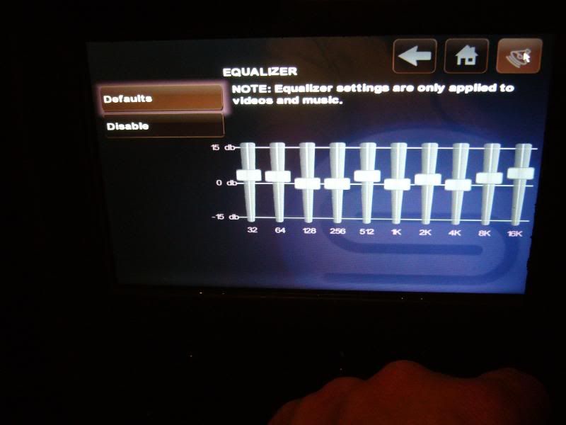

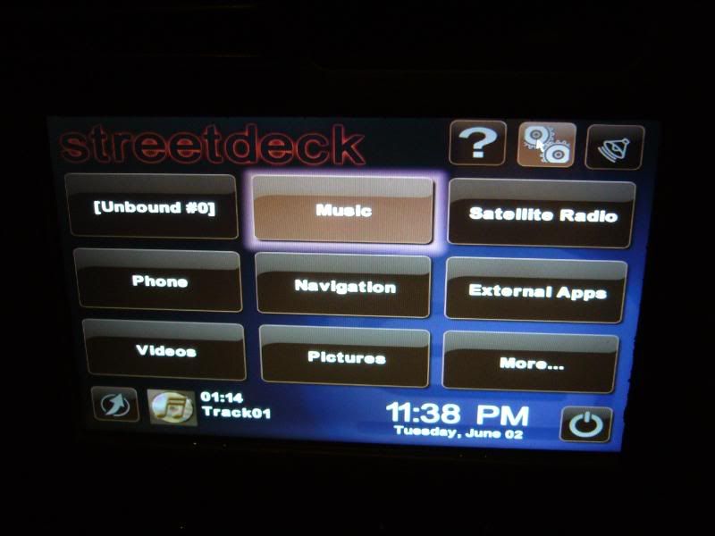

the red strip across the bottom is now blue no pics though oh and here are acouple of screen shots
will update as soon as i have finally ironed out a few niggles with the installation of
blue tooth
wifi being a pain
and vag com , also with this i have got the full workshoop manual downloaded to the hard drive with all part number etc for the car so i can now run diagnostics and get the part numbers i need for repair.....
