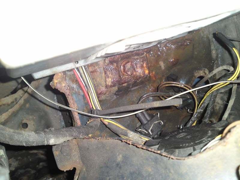

After washing the 'rado yesterday I popped the bonnet and noticed the area between the battery and the headlights had a pool of water in it. I'm a total n00b to working on cars but I know enough to know its bad! Is this a common problem? or is it just due to me hosing down the front of the car and it won't happen normally or what?
I've got a pic of the water but it doesn't really show, it was about 0.5mm deep?
That'll dry out. But, it does look pretty rusty. would be well worthwhile removing the battery, cleaning up the battery tray and repainting it before it rots out.

hmmm strange
i'd say the water is there from you washing the car.
if it were me i'd probably take battery out, maybe the lights and treat the rust, it will only be surface rust i reckon.
i did all my battery tray area with black hammerite as it never gets seen, its just knowing when to stop thats the problem, you'll be painting the whole bay before you know it :D

Cool, The cars not on the road yet so I'll take the battery out and give the tray some attention. Will a sand, rust treatment and cheeky spray do? Suppose it is probably just water coming in around the headlights from the hose.
Another quick question, I've got a Clifford Concept 300. Assuming taking out the battery isn't going to have it going mental or anything? Yet again, a noob with aftermarket alarms :wink:

I can't see anything missing in that pic either?
yeah that'll be fine, just good to stop the rust and re protect the area.
i think disconnecting your battery will affect the alarm, i have to reset mine each time, its not a clifford though, so probably best to check some kind of manual
