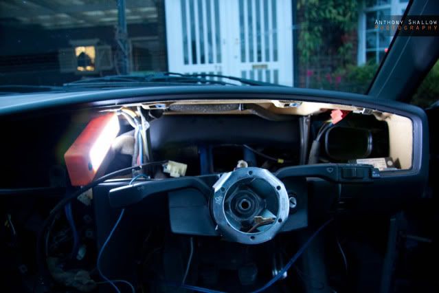

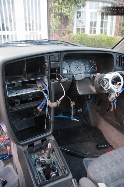

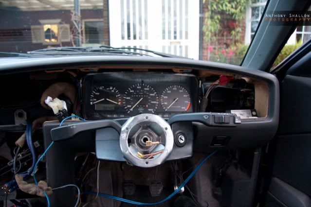

Heater Matrix time, a job that I was not looking forward to. However lack of heat and windscreen dimisting meant I had to get it done. So last night I started - and I must admit i was dreading it. However so far its not been as hard as I though. I managed to get the dash out in about an hour and 20 mins.

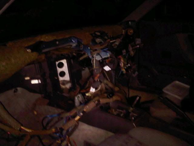

As the night went on I took some more photos but cant get them off the camera at the moment so the Blackberry will do for now.
I managed to get it all out with out any issues. The light went very quickly though so I stopped when I got to the point of taking the matrix out. Will do that tonight, and then re-plumb it all back in.

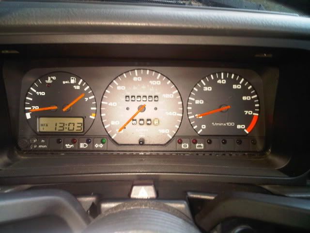

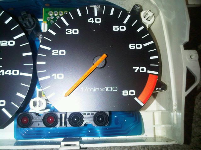

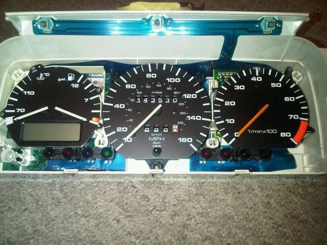

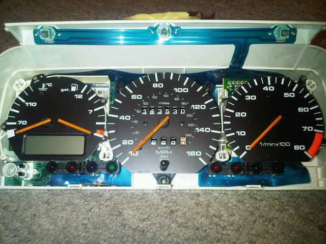

While the clocks were out I though I would do what I have been wanting to do for ages and color the needles in. I have a set of VDO Gauges that have orange needles so I did the same with my dash ones. I think they look pretty sweet!
They all need one more coat and then I think we are on to a winner!

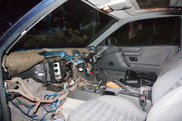

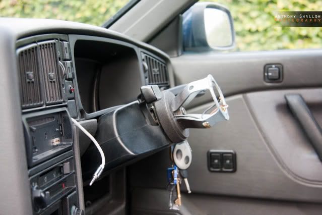

Right then, so the heater matrix replacement went something like this..
Dash ready to come out
Dash out...

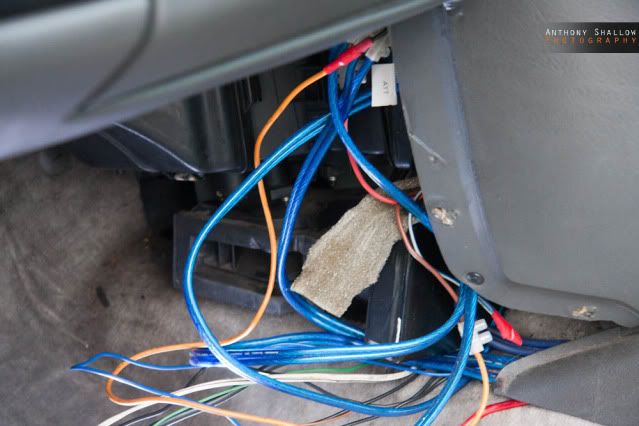

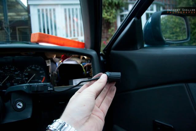

While I was doing this I came across a few things that I dont know what they do...
Firstly,

Whats this? Found it behind the dash.

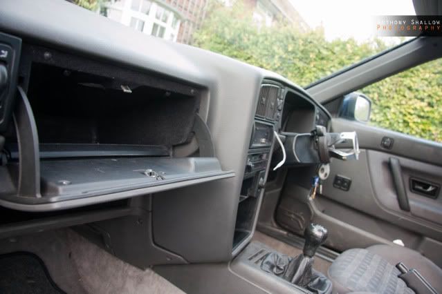

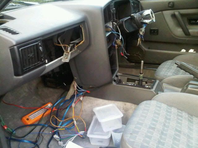

New Matrix is back in, all the dash is in. The Glove box - OMG what a Bi*ch to re fit. Unnecessarily difficult... anyway I got a bit carried away and forgot to take many photos of it going back in.
The old matrix seems to have been leaking so I'm guessing that was the issue. I'll know for sure when I reconnect the pipes back up this afternoon and refill it with coolant.
While the dash was out I managed to find the wires I need to wire my gauge loom up. I've run the wires through to the engine bay for the sensor and the battery.
Here is a picture of the clocks and gauges.

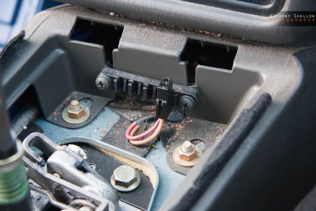

I did find this behind the dash though. Its not live or anything. Where does it go?
Ah brilliant!
What can I plug it on to? and what sort of readings can I get from it etc?
With vag-com or similar you can get all the sensor readings and error codes.
Glove box light wires are thin and brown ( one with White tracer)
Red and brown are heater illumination, ashtray illumination dag lighter illumination
Fat chunky White block for dag lighter White long chunkyish block heater controls
Dash speakers one side Bly and one side red both with White tracers
