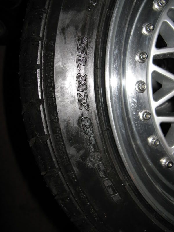

corradog60stage4 0 Posted January 7, 2009 These wheels are atleast 16 years old so I sent out the cores to the wheel refinishers to have straightened and painted. Now to piece them up Quote Share this post Link to post Share on other sites

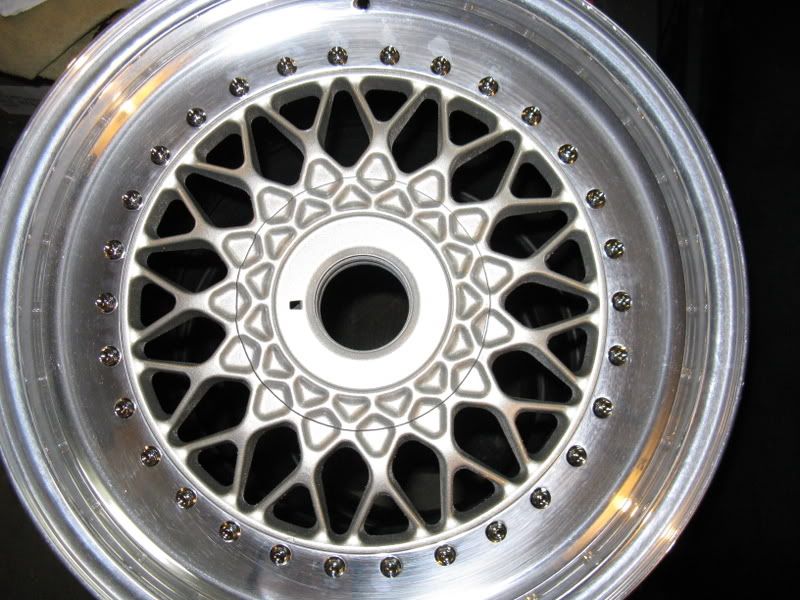

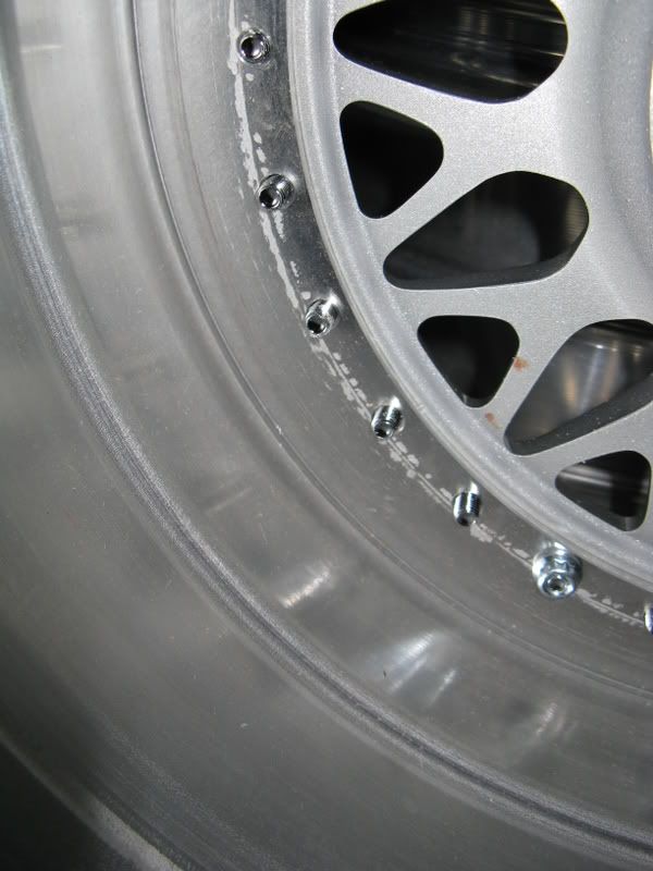

corradog60stage4 0 Posted January 7, 2009 Shame you havent got any spares in 5/100 :( no i don't and i have to drill a RS001 to be 5X100. before back front countersink My RS001 are finally assembled and test fitting it on the rado for any clearance issues. not going to rub the fenders This is not for the faint at heart :notworthy: Quote Share this post Link to post Share on other sites
Leonard 0 Posted January 7, 2009 LOL indeed Shouldnt you weld the original holes though before redrilling them :scratch: Quote Share this post Link to post Share on other sites
waynos 0 Posted January 7, 2009 I think seeing as you have so many wheels you should donate a set to me! Not like you would miss them :D Quote Share this post Link to post Share on other sites
The_Dude 0 Posted January 8, 2009 Likey. :D No likey! That just looks wrong, plus won't it make the wheel unbalanced? Quote Share this post Link to post Share on other sites
bcstudent 0 Posted January 8, 2009 Nice wheels but, yeah, that redrilling job is rough. Quote Share this post Link to post Share on other sites
jamin 0 Posted January 8, 2009 What are the wheel sizes? I trust you will be selling some of these at some point? Offsets look perfect!!! Wouldn't it be better to redrill your hubs (Zak has done his) rather than (IMO ruin) the wheels? Quote Share this post Link to post Share on other sites
BigTartanJudge 0 Posted January 15, 2009 Nice wheels, but I am sorry, there is NO WAY i would be running those wheels on my rado after just redrilling holes like that. The new bolt holes you have created will be much weaker than the originl as they are not complete holes. It would have far better and safer to, as mentioned previously, weld up the existing holes, then redrill new ones. Quote Share this post Link to post Share on other sites
corradog60stage4 0 Posted January 15, 2009 Nice wheels, but I am sorry, there is NO WAY i would be running those wheels on my rado after just redrilling holes like that. The new bolt holes you have created will be much weaker than the originl as they are not complete holes. It would have far better and safer to, as mentioned previously, weld up the existing holes, then redrill new ones. For all you skeptical people out there. VW wheels are hubcentric meaning that the wheel uses the hub to take the load and not bolt centric wheels which relies on the bolts to take the load. The centerbore on the bbs wheels is for VW so the hub to wheel face is perfect. Also everyone should know that BBS RS centers are forged aluminum and not like the weaker cast stuff. FYI there is another wheel company SSR that makes wheels with the identical universal bolt pattern for 4X100 and 5X100. So these are structurally safe. Quote Share this post Link to post Share on other sites
