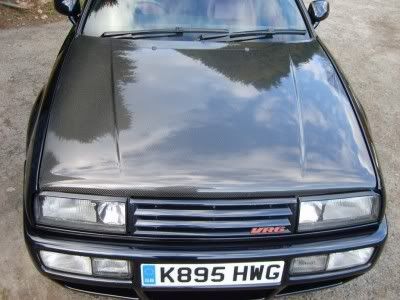

KADVR6 0 Posted January 31, 2009 i had the mk4 washers when i had my carbon bonnet, heres the only pic i have Quote Share this post Link to post Share on other sites
JMC 0 Posted January 31, 2009 i had the mk4 washers when i had my carbon bonnet, heres the only pic i have On yours mate, they look as though they are mounted on the top surface though, or is it a trick of the light? With mine they are under the trailing edge so you can't see them from the top. Quote Share this post Link to post Share on other sites
KADVR6 0 Posted January 31, 2009 yeh they were mounted on the top of the bonnet, and get yourself ready for the saxo/nova chavs coming up to you and saying "thats a sick bonnet" that really really annoyed me after about the 10th time :mad2: Quote Share this post Link to post Share on other sites
