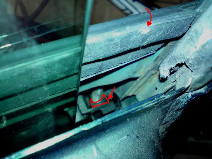

i used the same bit of metal rod that i used to undo bonnet when the cable broke, guided it between window and door, found the latch to hook onto and managed to pull it up whilst the key was in the lock

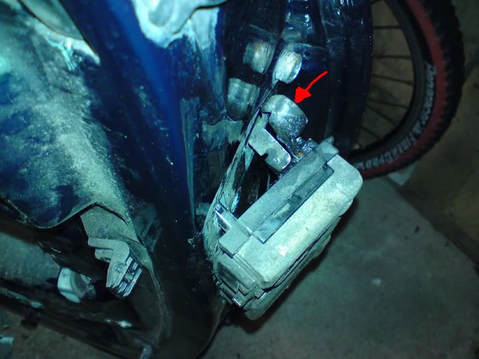

here's what i've discovered
the little arm on the lock/latch part wasn't returning up, once i'd locked car it was stuck down.
i think this is whats causing my problem, as i can pull that up and door opens with the handle, i've sprayed it with wd40 and it is now springy again, but i've yet to test the locking again as its still hanging out of door.
you can get to this lever with the door stuck shut and the door card on, you just need to get a metal rod with a hooked end, to reach in and pull lever up
hard to see
DSC01479.jpg but the lever is under the white thing
i'm going to take both locks and both handles out and strip them down, clean them up etc and fit the door handle repair kits (just while i'm there)
