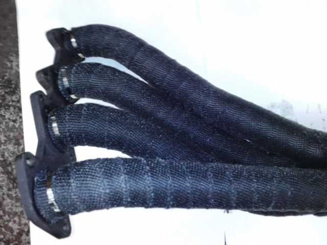

Boydy 0 Posted February 26, 2009 Hi guys, just brought a new 6-3-2-1 exhaust manifold for my car, i want to heat wrap it and have no idea on how much to buy in length and width, whats the best type and how many ties to buy also. If anybody has done this or there is another post up about it would be a great help! Any other info or tips also Thanks alot! Alan Quote Share this post Link to post Share on other sites
samthegram 10 Posted February 26, 2009 i wrapped a 4 to 1 manifold and used nearly 20 metres of 50mm wrap. you should get at least 40m to be on the safe side. i know that sounds a lot but i thought i would have plenty left over but used it all and could have done with another metre to be honest.If you soak the wrap in water first it goes on easier and then shrinks tight when it gets hot. By the way it is the most time consuming arkward job i have ever done :censored: Not wanting to put you off like :lol: Quote Share this post Link to post Share on other sites
Boydy 0 Posted February 26, 2009 Cheers,sent a message to a couple of other people and one came back saying I needed 38ft,and you said forty so so far 40 sounds around the right length.I can imagine its a pig of a job,but has to be done so there's no choice in the matter really!Ive always been the type to just get on and do something,no matter what it is,to get the end result I want/get to where I wanna go.No probs :D And im sure one of my mates will help us out with some kind of bribe! :lol: Quote Share this post Link to post Share on other sites

sparks 0 Posted February 27, 2009 please baring in mind that last time i wrapped a manifold i itched like crazy for 2 days as the fibreglass got into my pores its bad stuff unless they have changed it recently the spray on option prev mention then starts to look good stu.... Quote Share this post Link to post Share on other sites
plateletboy 0 Posted February 27, 2009 how does something that is only 3 um thick have such an amazingly low thermal conductivity..?!? does it just block heat transfer by radiation - although it doesn't look very shiny..?!? can i spray my house with it........ :lol: weird........ pb Quote Share this post Link to post Share on other sites
VEEDUBBED 0 Posted February 27, 2009 I've wrapped two 3inch turbo downpipes with that wrap and all i can say is it's garbage,the stuff lasts a couple of months then turns to dust. Sparky's right,if you use the wrap do wear laytex gloves as the itching will drive you apeshit,wear a dust mask aswell. The 'Grafite impregnated' wrap is also bollox,it looses it's colour not long after you install it and smokes badly. I bought the latest 'copper impregnated' affair but i'm not gonna fit it,30 squids wasted. The downpipe also started rusting soon after installing even AFTER i'd applied two coats of high temp. paint as a protective primer :mad2: Maybe the protective spray the company suggests to use would prolong the life of the wrap,who knows?,all i know is that the bloody stuff can't be posted abroad... Remember to use a water spray bottle to wet the wrap whilst installing as it helps dampen down the dust. Quote Share this post Link to post Share on other sites
