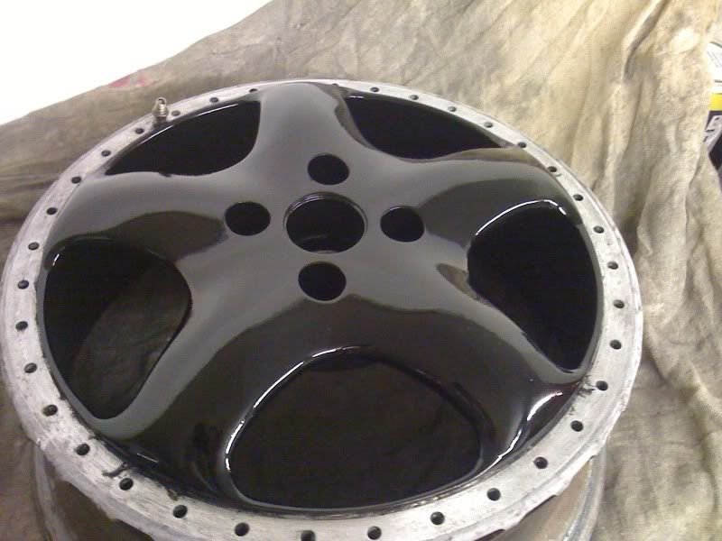

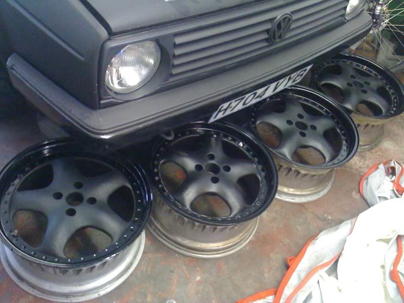

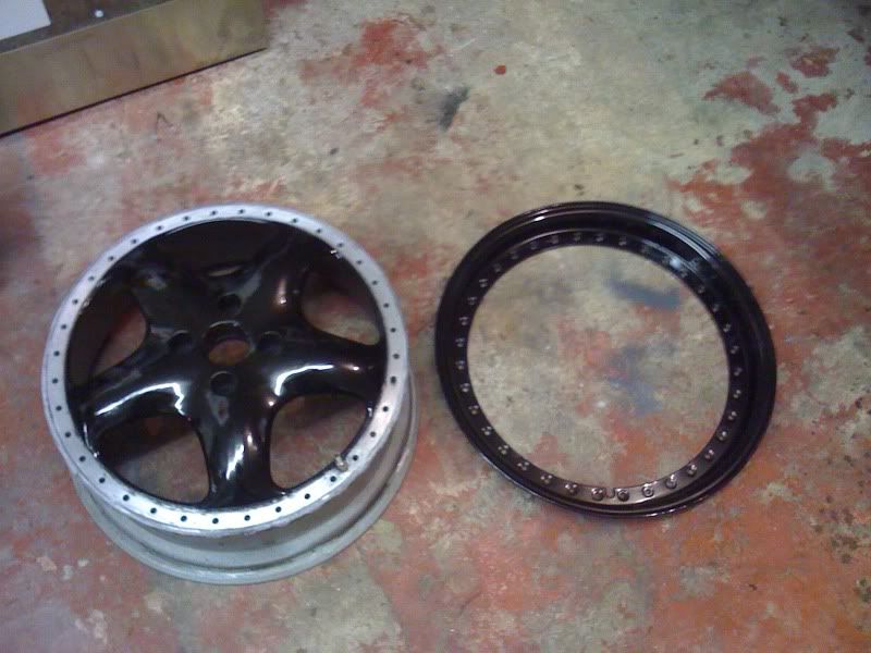

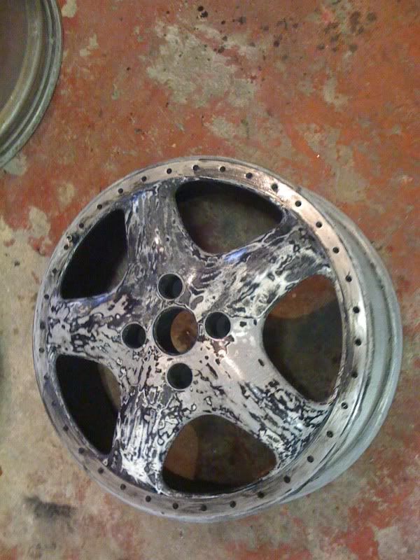

Been refurbing the Artec splits that I got. First of all stripped the crackle paint and rubbed the spokes down.
Then gave it a nice coating of gloss black.
I gave the gloss black rims a few new coats of paint as well.

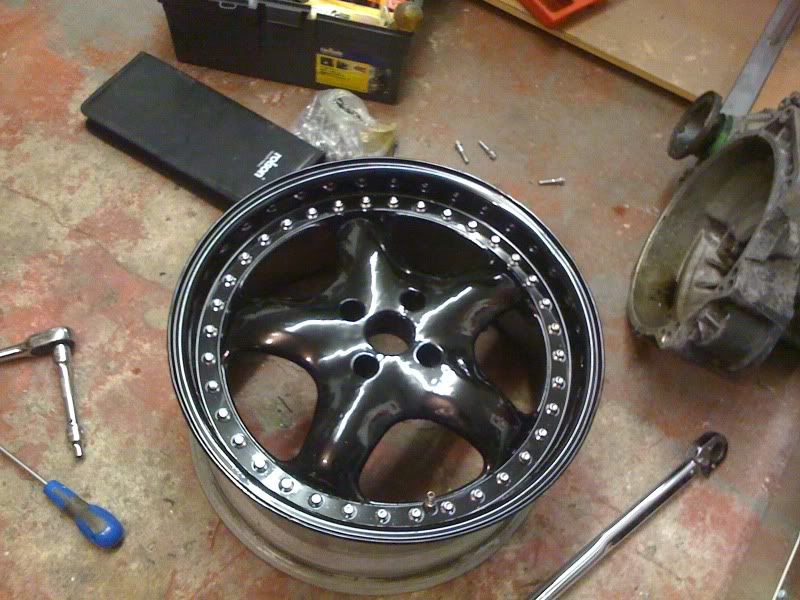

Then with the help of my bro we built them up. Was nerve racking as it was the first time I've ever done this and they are fairly old wheels so we could run into problems, which we did! But luckly my brother was on hand to sort them out.

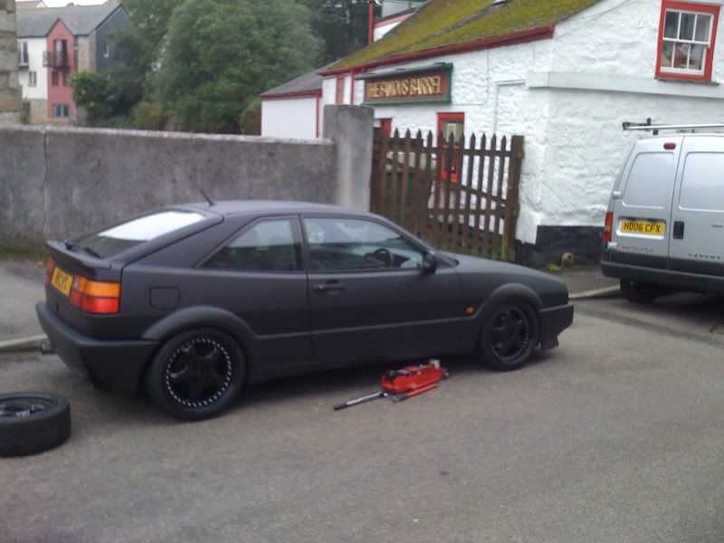

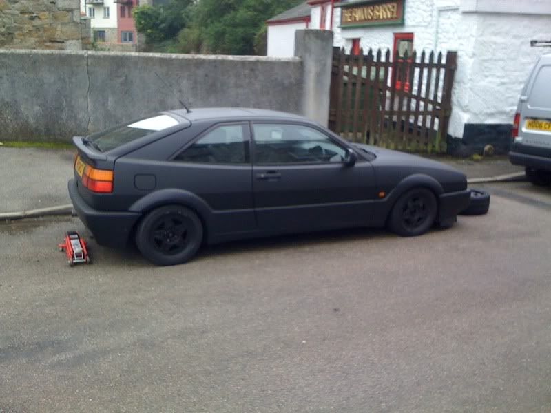

Unfortunately, there are a couple of bolts missing which I'm trying to source and the tyre company sent out one wrong tyre, so I haven't been able to do all 4 wheels yet. But I've got two made up with tyres on so I trial fitted them at the weekend.
Pics are a bit poor as they are from my phone. Old wheels.

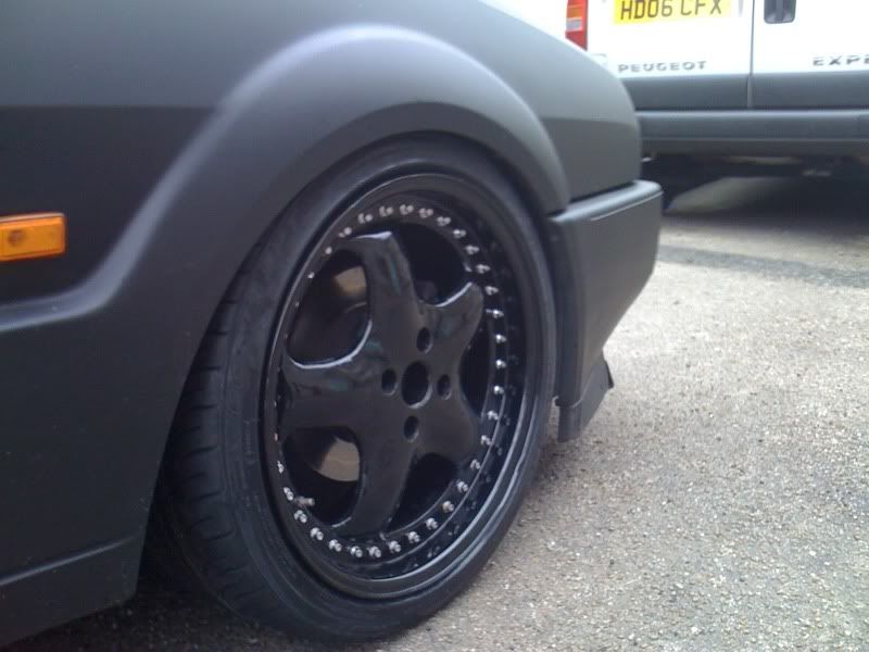

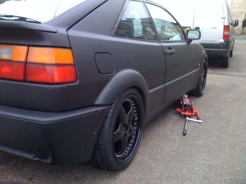

New wheels fitted.
Unfortunately the wheels are catching on the coilovers slightly front and rear. I picked up 3mm shims but they are still catching so I'm going to try 5mm to see if that works, otherwise I'll have to go bigger. The arches probably need a light roll (hammering in my case) just to make sure the tyre doesn't catch, but overall I think they look awesome on the car.
