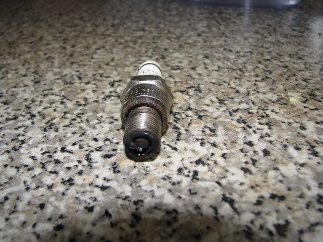

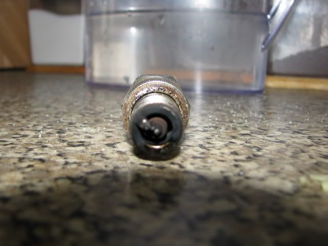

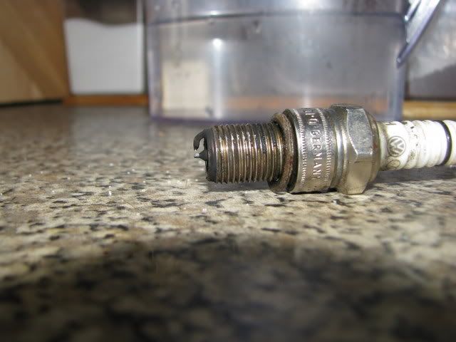

Johnkerry 0 Posted May 19, 2009 dirtytorque - Here are the pics of the spark plugs best pics i could get. Also i done a compression test today and it came up 147psi, 145psi,150psi and 150psi so no problem with the compression. I think might have to try another ECU ? Quote Share this post Link to post Share on other sites
dirtytorque 0 Posted May 19, 2009 was that from a fully warm engine?Had you been for a drive? If so you don't seem to be running lean anyway... Opposite infact. 150 psi.. not brill but in spec. When the mechanic he set the timing did he have the blue temp sender disconnected ? Did he follow the digifant procedure that was outlined earlier? Quote Share this post Link to post Share on other sites
Johnkerry 0 Posted May 19, 2009 NUTS Sorry i forgot you wanted pics of plugs just after id been for a drive , its properly going to be awhile until i can get pics after a drive as car is off the road due to the split pipe ive got to order samcos as soon as i get paid. Yes the correct procedure was followed when doing the timing. Quote Share this post Link to post Share on other sites
Supercharged 2 Posted May 19, 2009 150 is a bit high - should be more like 130PSI but they are the same across the board so probably jut the (in)accuracy of the gauge... did you have the throttle open and engine up to temp? I love the way VW's are so consistent... the say a difference 3 bar (nearly 45PSI!!!) is permissible but if I saw 20PSI I'd start thinking about a rebiuld! I wouldn't worry about the engine itself but it's running rich - I'd clean those plugs too! Quote Share this post Link to post Share on other sites
