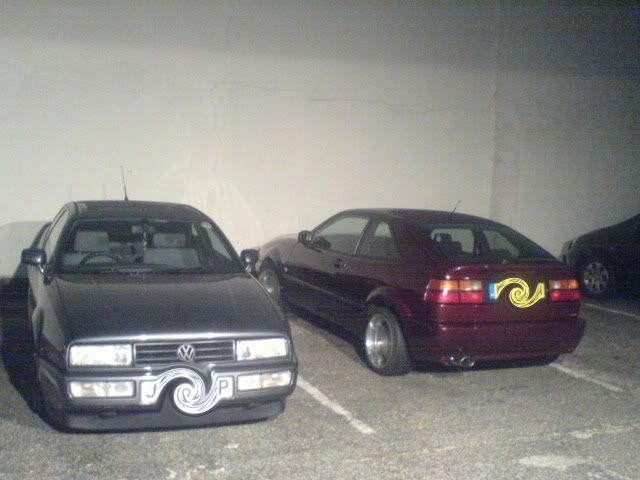

Had them on my 2.0 16v, you'll need to roll the rears otherwise you'll shread the tyres, but the fronts should be fine! :)
