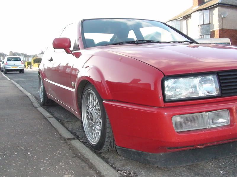

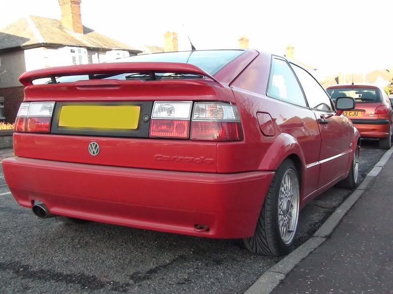

After much deliberation I reckon the only way to get more rubber on the road/track and keep my ride height is too sneak under the arches an extra 1/2" of wheel. I am running 15x7 ET30 wheels and want to go wider but without touching the arches, no pulling wanted right now.
The arches are rolled and the car is low, very low. To get the wheels under the arch I can allow about 8mm so I have concluded that an extra 0.5" wider on the wheel and a larger offset by 5mm will bring the wheel out by 7.5mm.
Can anybody let me know if any, all or some of that makes sense and has anybody have any suggestions for wheels that come 15x7.5 ET35, ooooh they have to be 4x100 too.

Is there any chance of more pictures on it's current wheel setup? They look nice!

If the wheels you are running are BMW e30 BBS wheels they are et24 offset. TBH I would be tempted to go 7.5x16" mate, 16" is about the perfect size for a corrado, something like Borbet C's.
ET24, well I do fell a doughball. Checked on the rims outside as I probably should have in the first place and its been stamped on them all along.... doh
