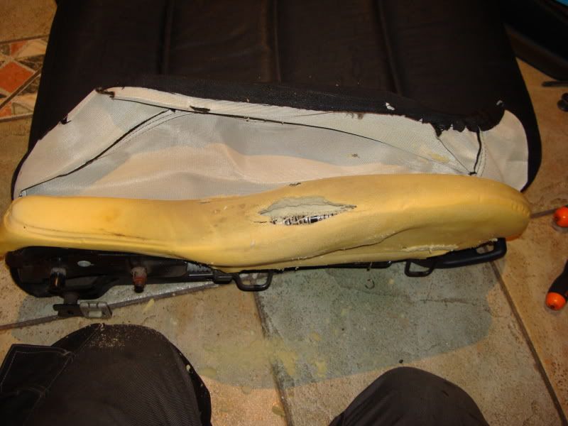

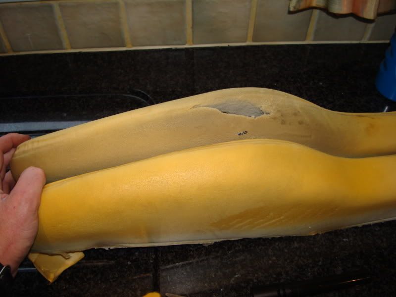

Old worn drivers seat lower bolster
Big difference

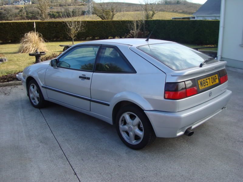

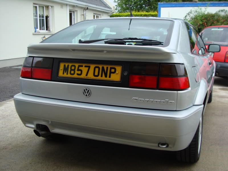

Tinted rears from empire graphics, and colour coded badges, also painted rear bumper and back pannel to freshen them up
Clear repeaters and new 90 mm splitter
Also bought a set of 16" BBS RCs, cant wait to get them on :D

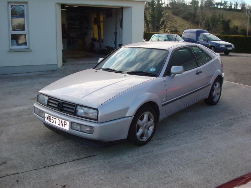

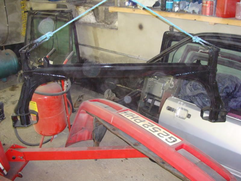

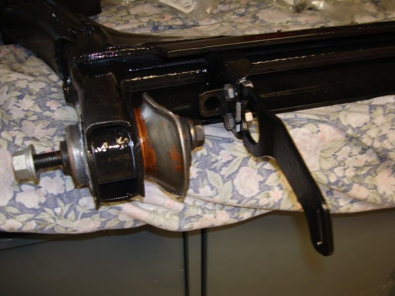

Well i thought it was about time for an update, i fitted the RCs for a few weeks, they looked well but i didnt like the handling of the car with them on so i sold them, the plan now is to convert the car to 5 stud and run it on speedlines which i love :) , so the car is on axle stands at the minute with the axle removed, ive blasted and painted the axle and fitted axle bushings today, ive also got spacers made up to space the rear axle out 13mm either side to have it the same as the VR one, ill get more pics up soon but here is a few

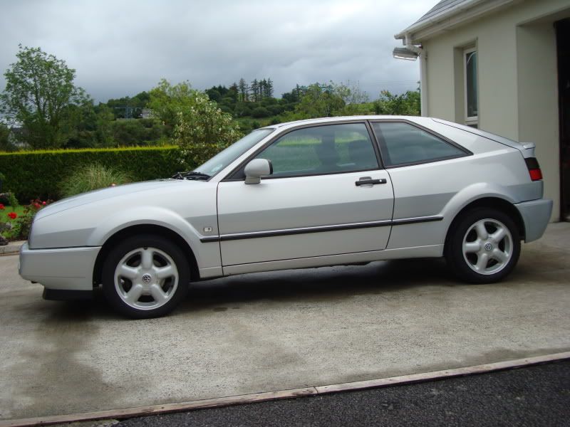

Speedline trial fitted

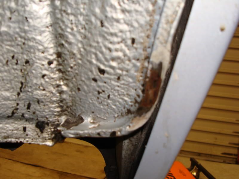

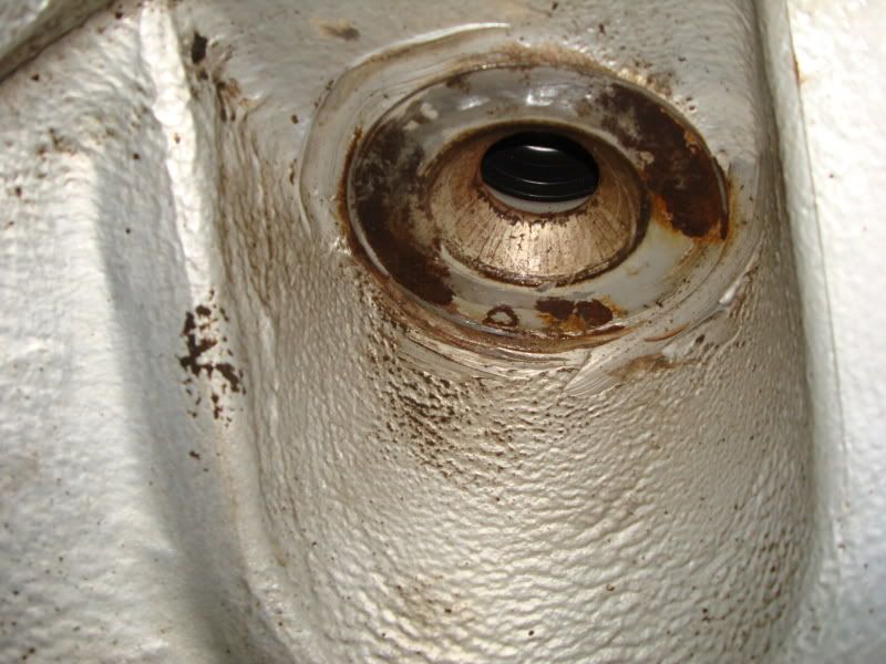

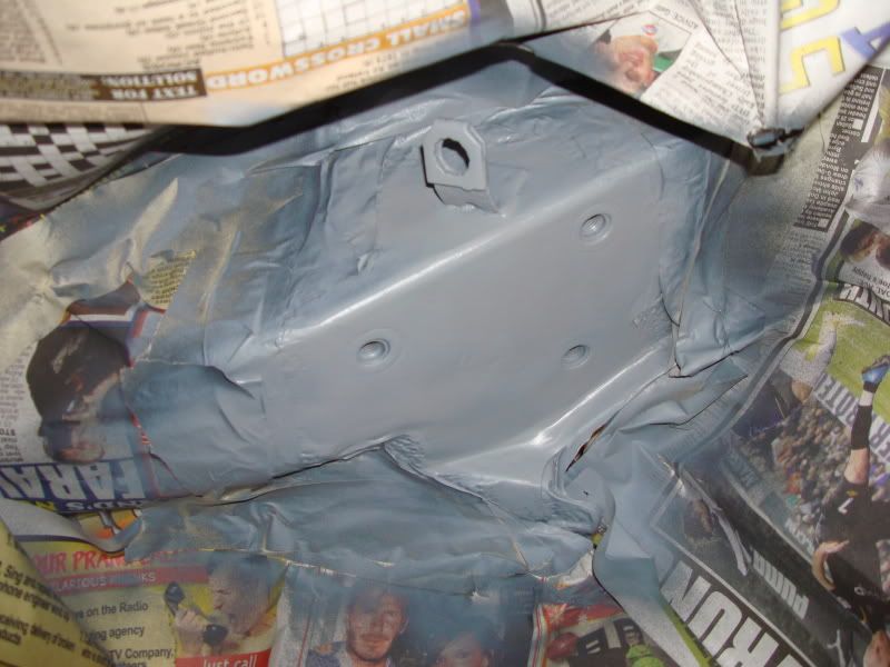

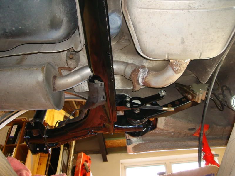

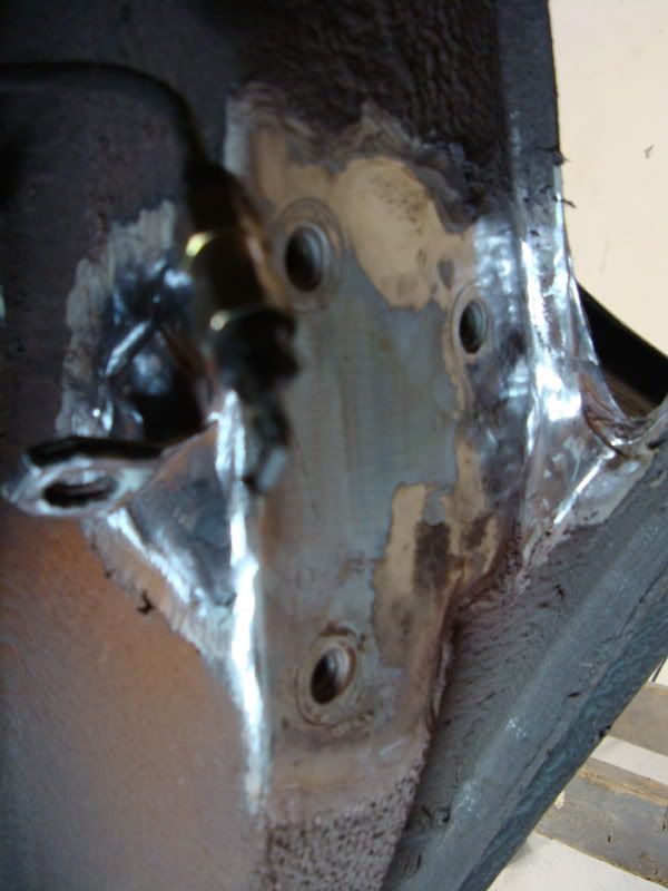

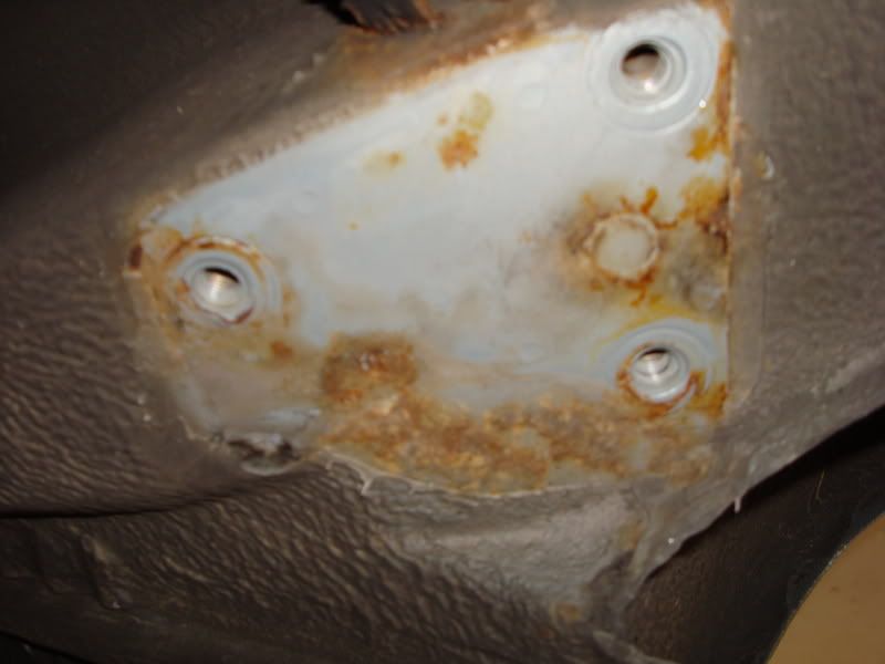

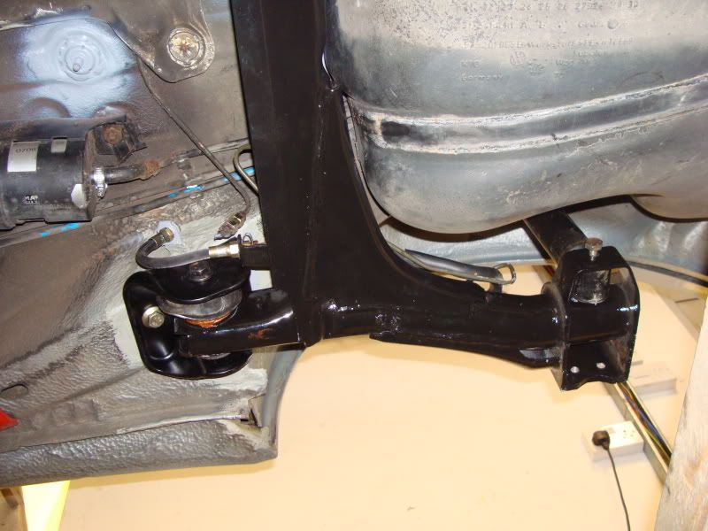

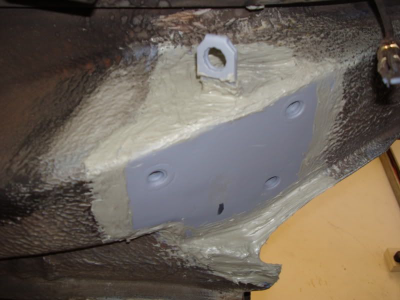

Have been doing some work to the 8v lately as it has been lying on axle stands for too long :( when i removed the axle i found a fair bit or rust so i started treating it
The dreaded rust
Ground down

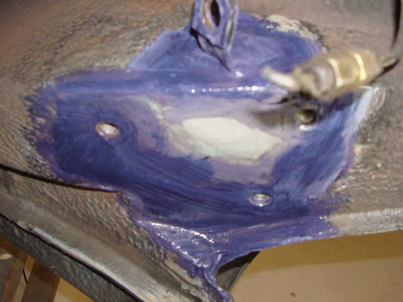

Rust treatment applied
Etch primed
3 coats of primer and some seam sealer

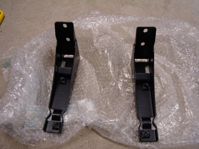

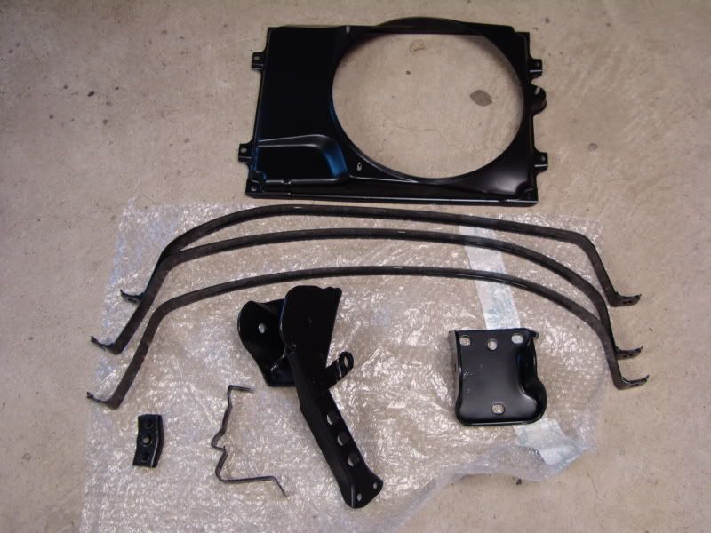

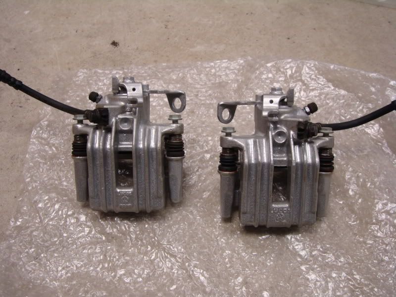

Mkiv calipers powder coated with new seals

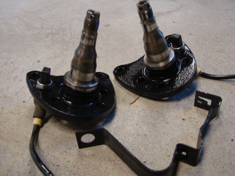

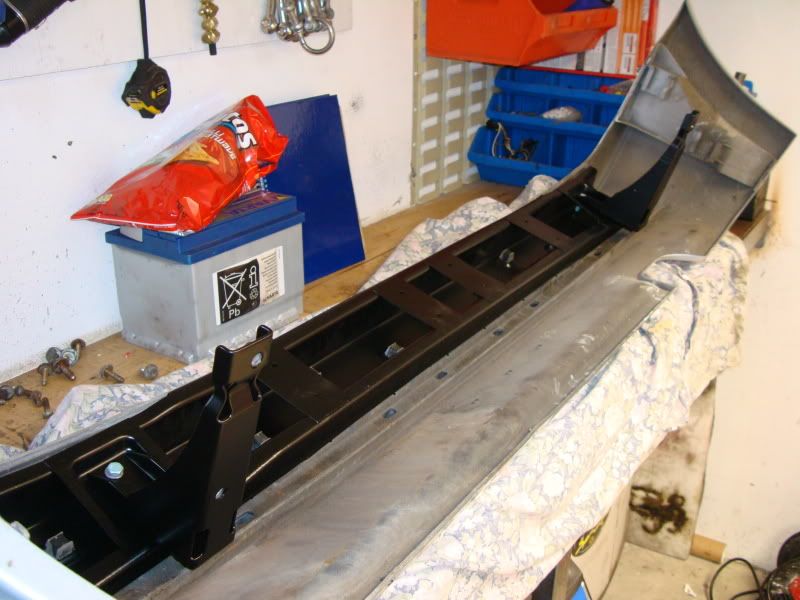

Some powder coated bits

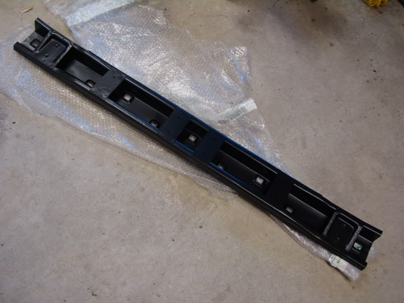

Bumper carrier refitted

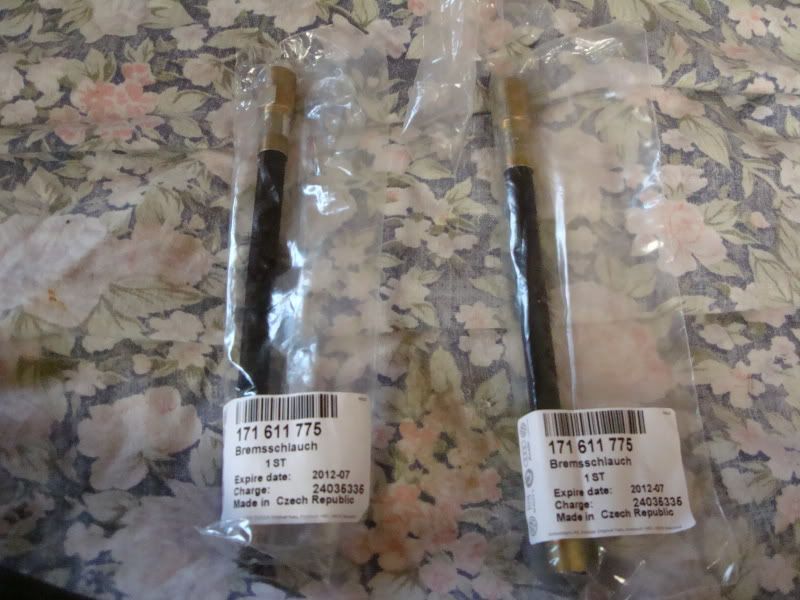

New brake pipes

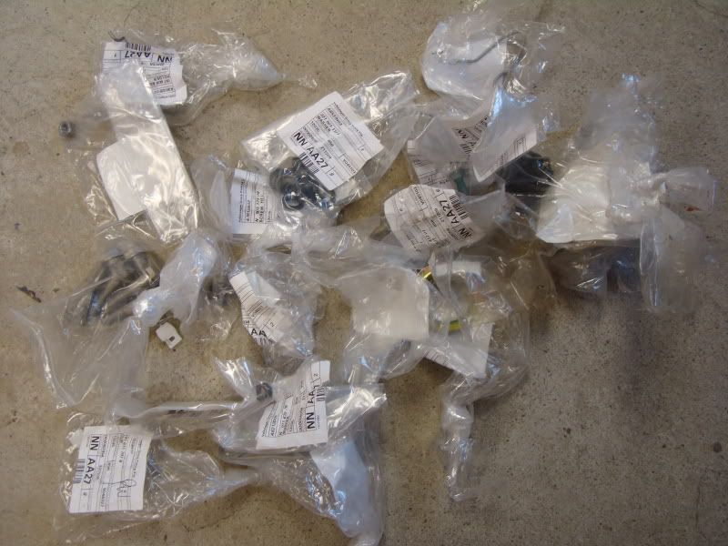

More new bits n bobs
New bushings fitted
Axle in place
Thats all for now, more soon :D

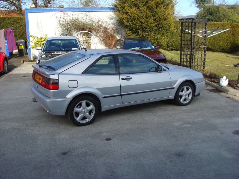

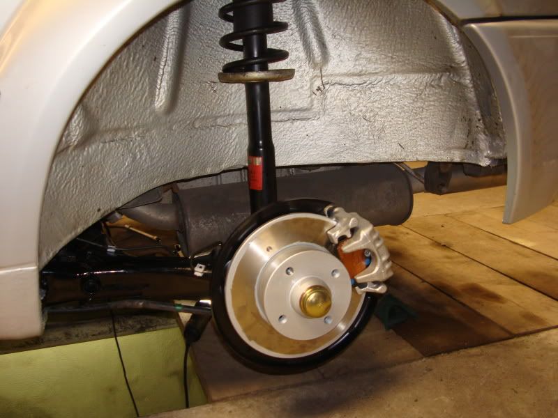

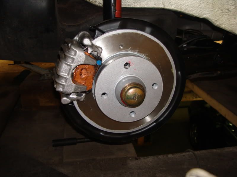

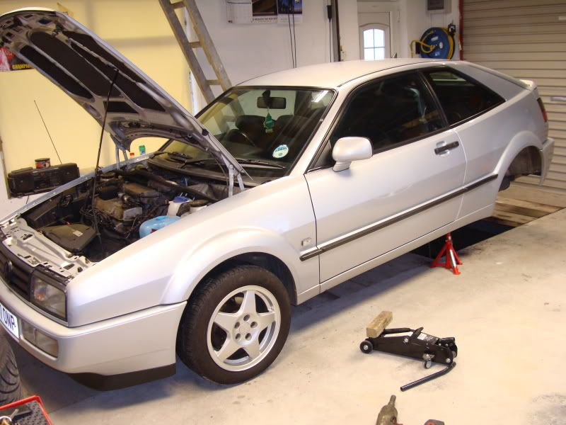

A small update, got the axle all torqued up, brake discs and calipers fitted and all bled twice. it was great to get it out as it was in the garage for about 4 months :D
Gotta love silver, four months of dust and it still looks clean :D
I have my new Milltek cat back comming next monday, cant wait, also dont know wheather to fit sebrings or get adapters and fit speedlines, all opinions welcome.
Gonna drive it for a while now and then tackle the front section
