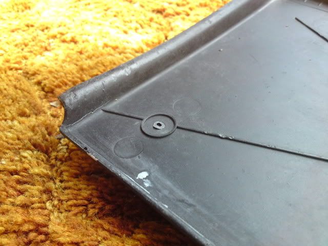

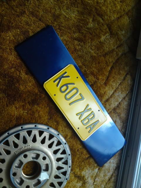

On the way to work this weekend my plate recess fell off, my fault :censored: now the bits are broke has anybody come up with a good solid way of fitting the top section before? plus I got a sub in the boot that doesnt help :wave:
the bits in question :scratch: :scratch: :shrug:
should look like this soon
silicone sealant... takes the pounding from a sub too...

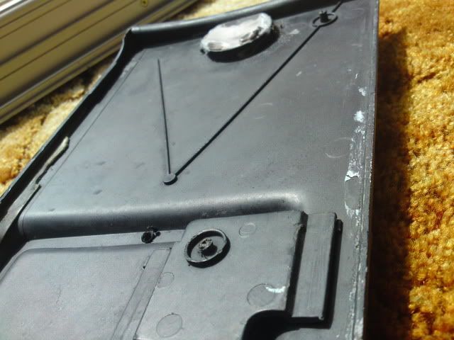

at the top where the bits are broke, what can I do there?
if you look at where the piece mounts onto the tailgate, you'll see that if you stick some BIG blobs of silicone sealant onto the tailgate where the original (broken off) tabs go through, it'll have enough contact to stick the panel back on... you'll need to tape it on tightly while the silicone cures, but it'll hold it with no problems once it's set... Mine was held on like this on my last 'rado and I suspect that it's held on this way on my current G60 having found the tabs in the boot after having the car resprayed... :roll: :brickwall:

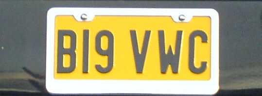

Use trim-tape or Velcro adhesive tape all round the edge. This is what I used when I had my US-spec surround like yours. You had any trouble with the illegal plate ?
Had it fitted for few weeks, then had misfortune to pull off a mini-roundabout next to my house right when there was an oncoming police T5 coming up the hill, saw my no front plate, pulled me, found the US-spec rear plate. Argued the toss with him about it seeing as correct reflective material, correct diameter and height of digits, correct spacing of said digits and corrrect font.
He was having none of it, gave me £30 fine and said if we catch you again we will report you to DVLA and they will take cherished plate off you :brickwall:
So bang went my idea of fitting a US-spec plate on a daily, shame as I think I was the first to have this. :(
