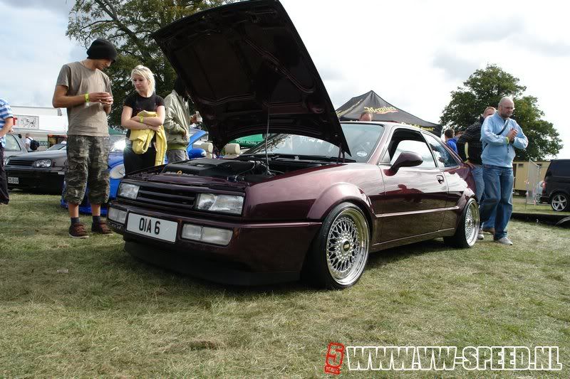

StormchargedVR6 0 Posted October 17, 2009 :) Vick, your car looking stunning as ever 8) stance is perfect DSC_0092-vi.jpg[/attachment:2u9tt37a] Quote Share this post Link to post Share on other sites

24V Renshaw 0 Posted November 20, 2009 I did indeed fit the MX5 mirrors to my Rado (now Vicks) and they are not a straight bolt on job. Fit off you have to trim a lot of the ally from the base to get them to sit level, I have seen a couple (including porsche mirrors) where they "droop" and look all wrong. You then have to change the holes in the base to suit the holes in the rado door. Then I made some trim pieces for the bottom to squash between the door and the mirror when bolted down. Fiddly and you need a bench sanding disc really. Much better mirror for visibility than the rado, plus the bottom edge doesn't go brown :) Jay Quote Share this post Link to post Share on other sites
