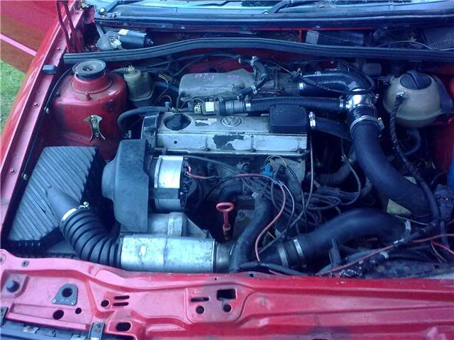

bit of engine completion, standard intercooler in. boost pipes fitted. t piece fitted to maintain manifold pressure. fuel leak fixed. repair spoiler mechanism. g60 clocks working!new headlight. wolfsburg door pins. bonnet pull snapped, new one fitted. found an airbox, k&n panel filter in.

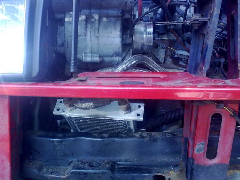

oil cooler put in.

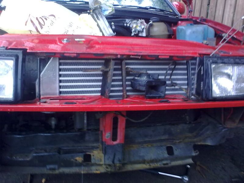

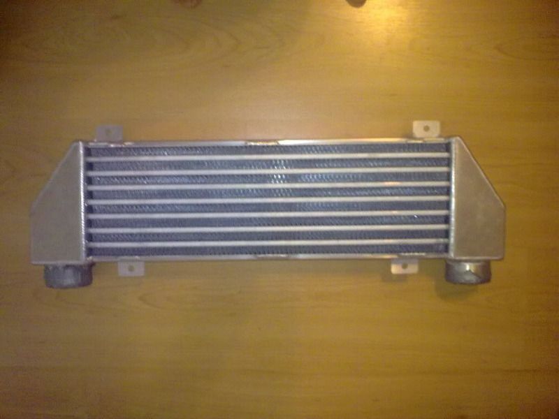

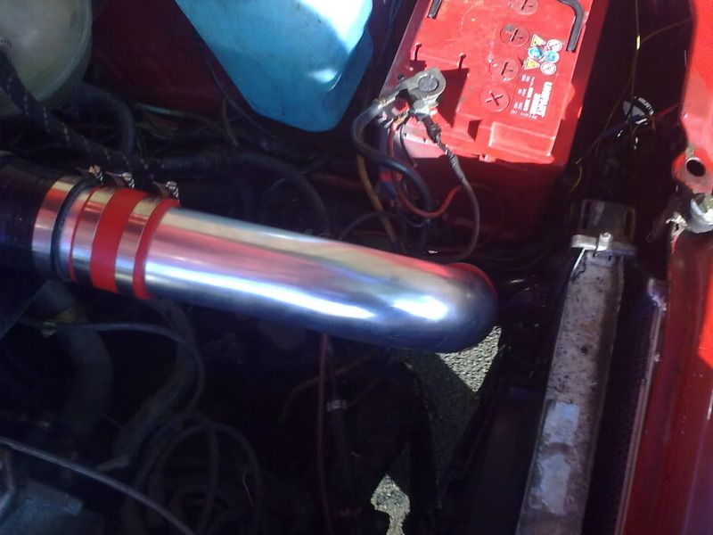

forge intercooler bought, all new alloy/silicone boost pipes. oil cooler out :mad2: new rear top mounts fitted. slimline radiator fan fitted. fitted gas bonnet strut.

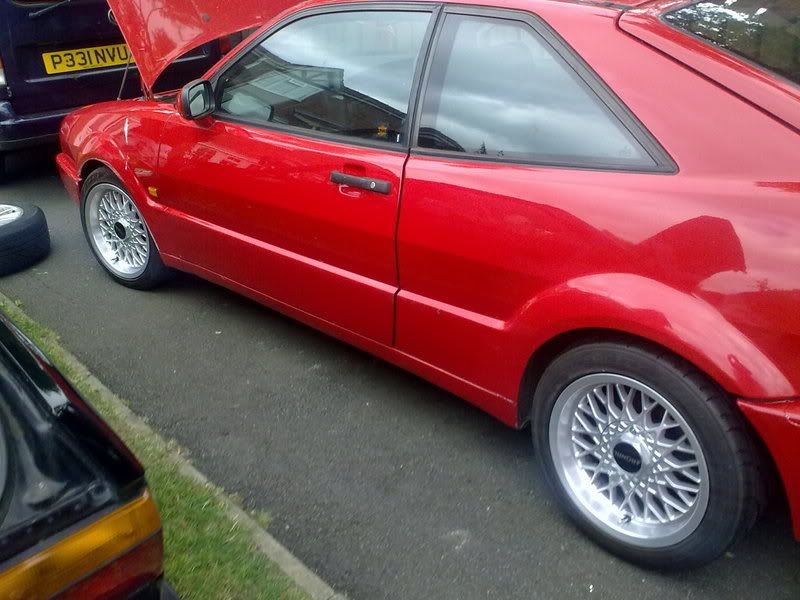

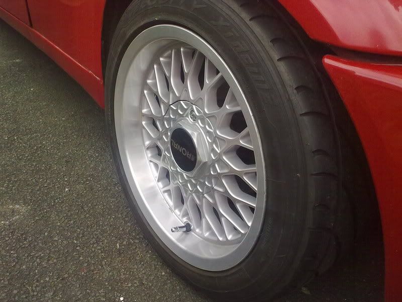

some nice new wheels!! (excuse the bird turd) love them at the mo. road legal slicks too, nice :norty: some turd nicked the valve caps already though!

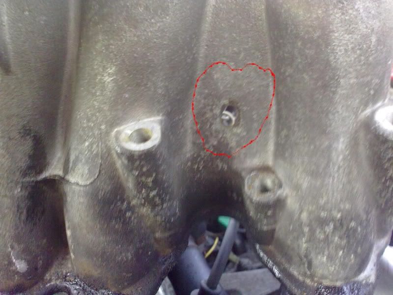

hole in inlet manifold,
seems ok though so crack on with it! nice casting defect too.....bloody volkswagen's a!!! :lol:
