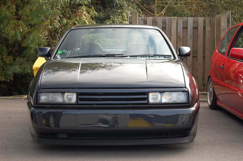

I have 25mm on the Ront running a 7j Rim and 35mm on the Rear running a 8J Rum, imo it could probably do with a 30mmon the front, pics will explain!
Rears sit Perfect! 8)
But the Fronts... What wheels??? :(
thanks for you photos :notworthy:
My issue is in the front, dont want them too inside of the car, but also i´m afraid to order larger adapter and after mounted them the tire rub in the wheel arch.
