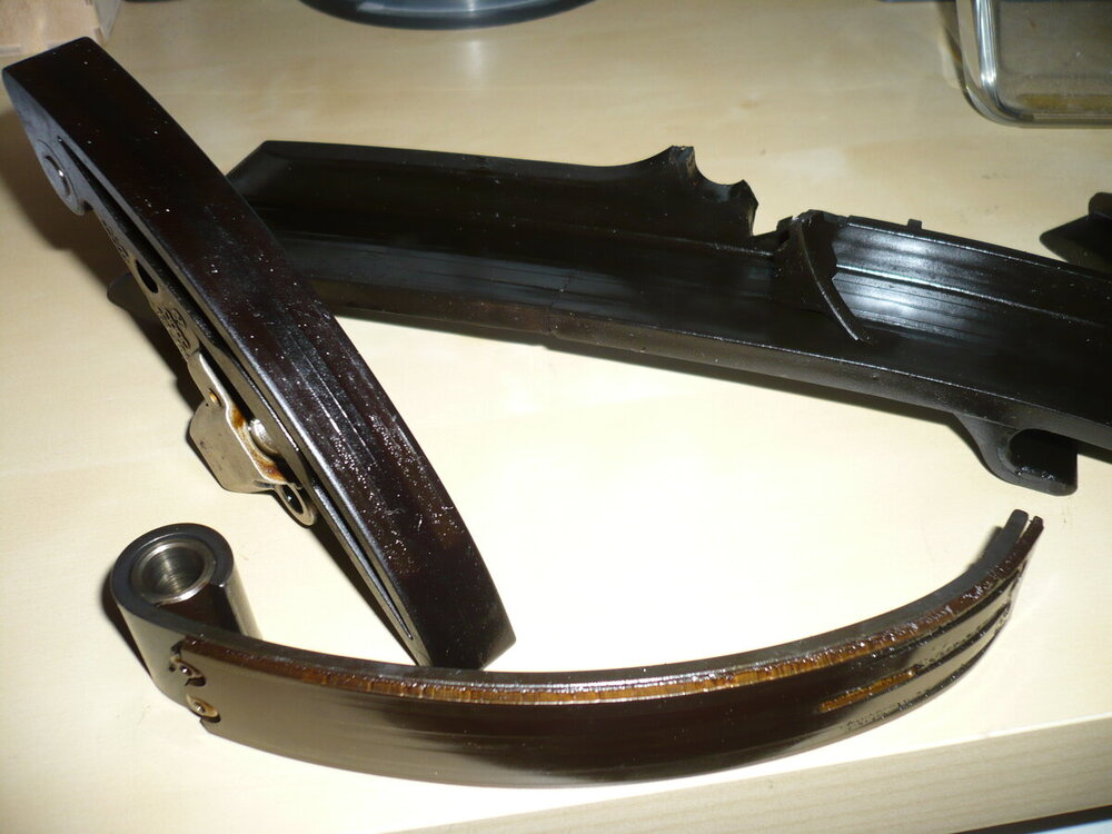

James. 7 Posted February 5, 2012 (edited) Managed a good half day on the engine today. Set to scraping all the old paint/oil/rust off the block (what a joy of a job) and then broke out the set of triple square sockets that arrived in the post this week. Before I know it, the flywheel's off and we're into the realms of chains and tensioners. It's a job that in the back of mind I knew would need doing. The car came stacked with history (and 175k miles), but nowhere in there was any evidence of them being replaced before. It would be foolish to take the engine out and not replace them so here we are. Time to be hopefully proved right that it was the right decision. Judging by what I found, it looks like I caught them in good time. The upper guide had broken at the lower mount. Part of it loitering about in the sump. Whilst halfway down, the old guide is a quarter width from breaking in half. Crikey ! Lower guide is worn but not that badly. The lower tensioner is worn and fit for replacement but it's the upper tensioner that's taken a beating. Worn through to the rivets at the top, and then broken away at the bottom. I'd have replaced them today but I wasn't happy with the quality of the new upper tensioner (see other thread). So this may need to go back yet. So it seems my engine may have lived long enough for me to catch them. Now then, where's the Swarfega ? Edited July 24, 2023 by James. Quote Share this post Link to post Share on other sites

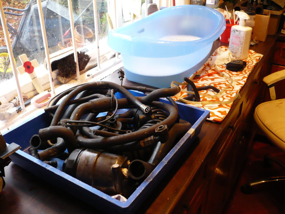

James. 7 Posted April 12, 2012 (edited) So I thought i'd have another couple of days at the Campaign. Where to carry on ? Well, I might as well start stripping all the nasty old loom tape off the loom. Most of it's rotted away and what's left is this black sticky/oily mess. It'll give me a good chance to inspect the wiring for breaks while I'm at it. It was a bit of a boring job. But it gave me the chance to do it at my own pace, sat in the bay, with the heater and radio on. Playing pop master and sipping sweet brews with only myself for company. Brilliant. When you've got a "too do" list as long a mine, it's easy to loose focus. So I then decided to remove all the last components from the engine bay / scuttle area. When to air con was fitted, way back when the car was new. They sealed it up with all the finesse of a five year old. What looks like black silicone has been poured into the scuttle area and "smudged" into all the openings/grommets. Being extra careful to drag all the excess under the inner wings and bonnet hinges. A thing of beauty it is not. Then moved onto the exhaust. And then this is where the game plan really takes a beating. Dropped the front part of the exhaust and removed the cat forward. So I think to myself "Ahh sack it, lets take the back box off as well". Thing is, it's an original exhaust, and they are huuuuuge. So I'm sat on the floor, sipping my brew in quiet contemplation, when it hits me: "Maybe it would be better to drop the rear beam off ?". And that was that. By the end of the second day, the rear beam and all the braking components are stripped and ready for the powder coaters (And there's me saying that next year was the back end). Ran into a couple of issues (Rear beam bush cup removal and brake compensator). But managed to come out on top. Had to cut one of the bush cups out and had to cut the compensator off. But managed to get it off in one piece. I'll face the compensator on the milling machine and drill out the bolts when I'm back at school next week. But I don't envisage any serious issues. I'm just thankful to whoever replaced the rear brakes just before I bought the car. They made sure that ALL the bolt threads were covered with copper grease. My arms are aching now. Never imagined the rear beam to be THAT heavy. Feel like I've been bench pressing with Lou Ferrigno ! Edited July 24, 2023 by James. Quote Share this post Link to post Share on other sites
