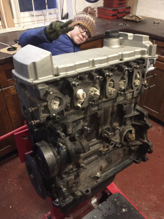

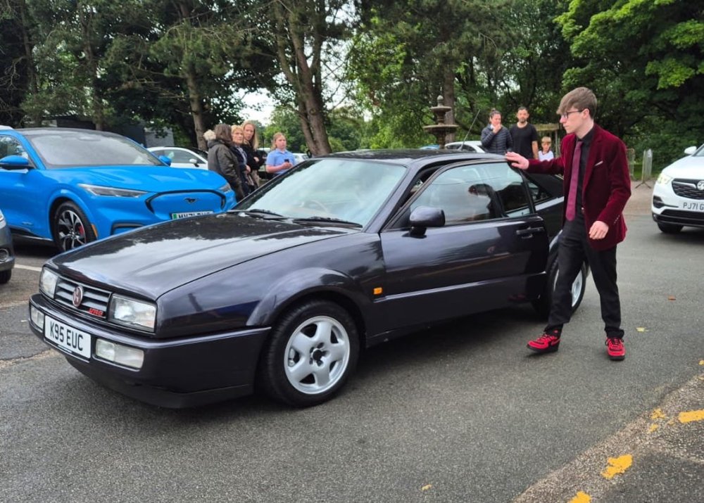

_Matt_ 26 Posted Monday at 02:48 PM Nice update James. With nearly 11 and 9 year olds myself the last two pictures remind how fast time goes by. Quote Share this post Link to post Share on other sites
