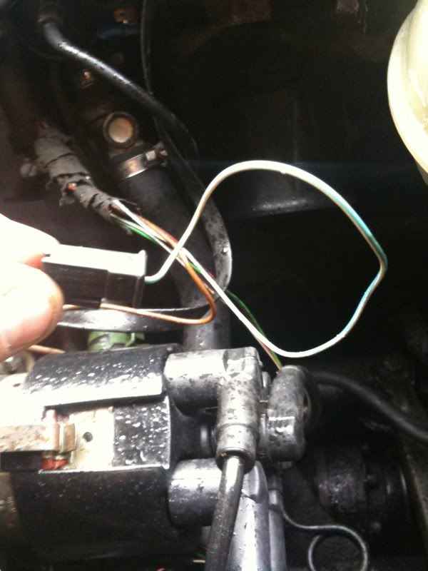

right, the engine is in, every thing attached, all fuilds in there but when i turn the key the starter engages to the flywheel but it dosnt turn.
I have 1 loose wire. its a blue and white 1. my mechanic mate thinks its the flywheel position sensor.

did u stick with all the k-jet management and not the abf? ive swapped two 9as on kr management in the last 2 weeks and cant think for the life of me think were that wire goes. ill pop the bonnet on my car later today and have a good look around for it. did u take note of what wires went were or just pop em off and leave it to memory?

I think the blue and white is just an unused cable in the loom, intended to run as the signal feed from a variable pressure sensor to an oil pressure gauge. (that's on a KR loom)
you should find the other end unattached behind the fusebox/dash somewhere

well it's def not a flywheel pos sensor KR doesn't have one
without looking at mine (it's at home) there are several single wires near the distributor
oil temp sensor on the back of head
3 water temp sensors (identical) around the head water outlet flange
none of these will stop it starting/firing

i had a quick look at the wiring for for, as david said that shouldnt stop the car from starting as it is only a wire from a sender and krs dont have flywheel position sensors, again as david says i have the what looks like the same wire tucked up doin nothing down by the oil pressusre senders, mine looks like it was zip tied back at he factory. yours in the picture appears to be by the dizzy so when i looked around there there was a slighty similar lookin wire goin to the top right of the 3 water senders by the coolant flange, bear in mind i was lookin in the dark with a mobile phone for light, as for the AA dont tell em its been converted in the future, they would never know any other way. good luck anyways pal hope it works out for ya,
