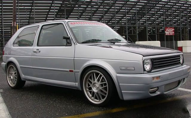

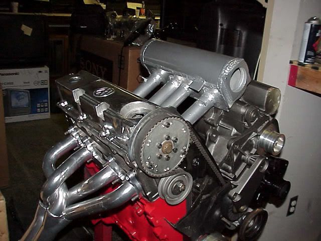

BigTartanJudge 0 Posted October 14, 2008 Dunno, there is plenty of info on these set-up's over on VW Vortex though. I know of one crossflow G60 that was in a silver MK2 that made around 300BHP. It was a demonstrator car for a US-based tuning company. I think they went out of business though and are no longer around. Its always been something that I have wanted to do though, as I can't justify spending another £2000 on a Eurospec or similar CNC-head for the relatively small amount of gains to be had. Also, don't particularly want to spend another £2000 on a 1.9 or 2.0L bottom end conversion either. I had seen that head for sale over on edition38 too and was thinking about getting it....but like you too late. These and similar heads are ten a penny over in the US, would be quite easy to pick one up I reckon, although postage would be a bit exp. Quote Share this post Link to post Share on other sites
flusted 0 Posted October 15, 2008 when you say crossflow g60 was that turbo'd Quote Share this post Link to post Share on other sites
BigTartanJudge 0 Posted October 15, 2008 No it wasn't turbo'd, it was a 2.0L 8V G60 x-flow using the G60 charger, see below: Quote Share this post Link to post Share on other sites
