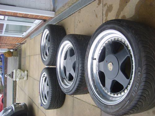

radojunkie 0 Posted March 31, 2010 ive just bougth some porsche fitment 3 piece oz futuras off a porsche (5x130). they are 7.5x17 on the front with 9's on the rear. the tyres which are on there are fronts 225- 45- 17 and rears are 245 -45-17. my car is a 92 g60 with 4x100. theres a few avenues which i could go down to get em to fit: 1) buy adaptors 4x100 - 5x130 2) fill and redrill 3) i have a 96 golf vr6 brake set-up with carriers, calipers,stud axles, discs and pads which would take it to 5x100 which is closer an give me 8mm more on the brakes but would leave me not being able to fit my originals for winter and leave me in the same non fitting predicament 4) cut the whole middle out, weld in a new plate and cut to 4x100 5) or sell them :( what do you guys think, i havent got a large budget but i am mainly conserned about safety? :confused4: Quote Share this post Link to post Share on other sites
bristolbaron 11 Posted March 31, 2010 ive just bougth some porsche fitment 3 piece oz futuras off a porsche (5x130). they are 7.5x17 on the front with 9's on the rear. the tyres which are on there are fronts 225- 45- 17 and rears are 245 -45-17. my car is a 92 g60 with 4x100. theres a few avenues which i could go down to get em to fit: 1) buy adaptors 4x100 - 5x130 2) fill and redrill 3) i have a 96 golf vr6 brake set-up with carriers, calipers,stud axles, discs and pads which would take it to 5x100 which is closer an give me 8mm more on the brakes but would leave me not being able to fit my originals for winter and leave me in the same non fitting predicament 4) cut the whole middle out, weld in a new plate and cut to 4x100 5) or sell them :( what do you guys think, i havent got a large budget but i am mainly conserned about safety? :confused4: why would you consider anything but adaptors? the rest of the ideas are kinda crazy.. there are two sets on here for sale at the moment. you're gonna need new tyres too as what you have will be nowhere near fitting. i'd recommend 195/40s & 205/40s or 205/40 & 215/40 depending how you want the car to sit. You will need to cut the arches for the rears to fit if this hasnt yet been done. What are the wheel offsets? This is just as inportant as the other info you've given as to whether you can make this work. Quote Share this post Link to post Share on other sites

radojunkie 0 Posted March 31, 2010 im a kinda crazy guy :cuckoo: :lol: just weighing up the options, forgot to add the et, there 55 and i think the furthest you can go up to is a 45 with 17" on a c (should be 38 allowing for 7mm each side) the rear arch needs repair work so im thinking of getting the arches remade anyhows. wouldnt be just a rolling jobby im guessing? Quote Share this post Link to post Share on other sites
radojunkie 0 Posted March 31, 2010 here they are anyway Quote Share this post Link to post Share on other sites
