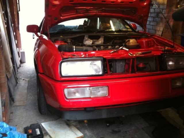

picked it up last wednesday.. looked pretty clean from the ebay pic

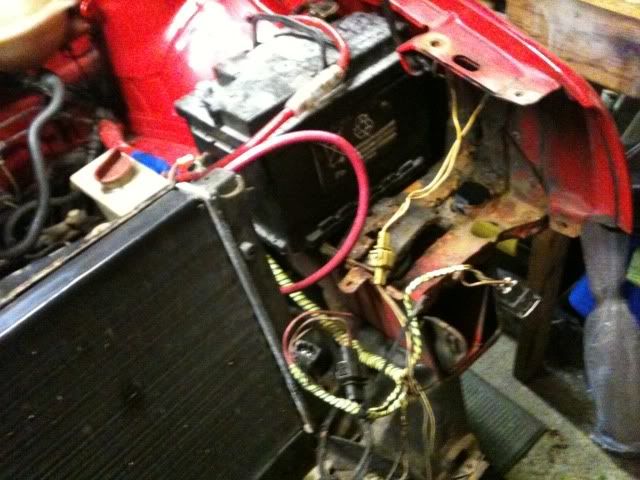

Battery tray has been horrifically repaired before!

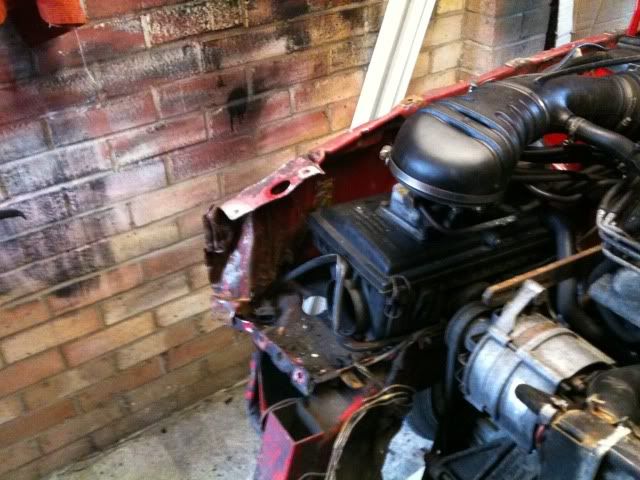

unfortunately, as I didn't pay much attention to the car itself, I didn't notice this! so I'm on the hunt for someone stripping a shell to hopefully get a replacement section!

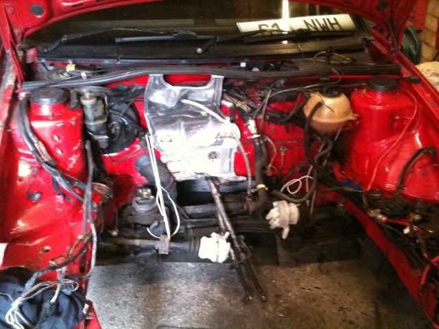

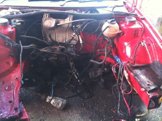

after a casual day of unbolting everything
then started to clean the bay up..
and that's how it sits at the moment
I'm planning... battery install in the boot, smooth and clean inner wings, paint the gearbox and block red (might look rubbish but thought I'd try it out), and everything else silver, going to make my own exhaust and intercooler pipework as well

If I get time this weekend I'll make a start sorting the mess out which is the battery tray

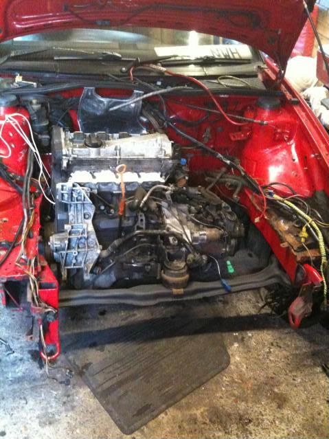

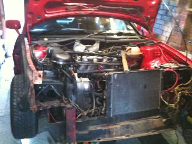

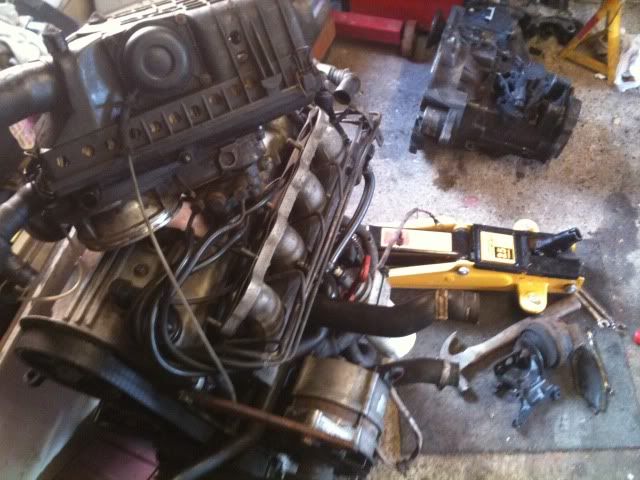

Test fitting the engine + box
being an AEB lump I've put a Mk4 exhaust manifold on to shift to turbo but need to make some adjustments so the turbo will clear the bulkhead
a local garage is going to weld up the inlet manifold for me when it comes to it, I'm not a fan of welding aluminum so thought I'd get someone else to do it
got a list of parts to swap over from the 16v - sump + oil pick up, oil filter/cooler housing (both will be tapped for the turbo oil feed) and thinking about running the 16v alternator/power steering setup as it's convenient instead of sourcing a Mk4 bracket for now and all just bolts straight on
