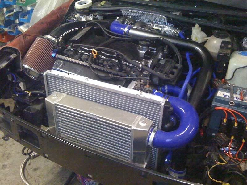

jamminvr6storm 0 Posted November 29, 2010 Good figures there Coullstar, sounds very nice too :D Yeah I'm 8.5:1 as well. I'm wondering if it could be intercooler related? Both me and JamminStormVR6 seem to make good numbers and our engines are practically identical, and use the Schimmel charge cooler, which is significantly less volume to fill than a front mount IC + all the piping. Im running 9:1 CR with no Cat, full 3" system... but, I do not run the schimmel CC Kev.... I have a custom Forge FMIC Quote Share this post Link to post Share on other sites
StormchargedVR6 0 Posted November 29, 2010 Good figures there Coullstar, sounds very nice too :D Yeah I'm 8.5:1 as well. I'm wondering if it could be intercooler related? Both me and JamminStormVR6 seem to make good numbers and our engines are practically identical, and use the Schimmel charge cooler, which is significantly less volume to fill than a front mount IC + all the piping. Im running 9:1 CR with no Cat, full 3" system... but, I do not run the schimmel CC Kev.... I have a custom Forge FMIC That is really nice set up, thats how i wanted to go Quote Share this post Link to post Share on other sites
pete_griff 0 Posted November 29, 2010 ^likewise^ lovely tidy install Ben 8) Quote Share this post Link to post Share on other sites
