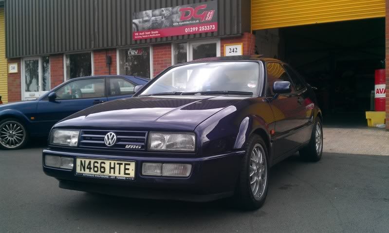

VR6 Lee 0 Posted August 29, 2011 (edited) Few pictures from my trip to Cat and fiddle the other day. Not been for ages, bit annoyed at the 50 zone average speed cameras!!! grrrr!!!! ---------- Post added at 09:17 AM ---------- Previous post was at 09:02 AM ---------- ---------- Post added at 09:47 AM ---------- Previous post was at 09:17 AM ---------- ---------- Post added at 09:48 AM ---------- Previous post was at 09:47 AM ---------- Right back to business, ever since I bought the VR, it still has a problem with the fans kicking in to early and all the time. 1st stage is kicking in at 82 degrees 2nd stage at 89 degrees From a test at DG the temprature is reading correct around the engine so where would you start to diagnose the problem and has this happened to you lot. What is the normal running temprature of the vr and what degrees do your fans kick in at. Edited August 29, 2011 by VR6 Lee Quote Share this post Link to post Share on other sites
