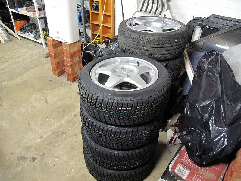

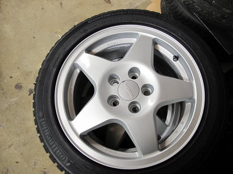

Kevin Bacon 5 Posted January 11, 2011 I took my speedo centre cap down to a local paint supplier and compared it to their wheel silver swatches. The best match was a Chrysler colour. "Chrysler Bright Silver". Code W5B (or could be WSB, the blokes writing on the tin is terrible) It's a fairly standard / common colour apparently. Make sure you use wheel silver specifically. Regular metallic paint is too coarse and doesn't look right. Here's a set I painted in November last year... the centre caps aren't painted, they're the standard speedline colour. Quote Share this post Link to post Share on other sites
