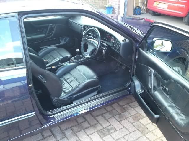

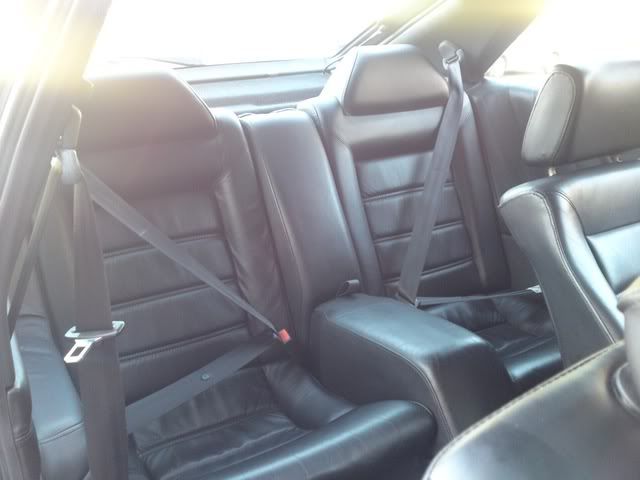

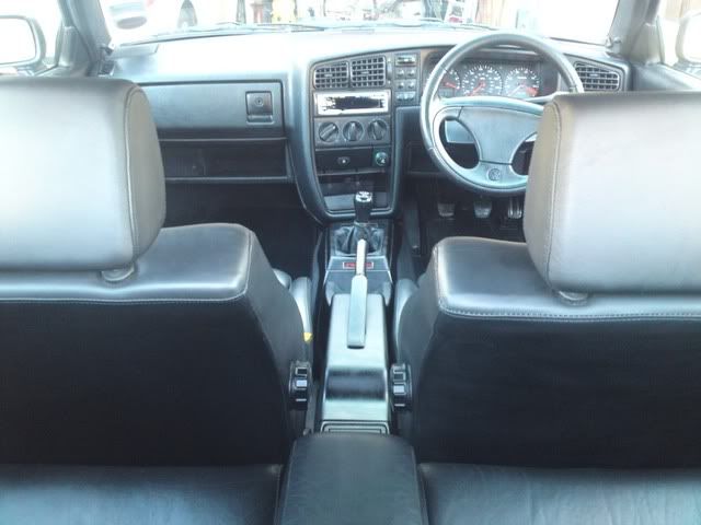

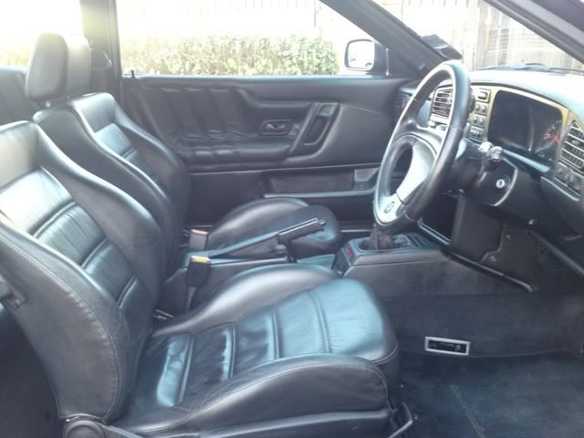

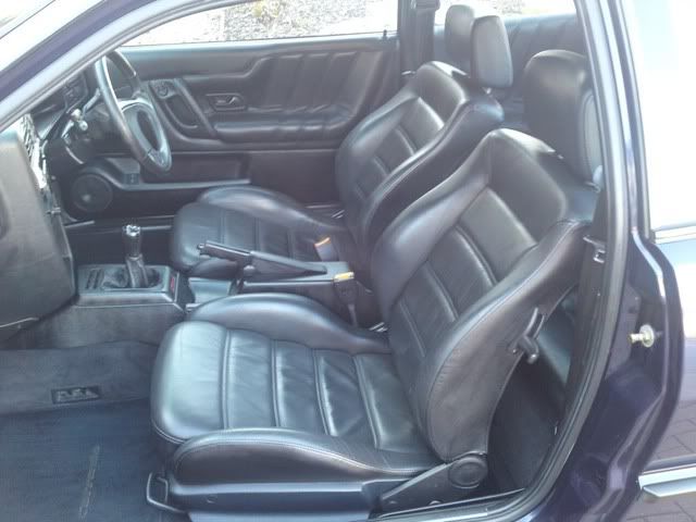

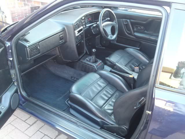

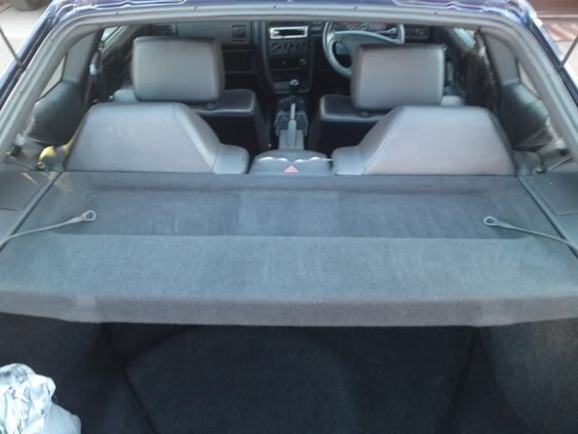

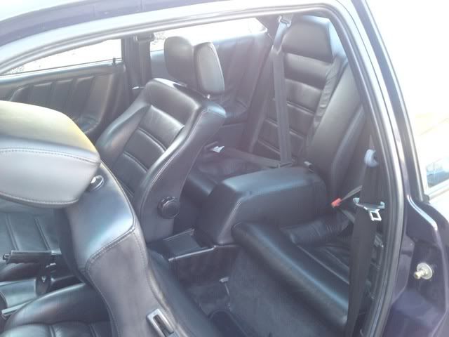

Inside was hooved with my henry and all black work treated with meguiars protective shine(not seen this in the uk i bought it in america)
Havent treated the leather yet just given it a good wipe down but looks good i think.

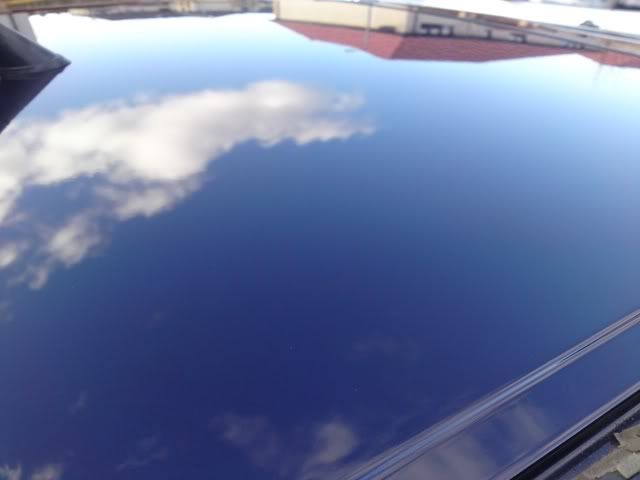

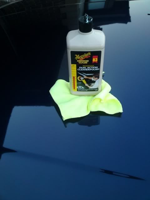

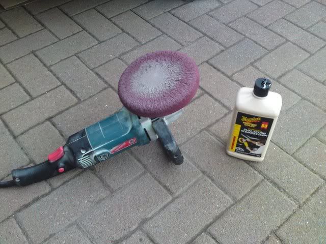

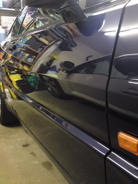

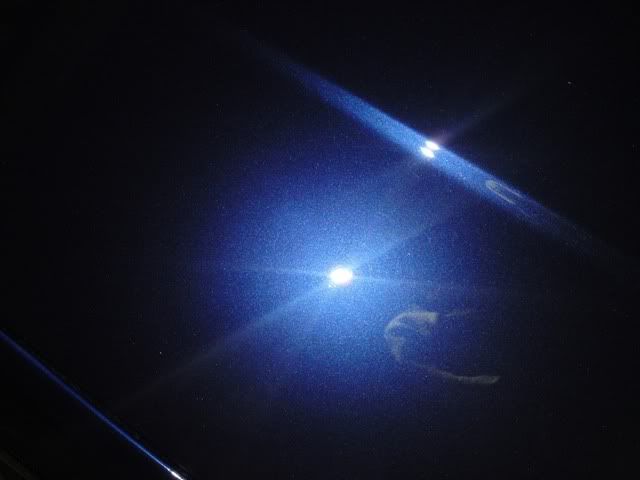

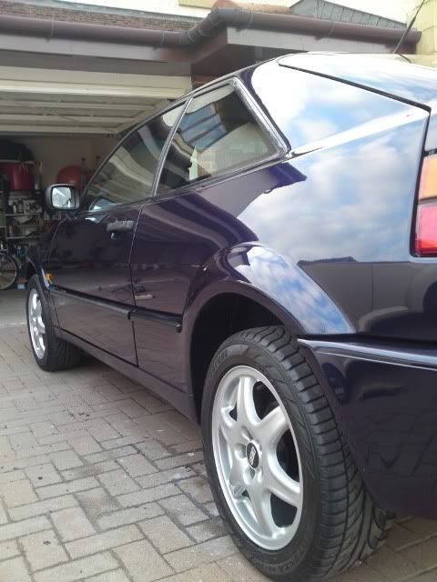

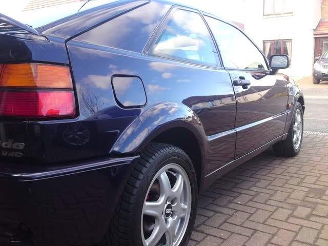

Next was time to bring out the good old trusty machine polisher! Using a meguiars pad on it and start at low setting 1 and work upto setting 3 once the polish is deminished and back down to 1 again to reduce any marring or streaks.
Compound wise im using meguiars Dual Action Cleaner polish number 83. Have used it many times and really would reccommend it. Works well on darker colours or pearls aswell as i used it on my old golf vr6 which was black magic pearl(LC9Z)

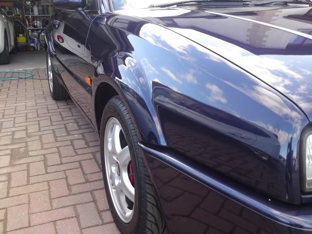

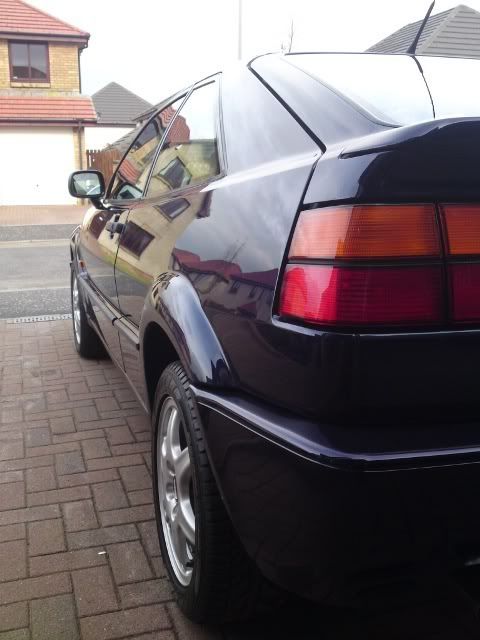

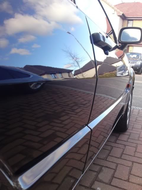

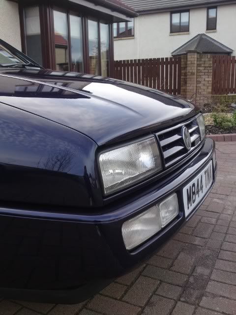

Bonnet after machined
Passenger wing reflection
99% swirl free paintwork. Excuse the small marks,i should have wiped the compound dust off.
Reflection shot
Only got the 2 wings,bonnet and drivers door done before it got a bit dark so packed up for the night. Shall maybe do some more tomorrow,if not will be sunday i think before i get time again.

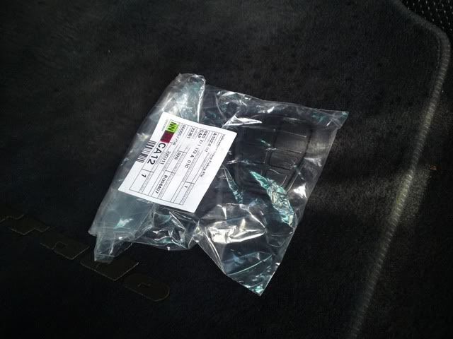

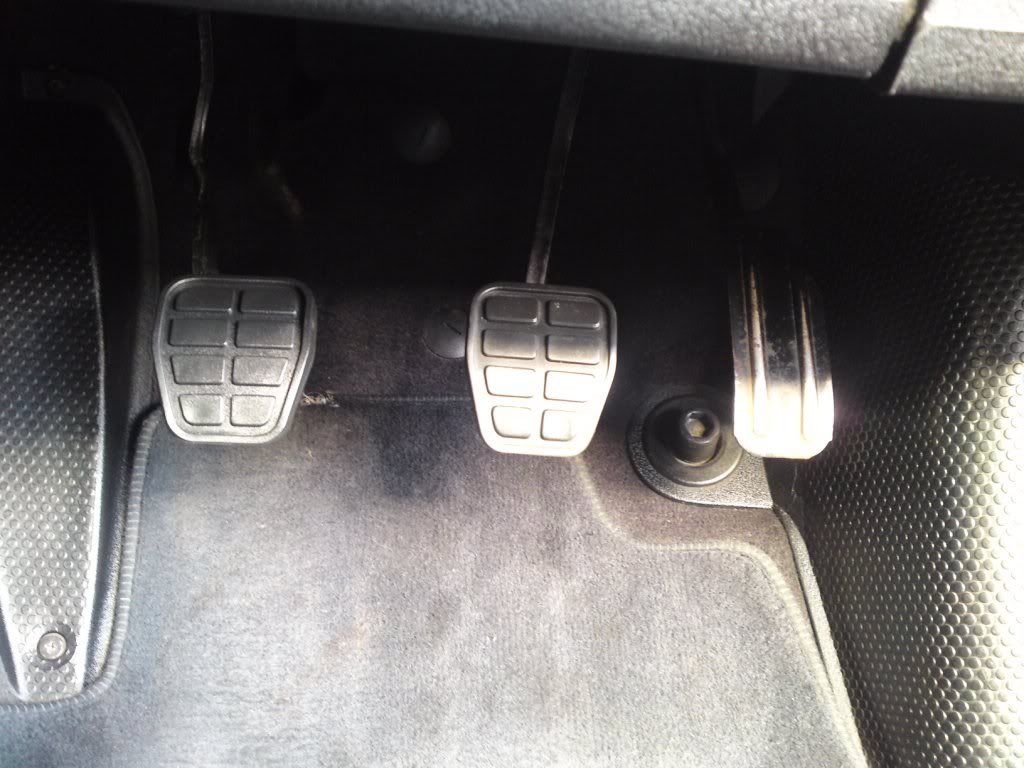

Nice pics fella, noticed from the pics your missing the pedal cover off your clutch, a pair of new ones can be had off ebay for cheap if you decide you need a pair
Ha! i was waiting for someone to pic up on this. Iv got a new one on order from VW, get it on saturday!
Haha they can be a bugger to fit, warm it up first
Yeah can be a right pain indeed iv had to do them before. Fitted TT pedals before and they are alot easier.

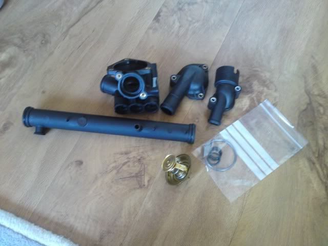

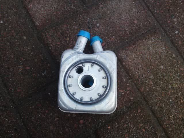

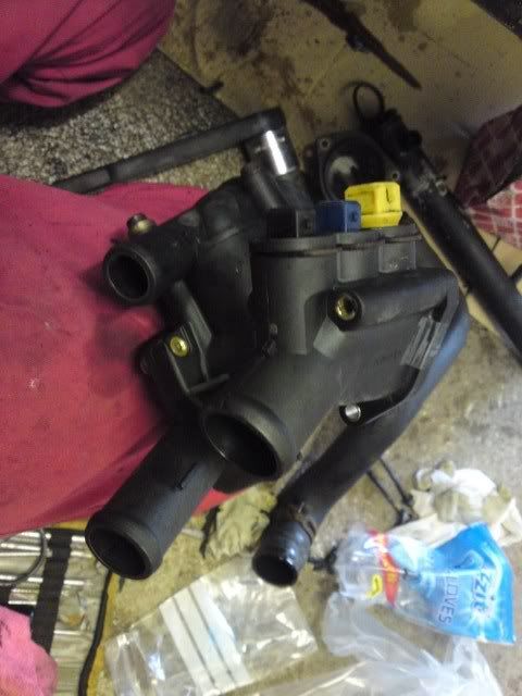

Decided if i was doing the crack pipe and thermostat housing etc that i might as well change the oil cooler while im in about that area and saves having to take the front end off twice. One nice new oil cooler and seal ready to fit:
Think im going to get this and the other bits fitted tomorrow so i can then get the car in for its MOT soon as possible.
Got a new clutch rubber as well as the other had a small slit in it. Just keeping it tidy and up to the standard of the rest of the interior.
Part:
And fitted. Brake pedal ones not got much wear on it. Might give the accelerator a coat of black paint just to freshen it up:

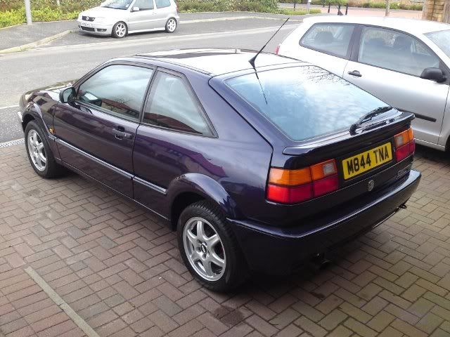

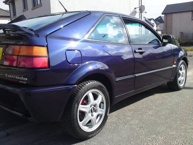

Battered on with more of the machine polishing today but still not finished it. Have done everything apart from the passenger door,front bumper and grill so need to get them finished next. Finished the bits i had done off with P21S Concours wax and then chemical guys sealant to keep it nice and shiney.

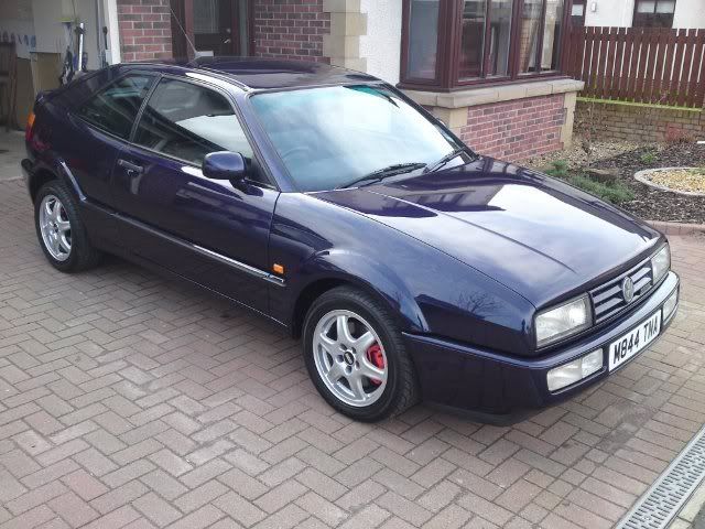

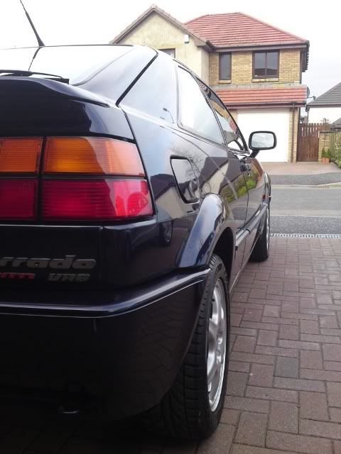

Far away shots dont look much different:
Some close ups:

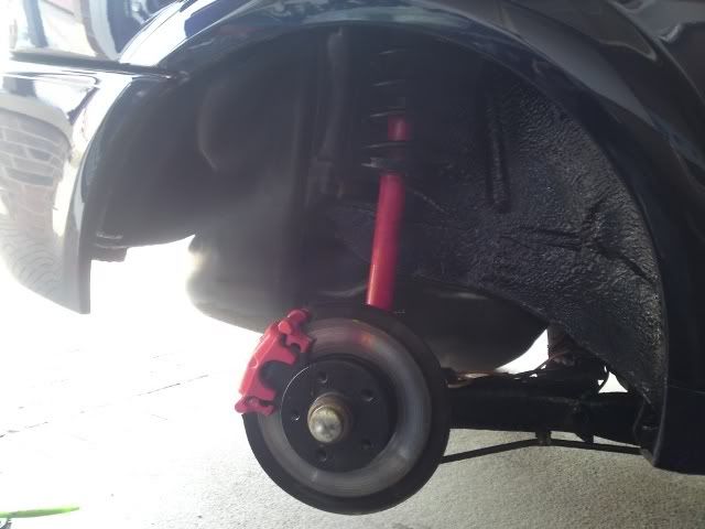

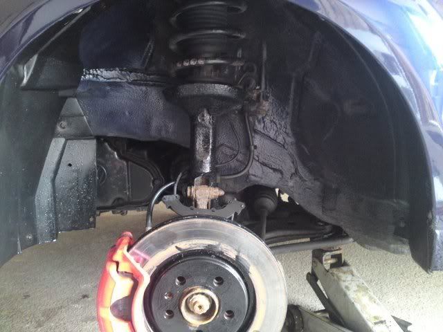

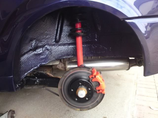

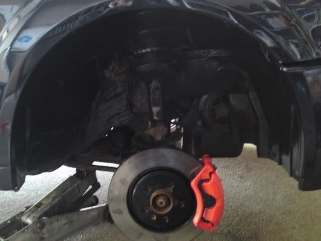

Decided to whip all the wheels off,clean inside the arches and paint up the areas on the discs which had surface rust so it all looked a bit tidyer.
Here goes:

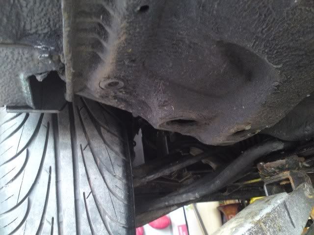

Thought id also take a pic to show just how solid it is around the common areas for crumpling etc. Can really tell its been all main dealer on the ramp work before the fact is looks like a trolley jack has never seen under here other than me now.

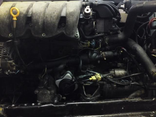

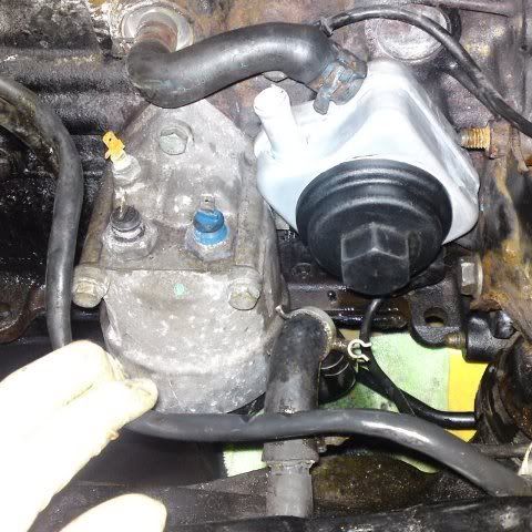

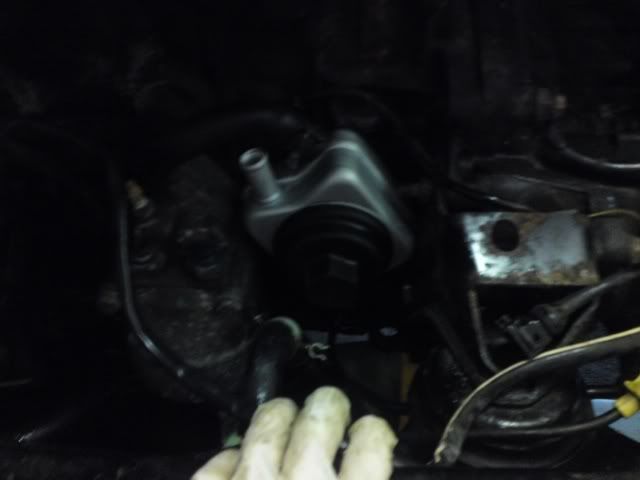

Up this morning and on with what i still had to do to get the rado completed. Got the new oil cooler and crack pipe,thermostat housing and thermostat fitted no bother. Glad i did the oil cooler as looked a bit scabby and past it. More nice new parts on it.

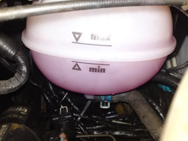

Flushed the coolant system before the new parts were on with coolant flush and then filled it back up with 2 bottle of G12++ and water. Nice and pink again!
Got pics but there sadly not the best as light was very poor in the garge and was raining outside.
here goes:

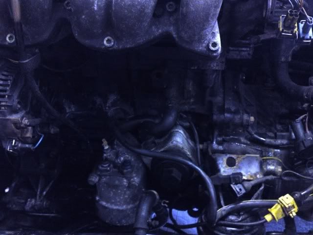

Old cooler about to come off,crack pipe off already:
One nice new oil cooler fitted:

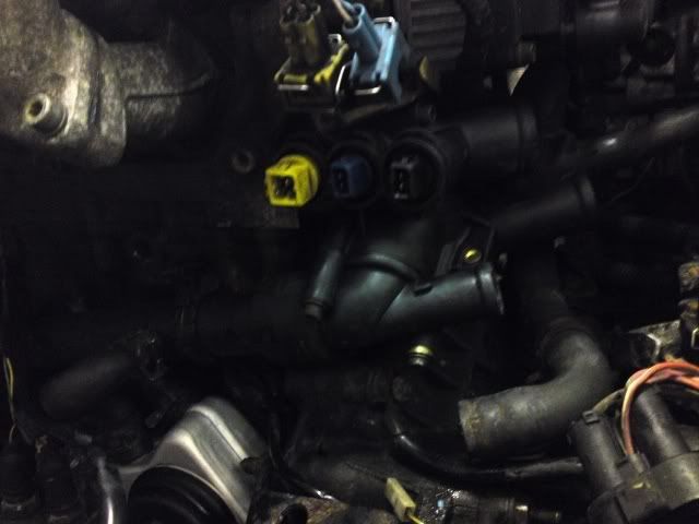

New thermostat housing ready to be fitted back on with sensors all in with new o rings. Gave them a clean up as were a bit grubby.:
Fitted:
All new bits fitted:
Fresh pink again:

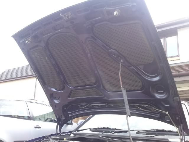

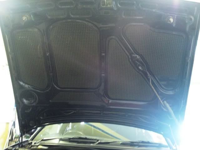

Took a pic of the under bonnet sunproofing as well as relised how good nick its in still!

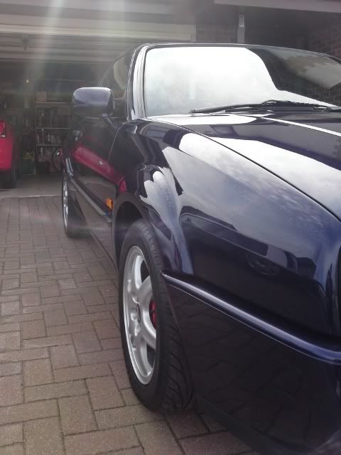

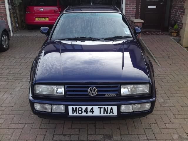

Pictures once the sun comes back out as i also finished machine polishing the front bumper and grill and wax and sealed them with the same stuff i used on the car.

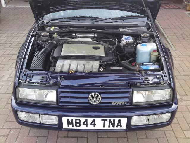

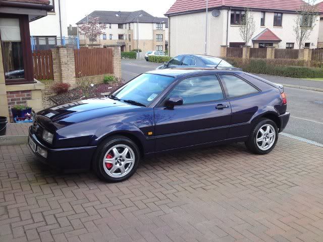

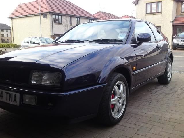

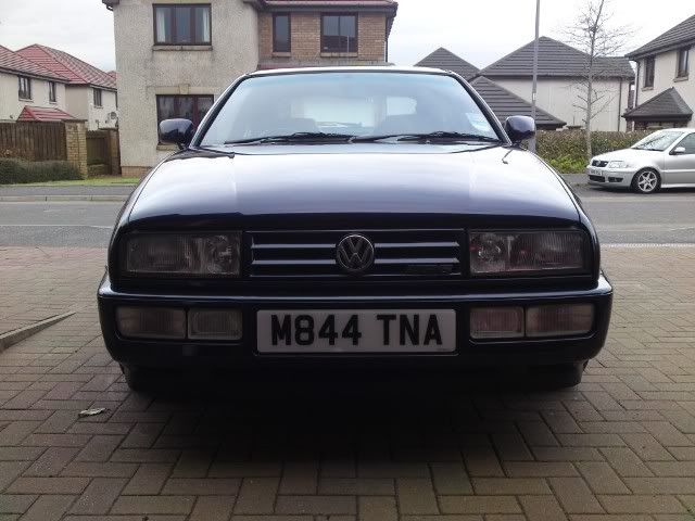

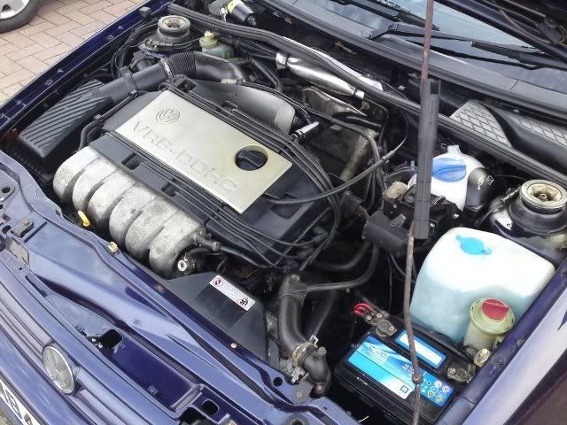

All ready for its MOT in the Morning so took it a wee drive and gave it a quick rinse ready to go. As always im a big picture person for threads so heres a total picture overload since i never really got to put ones up of it finished.
Had intended to take the manifold off again and spray it to freshen it up as i reckon it would really improve the engine bay but never got around to it.
Here goes:

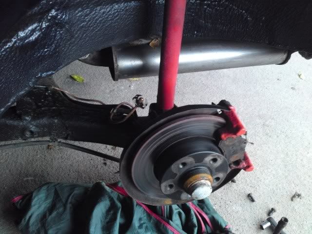

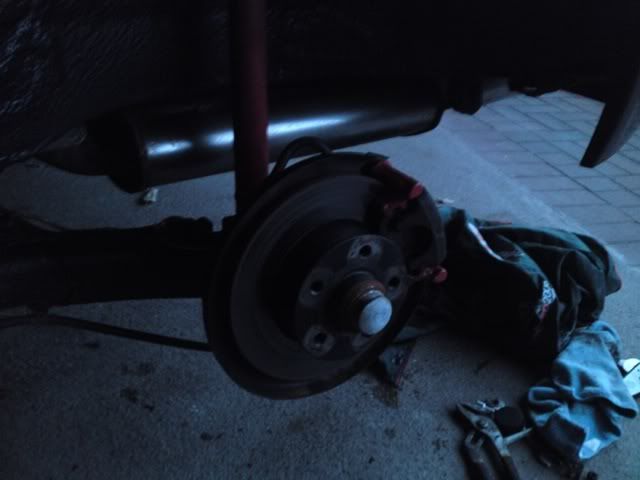

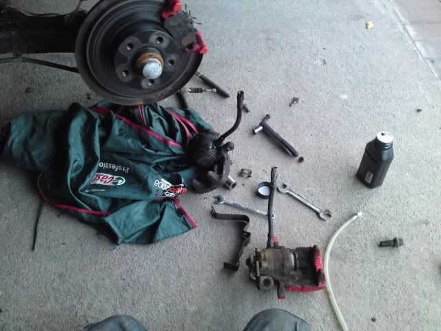

Caliper was causing improper brake balance on the rear so whapped off the rear caliper and fitted another which was working perfectly.
Once the old one was off noticed why it was being caused,the rubber boot for the piston was mangled so dirt must have been getting in. Nice fully functional caliper fitted and all back together now.
Excuse the photos,ended up working till after dark last night to try get it all done.
Just need to get the caliper paint out again now so the caliper ties in with the carrier and the other 3 brakes!

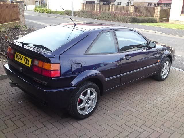

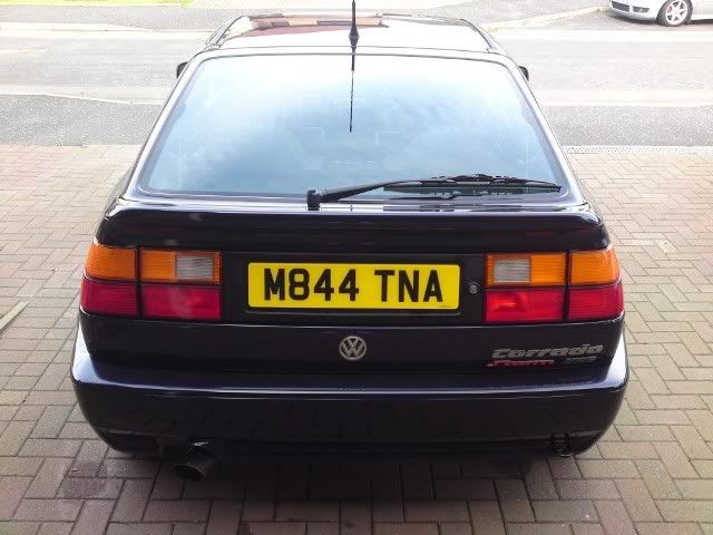

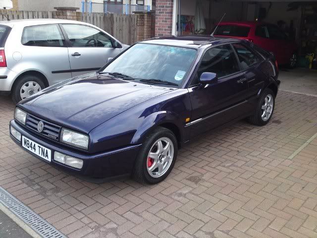

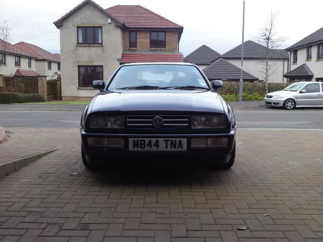

So all the work finally payed off and it rolled out with this today!
Fresh MOT till next April! No advisorys and got a load of comments about it at the garage i got it MOT'd

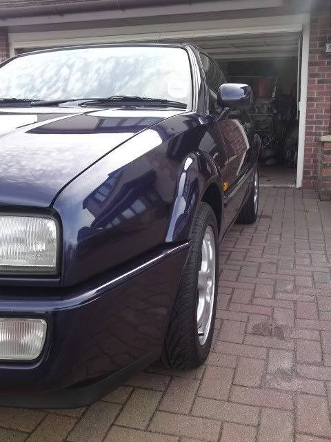

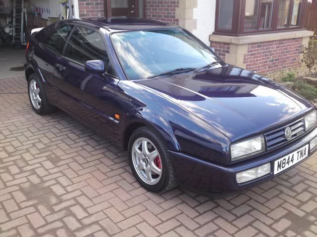

Sadly was raining the day i took it down for its MOT so got slightly dirty. Didnt get a chance to clean it so today sorted that.
Got the brake that i fitted painted up to match the rest as well.

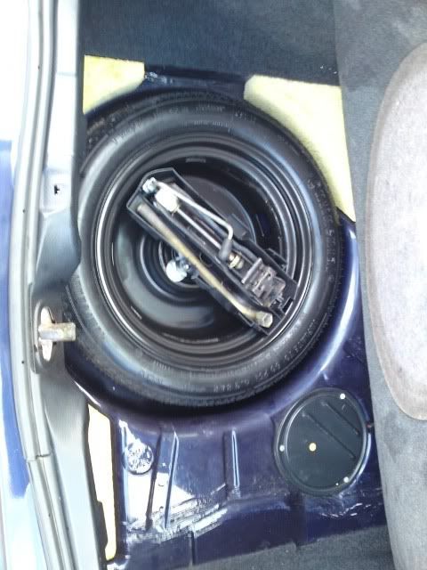

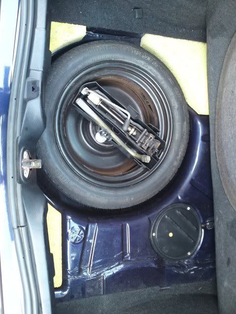

Cleaned in the spare wheel well as it had rusty brake dust from when i first used it when i got the car.

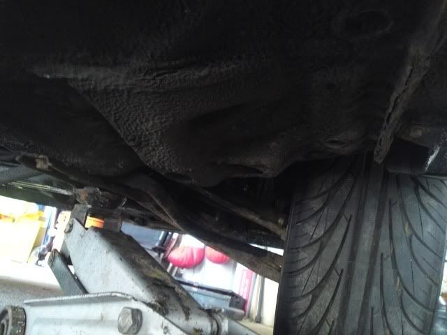

Looks nice, but impact gun on the bumper bar...... why???
Also underside may have seen many trolley jacks! Using wood between the jack and floorpan tends to leave no marks :D
Makes things a hell of a lot quicker. Especially if working underneath. Not exactly an air impact gun either.
Even still with wood iv seen many dodgy underneath. I was clearly stating it had never been improperly jacked up causing crushed sills like many suffer!
