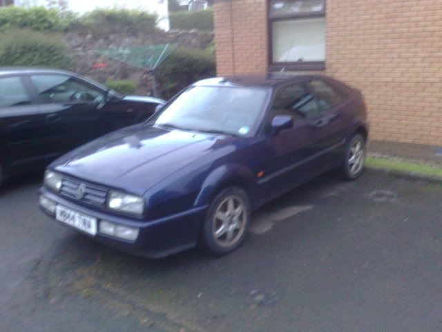

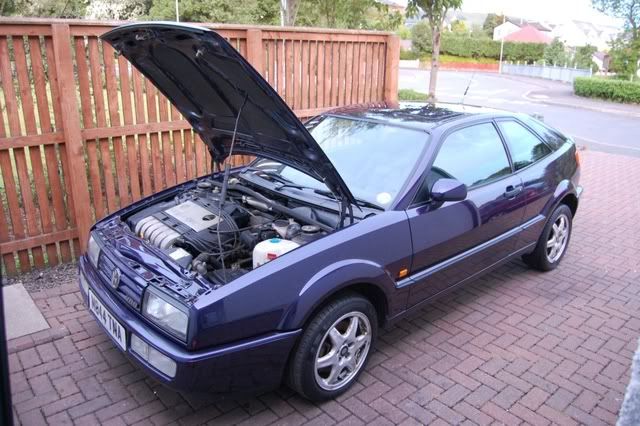

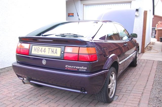

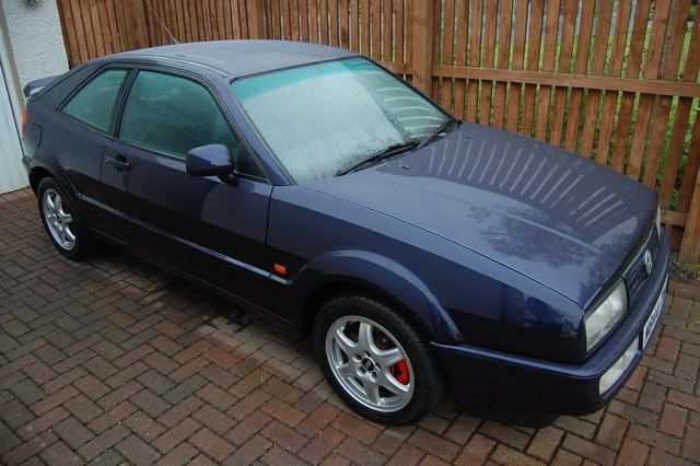

Scott-mk3 0 Posted March 17, 2011 Well i thought id finnally start a thread on here about my storm as i no longer have my nugget build. Was told about this in my local town to my surprise that i had never seen it even though passing the area nearly every day! Went door chapping to try and find the owner and the situation and a few days later got possesion of it and brought it home. This was around july last year. Cant believe iv had it that long now,times flown in. Pretty much a short run down of it: M plate storm with 98k Miles on it and 2 previous owners me now the third. Guy i got it from bought it from down south circa 2001 so had it a good few years but sadly it was put off the road late 2009ish. Full VW service history right up until its last service of 89k. All documented with the service book & Dealer reciepts. Car really has been pampered all its life looking through the history. Interior is immaculate in it and once i gave it a good clean am very impressed. Bodywork had a few imperfections but nothing i couldnt resolve or pull a few favours in for from my mate who painted my nugget. Heres a very bad photo of how i got it but was in a bit of a rush to get it transported from where it was sitting: So once i had it back home gave it a good gutting to see what i was to start with. Wheels were badly corroded so a refurb was 100% on the cards along with new tyres. Usual stuff like brakes from lying also needed done but this was no big issue. Drivers wing had sufferered some corrosion around the indicator so didnt bothered about trying to fix the rust just went for a whole new wing. Sourced one on here in mint condition and had it sprayed up nice and fresh and sealed on the inside. Beautiful colour mystic blue when its fresh paint! Pics from once id given it its first good gutting which took a good days work: Starting setting about ordering parts i was going to replace on it and the list began New disks and pads all round New rear wheel bearings New windscreen Drivers Wing Wheels refurbished New tyres Clutch kit New arial & base plate New Metal Impellar water pump Full service kit (NGK Plugs, Genuine Filters etc) New Registration plateS (Although have kept the old dealer printed ones) So after some of that work was done it began to look the way its sitting more today. Inside the arches i gave a full clean with degreaser and sealed them to protect from the weather. Gave the shocks and springs a clean up too seen as they are quite noticeable at standard ride height arch gap How it has been sitting just now : For peace of mind and being used to working on VR6 engines for a while now iv decided that it was time to do the chains and tensioners etc on the engine. Give it a full collant flush at the same time too. Down to the dealers again where i seem to be all the time now for parts,luckily my girlfriends works for VW which is handy. Bought the following: 10 Litres Quantum Oil 3 Litres G12++ Coolant Few bottle of Coolant Flush all parts to do the chains,tensioners and guides New Coolant bottle to freshen up the bay a bit Few odds and ends clips etc So this weekend will be getting set about completing that and then in the next few weeks will be firing it in for its MOT which iv no worries about at all and reckon it will pass first time. Was struggling on a place to store it for a while but luckily now have a nice space in my girlfriends parents garage so it shall be tucked away where i can give it a full detail for the summer weather. Tidy the engine bay up and get the paintwork as mint as possible. Comments and criticism welcome,will update as i do more etc. Tempted to slightly lower it to reduce the crazy arch gap but going to leave it completly standard the way it should be. Scott Quote Share this post Link to post Share on other sites
easypops 8 Posted March 17, 2011 Looks superb in the photos mate.......really shiney :shades: Quote Share this post Link to post Share on other sites

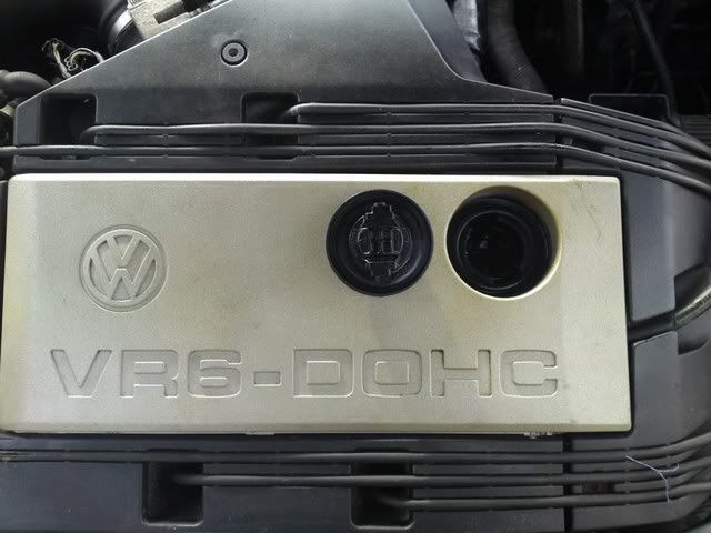

James. 7 Posted March 18, 2011 Looks like a little belter. Top tint screen as well ! How much was the new header tank ? Quote Share this post Link to post Share on other sites
Scott-mk3 0 Posted March 18, 2011 Appreciated guys! Was one of the things i wasnt 100% on first doing the chains but this will be my second time doing a set so should be no bother now and have the cam shaft locking tool for it now. Not too bad once you actually get to them to fit the new ones! Havent got a thread on DW sadly but will happily post up the product etc i use. Will be giving it a full going over again next weekend hopefully once iv done the messy stuff and will do a sort of right up for that as should be spending a good while on it. New header tank with cap was £27 im sure bud but remember all the stuff i buys at trade price,but shouldnt be much more. Did it in my last vr6,just makes the bay that little bit cleaner. Will keep it updated. Shall have the camera on the go tomorrow. 1 Quote Share this post Link to post Share on other sites

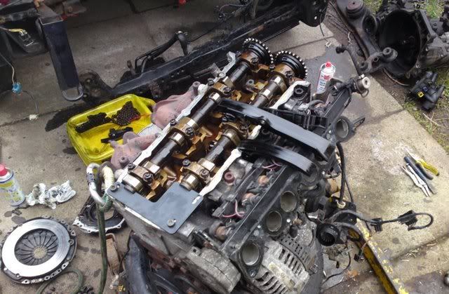

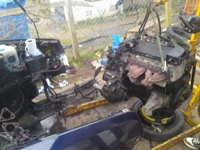

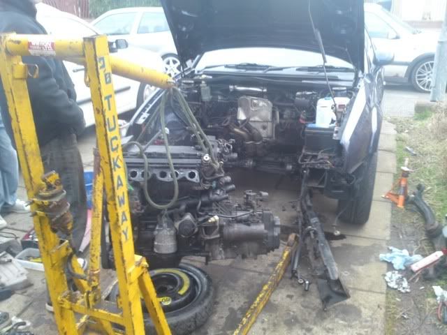

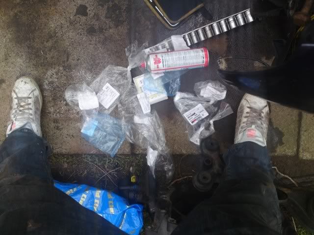

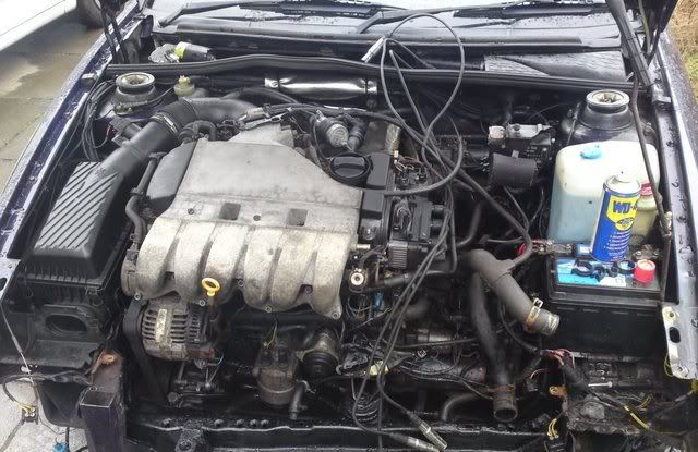

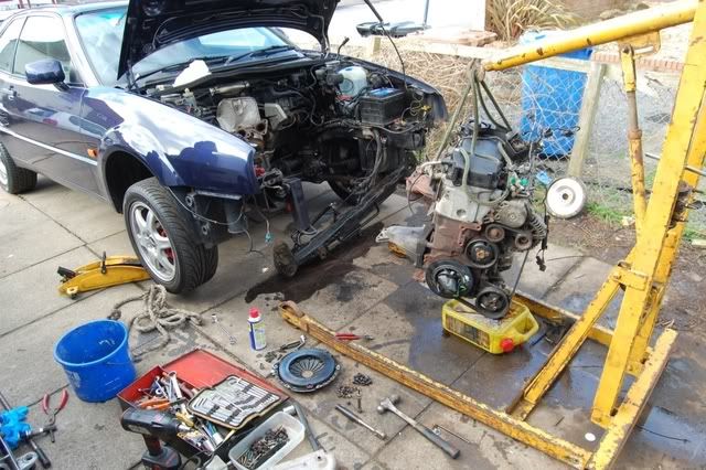

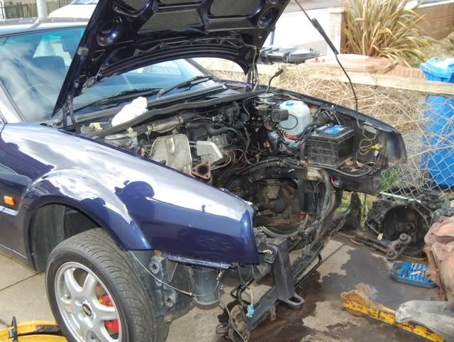

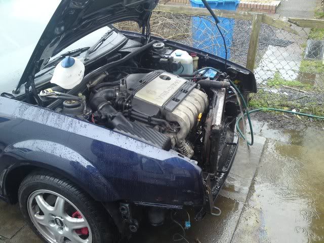

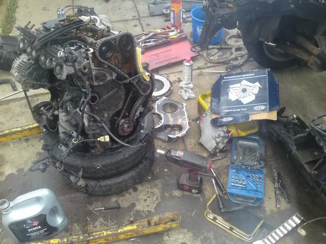

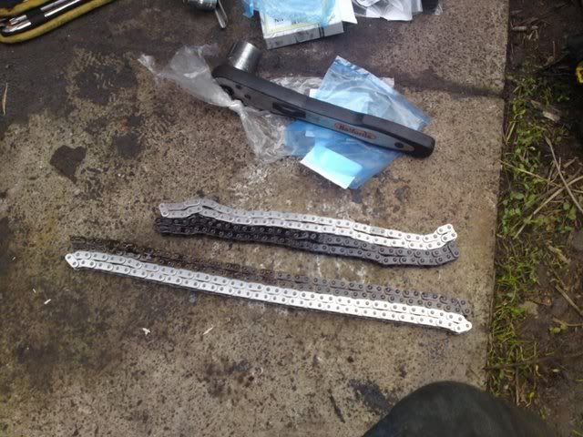

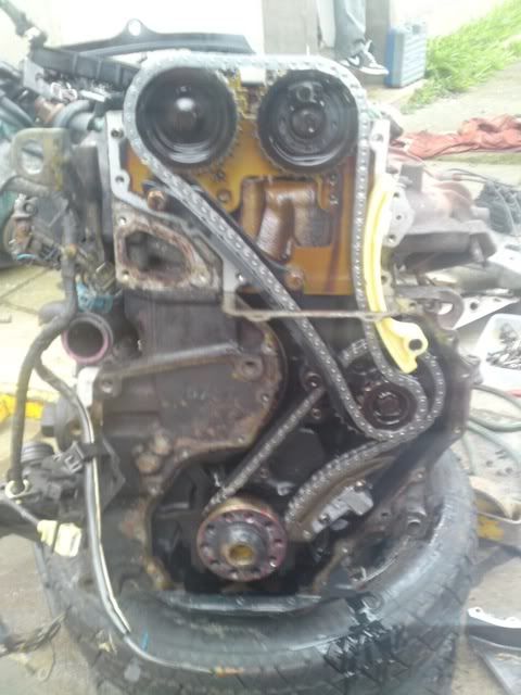

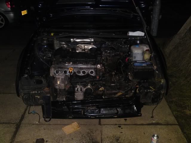

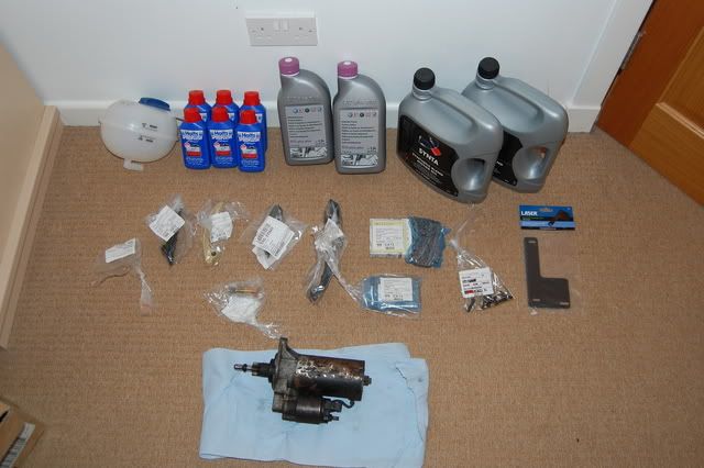

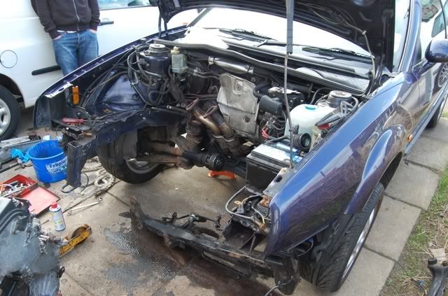

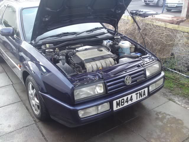

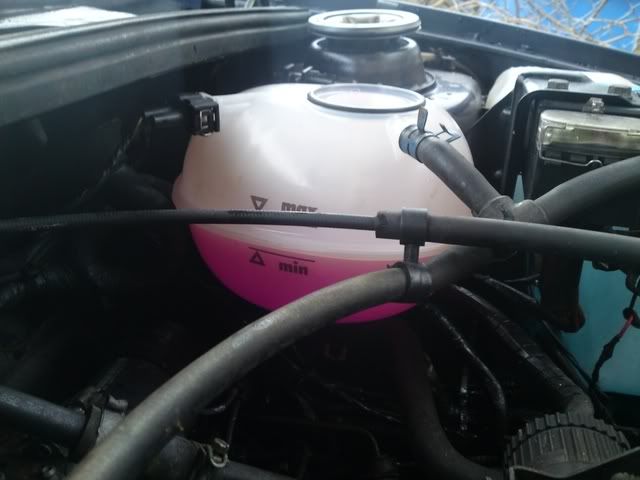

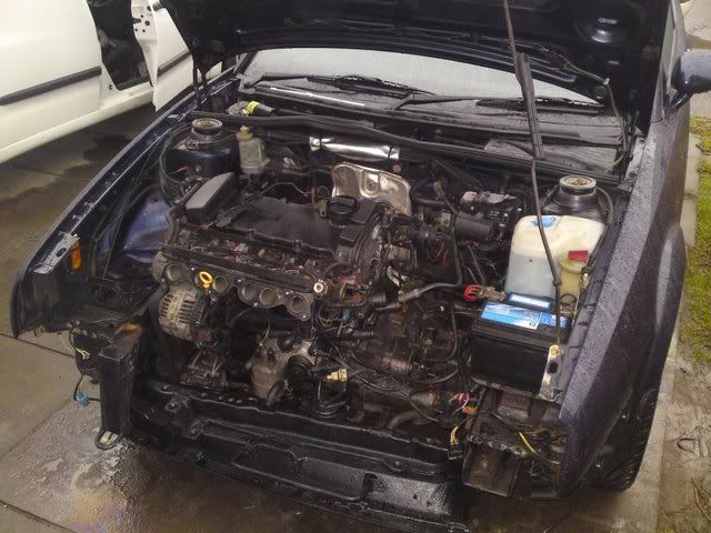

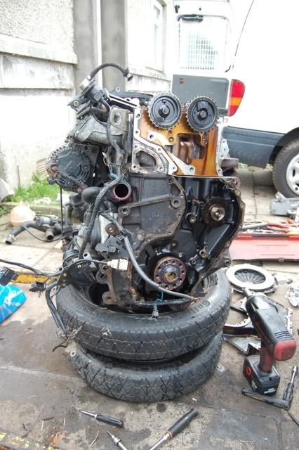

Scott-mk3 0 Posted March 19, 2011 So managed to get the chains and all that done today. Nice sunny day thankfully. Got it all back in and just need to finish doing the cooling system in the morning with new coolant and bottle. Started to take pics and after only 3 pics my battery died! Had to just use my phone as wanted evidence that they had been done as well as parts receipts. Nice fresh new parts and oil in it now. Took the sump off and cleaned out in there too while i was doing it all. Any way let some pics do the talking. Finish it off tomorrow so its back on the road and i can set about cleaning the whole thing inside and out. Going to take the inlet back off later and freshen it up. Cams all locked in place: All the old parts off: Old VS new No more new parts packaged up All the new parts fitted waiting to be cased back away. Back in she goes: Started to get a bit dark so whipped out the snap on lights to continue on for a bit but decided to call it a day a bit later on. Couldnt have went any smoother really,everything came off fine and back together no bother. All gasketed/sealed up as it should be. Chains themself are the easy bit fitting them its just the stripping and building back up that takes the time really. More tomorrow,hopefully find my camera charger for it. Quote Share this post Link to post Share on other sites

coullstar 0 Posted March 19, 2011 Out of interest what was the condition of the stuff you took off? Quote Share this post Link to post Share on other sites

Scott-mk3 0 Posted March 20, 2011 All finsihed off today but ill post up more pictures etc once im back in later on. To be honest man about the condition of the stuff that came off it was not bad atal. Me and my mate who was there,also a vw nut, actually thought should i of been chasngin them as they were hardly worn but on closer inspection there was a few small wear marks here and there. Wasnt expecting them to be bad though with the milage as my last VR had 132k on it and i never touched the chains. Polish wise ill post up what i use when i give it a good detail in the next few weeks. Mostly Meguiars, P21S and the occasional Autoglym products but im not 100% keen on them. Havent touched this with a machine polisher YET however shall be come the time i detail it. Need to order up some more compounds, this time will be Autosmart stuff as well however il be sticking to my well know and trusted stuff that iv used on other cars. Shall update this later on tonight with todays work. ---------- Post added at 08:45 PM ---------- Previous post was at 08:00 PM ---------- So now iv got round to uploading the pics. As i started this morning,nice and light again,sadly not as nice weather as yestarday. Still got on no bother though. Wasnt far off back together now. Started to give the coolant system a good flush out here seen pipes werent all connected up. Ran the hose through the whole thing to clean it out. Let it on one pipe and run through out the other. Radiator Back on,flushed out at the same time: Mmm Nice fresh bottle and coolant. Two bottles of VW coolant put into it and filled up. All back together,ready for the road again. Ready for its journey to girlfriends garage to keep it in now and give it a good cleaning session. Just a quick snap: Might be a few days or maybe next weekend before i do much more updating. Will be less mechanical work and more cleaning time. Wheels off,do in the arches etc again and inside of the wheels. Scott Quote Share this post Link to post Share on other sites
