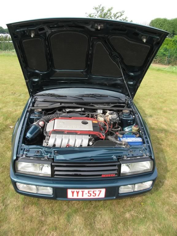

2.9VR6 contains recaro, shrick,spoonfed parts, carbon and a lot of custom build
'92 Volkswagen Corrado 2.9 VR6 192bhp
mods so far are:
- BBS RS 16" x 8j ET 35 with Pirelli P Zero Nero 195/45/16 with adaptors from 5x112 to 5x100
- Carbon Fiber Fan Cover
- engine complete checkup and new chain + sliders
- OEM volt/oil pressure gauges

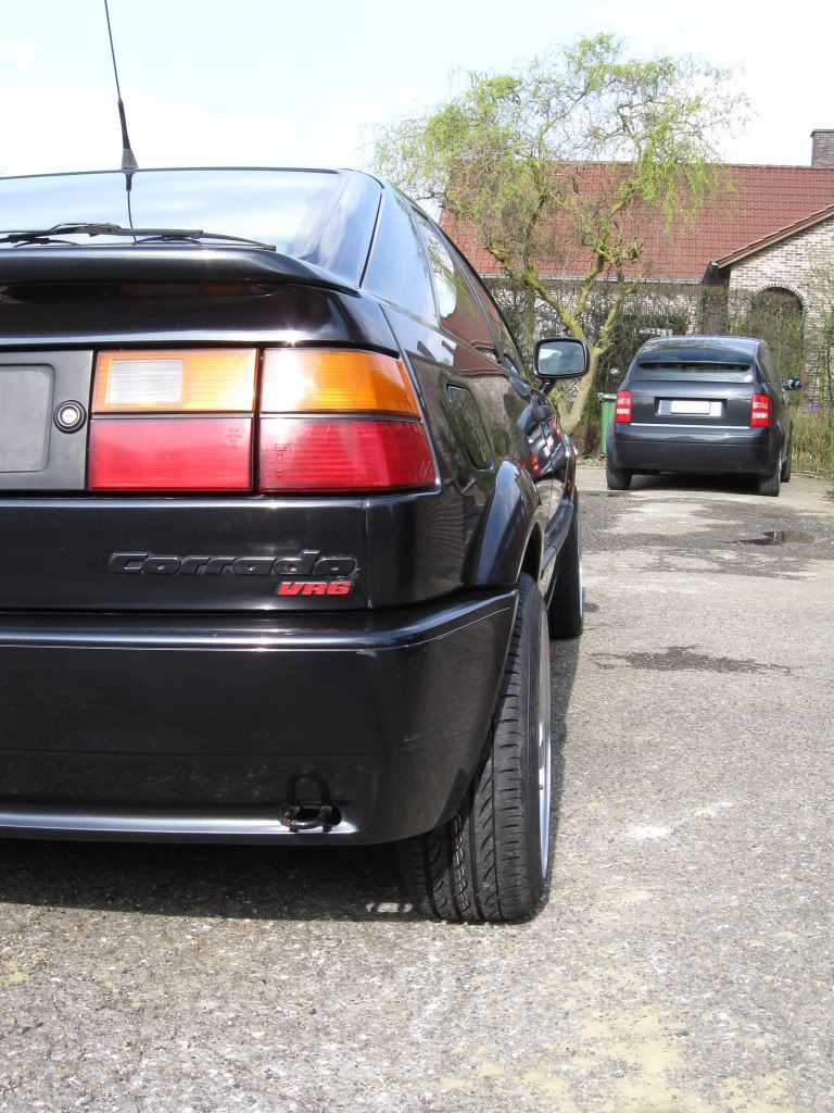

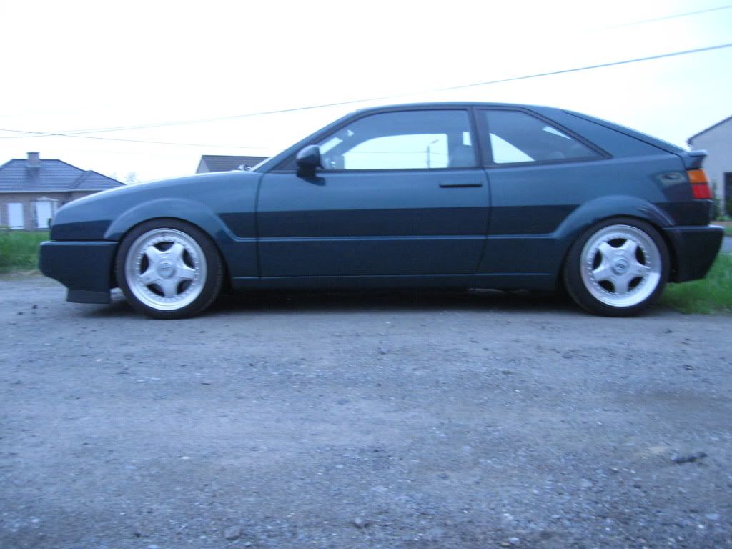

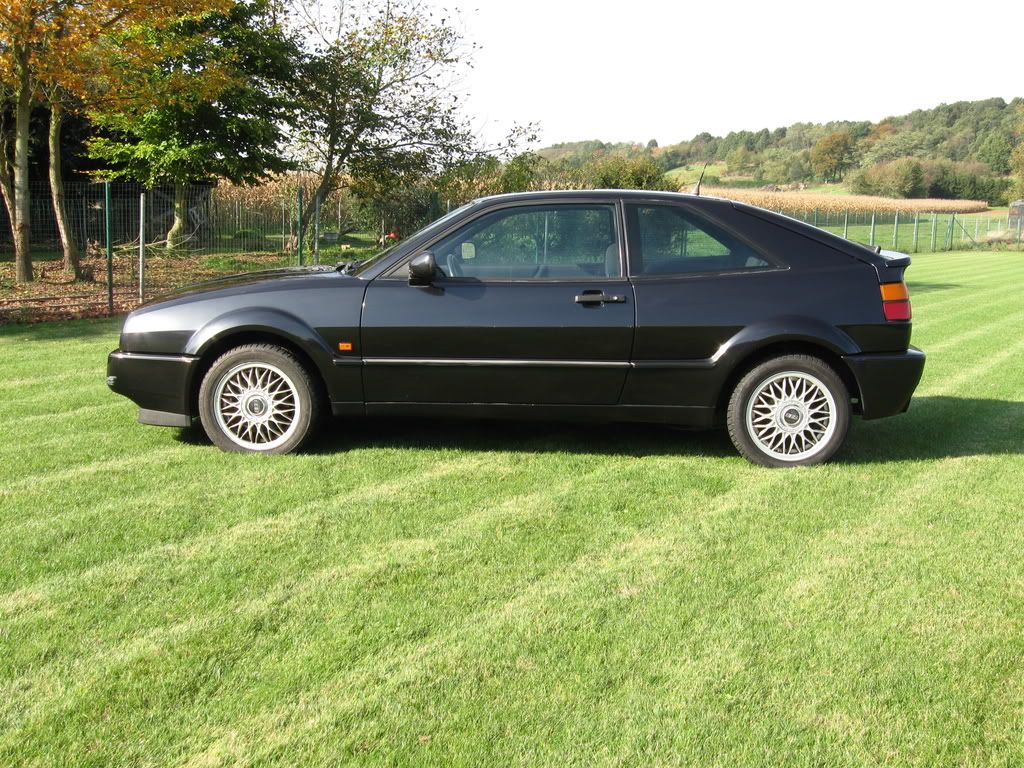

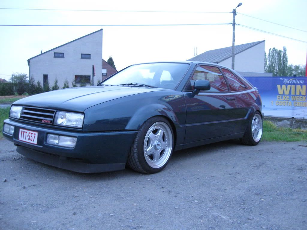

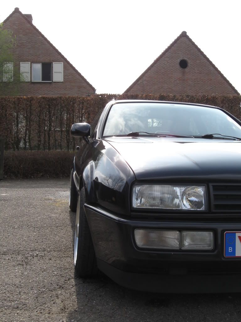

Fitted the corrado with Weitec coilovers & badgeless grill
i know it still can be lowered, but the problem is that my fenders must be rolled
fitted 4cm bumpstops at the rear, otherwise the tires hit my fenders

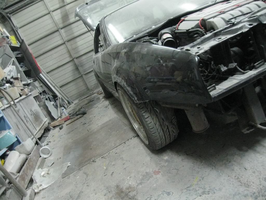

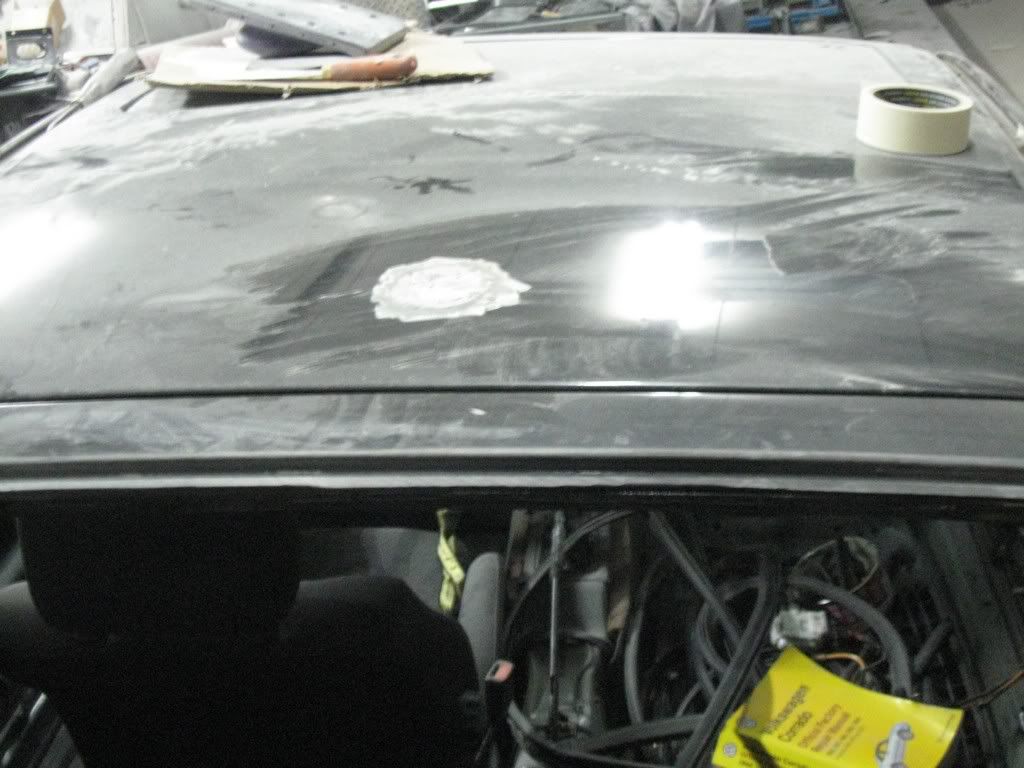

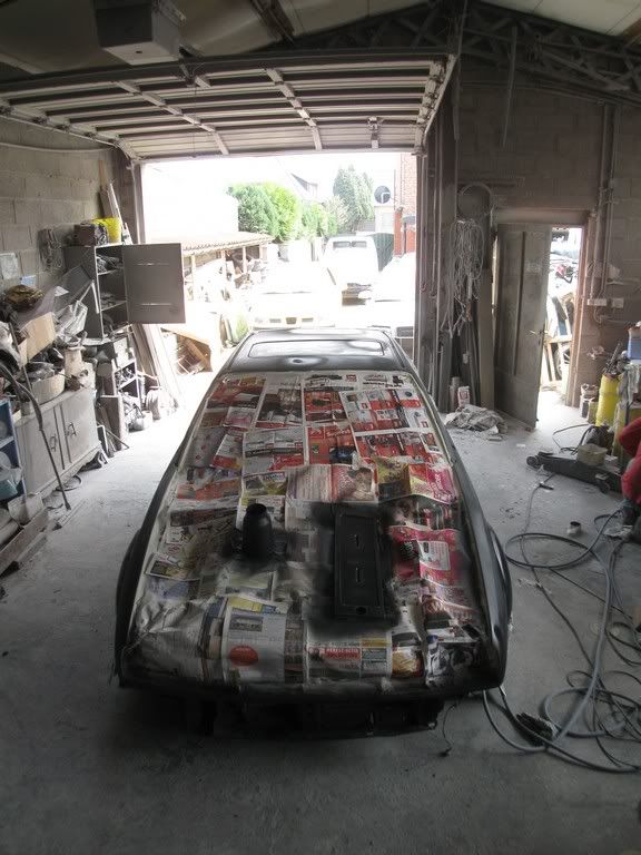

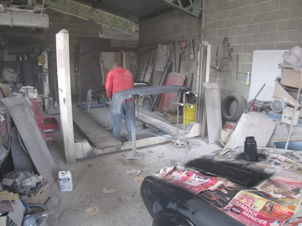

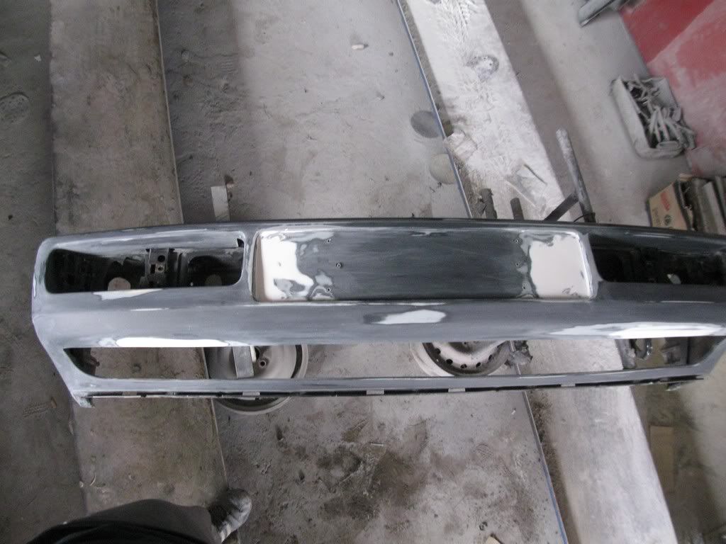

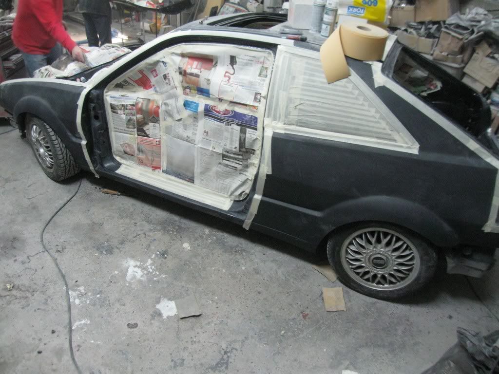

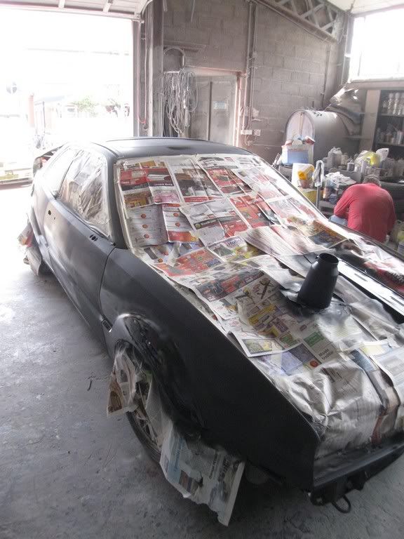

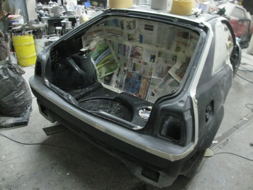

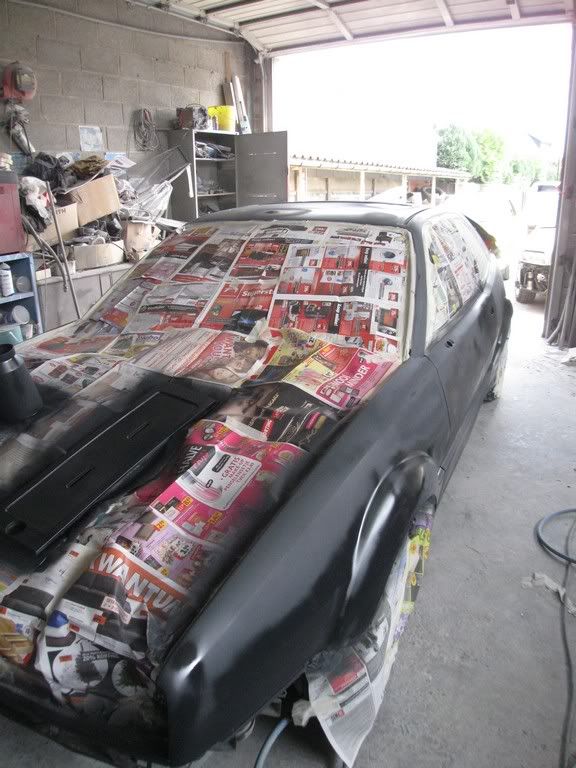

Prep'ed for painting
got rid of that horrible sponge wrapping, changed it into linnen
ready to go the bodyshop

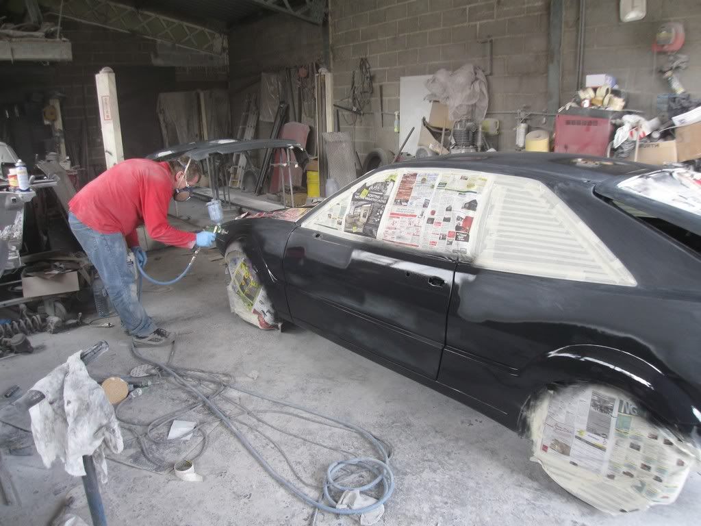

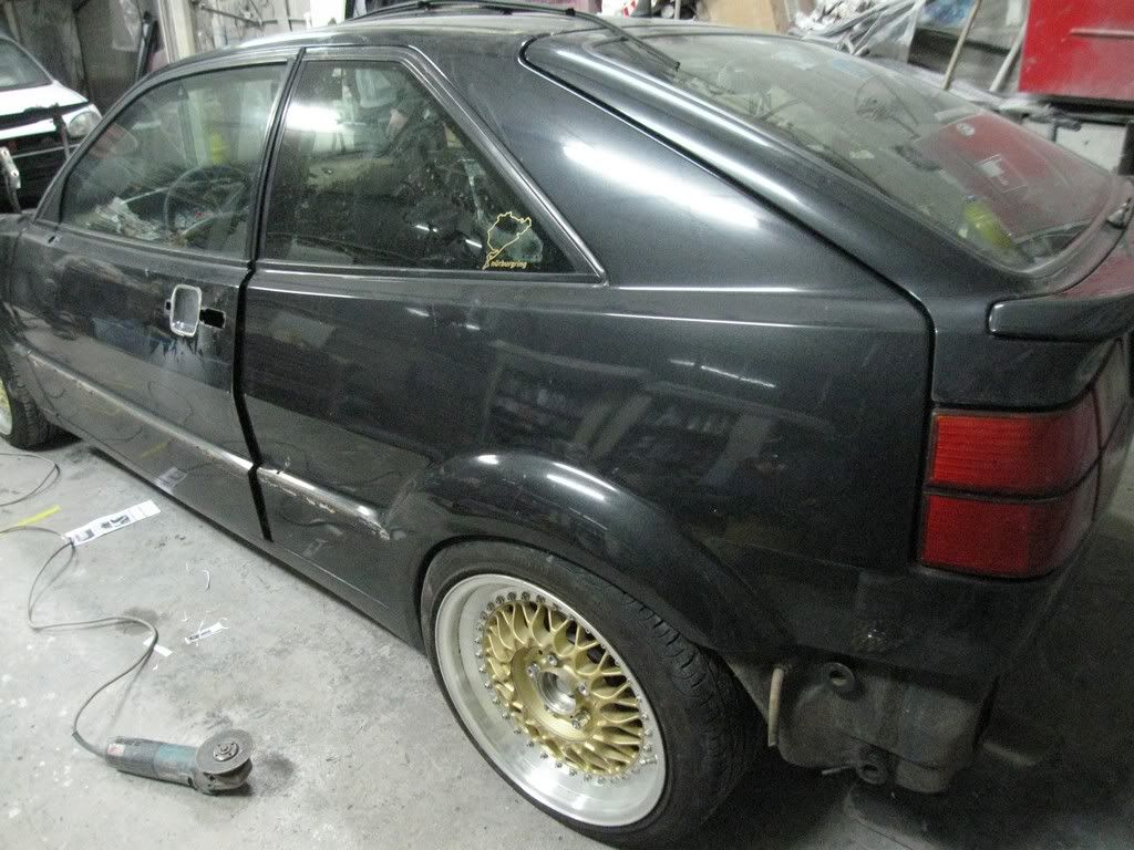

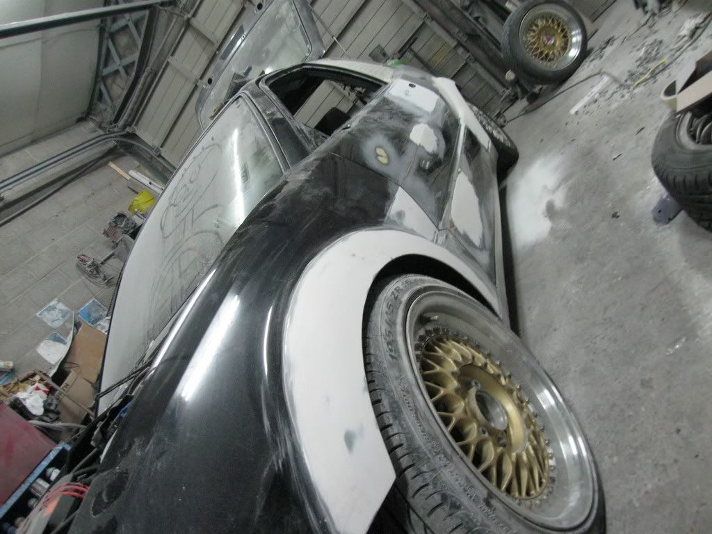

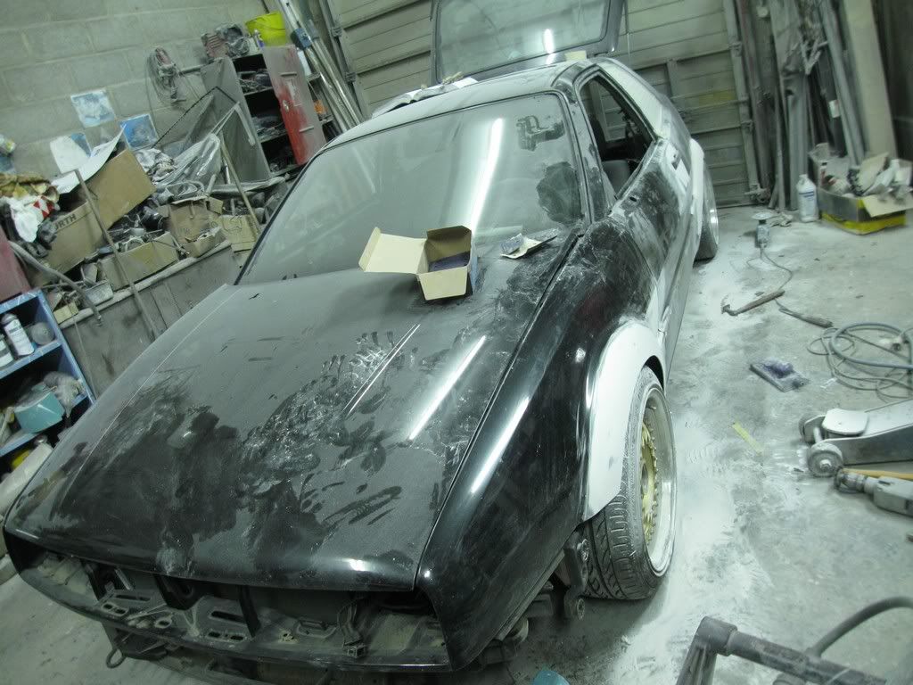

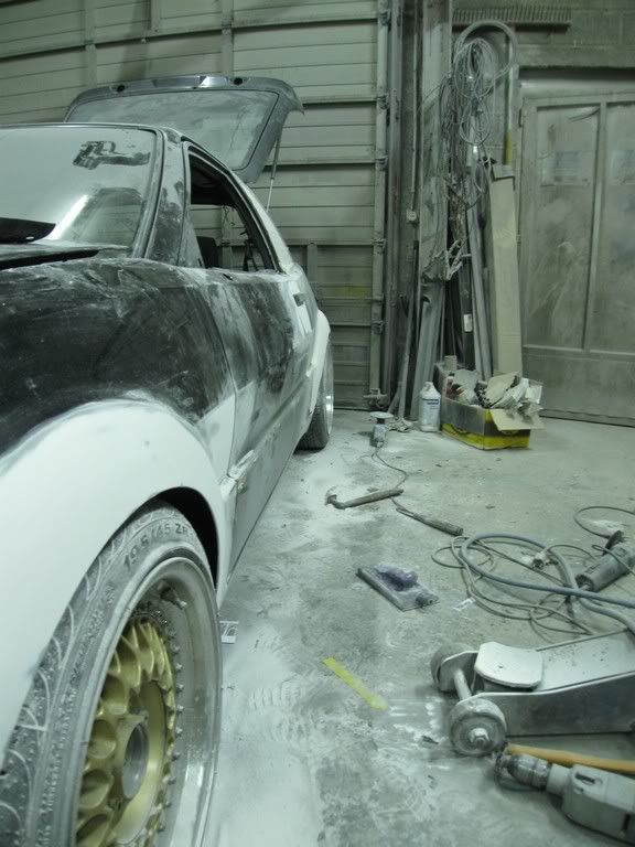

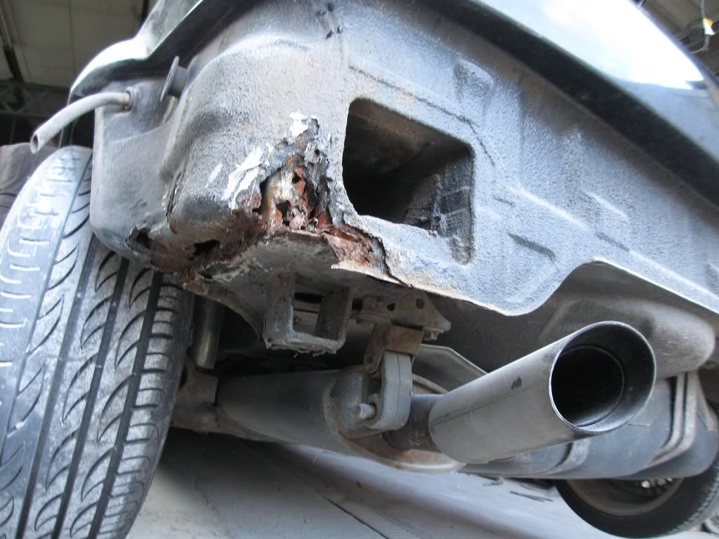

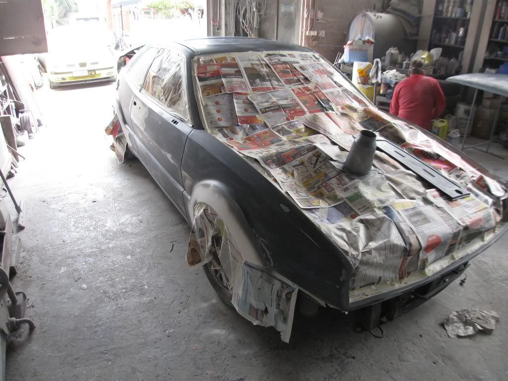

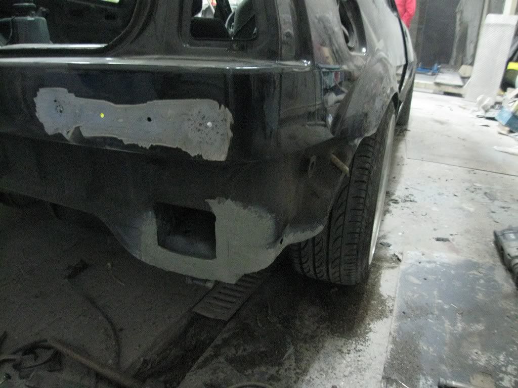

2010-05-03 Day 1 @ bodyshop
2010-05-04 Day 2 @ bodyshop

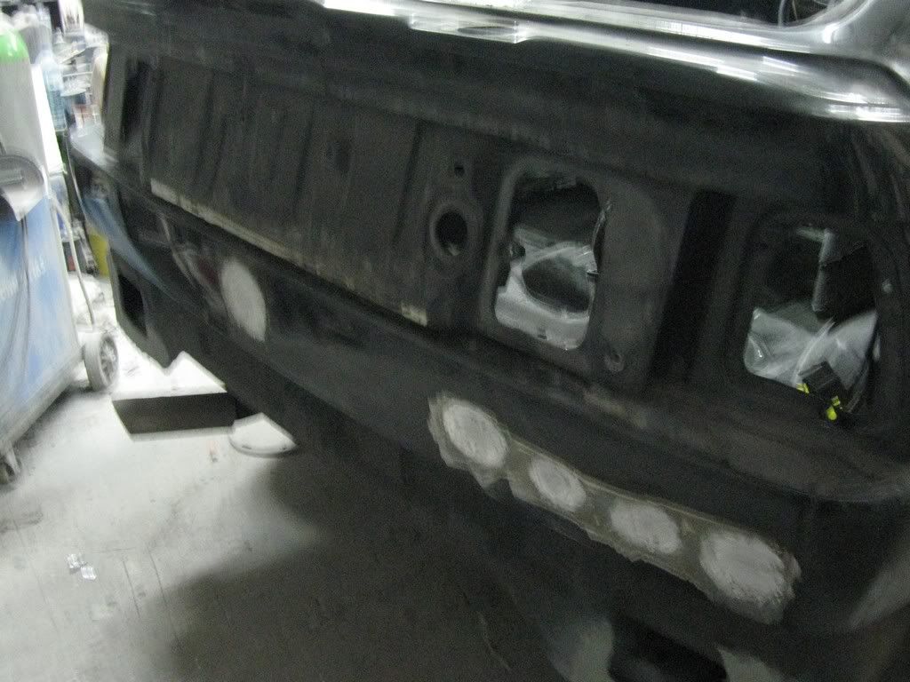

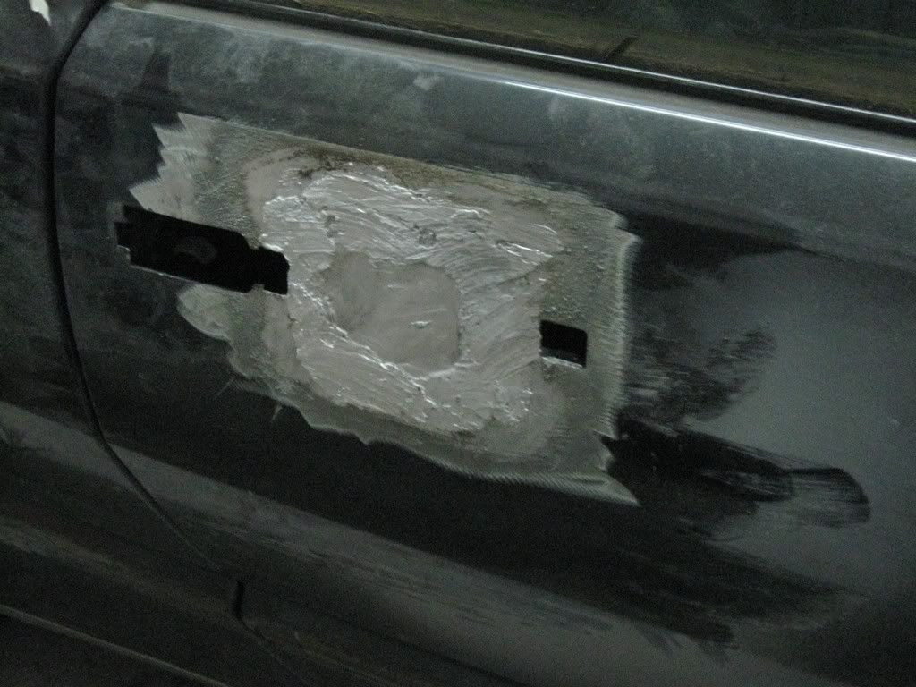

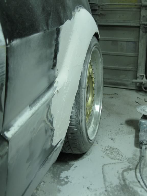

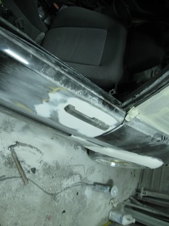

fender working & sidemarker deleted & door handle reccess filled
2010-05-05 day 3 @ the bodyshop

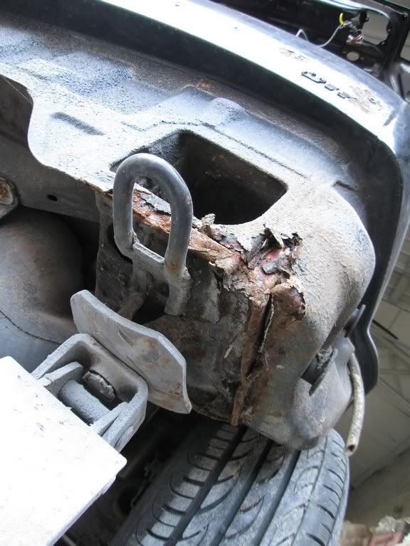

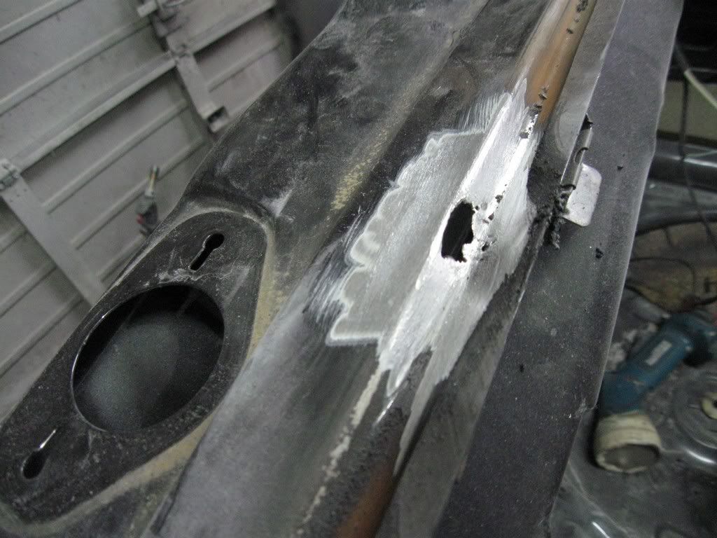

more sanding & ugly discovery (been taken care off)
Sam

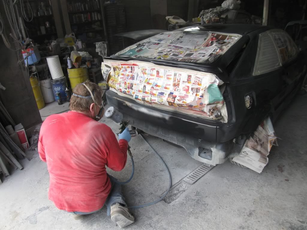

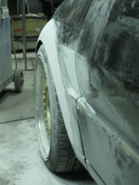

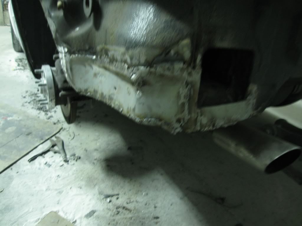

2010-05-06 day 4 @ the bodyshop

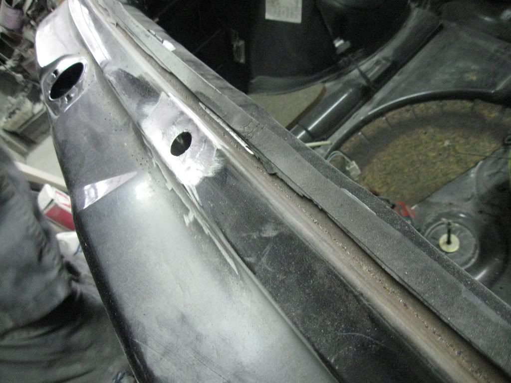

repaired other side + fender working on other side + door sills smoothed on bith sides
2010-05-07 Day 5 @ bodyshop

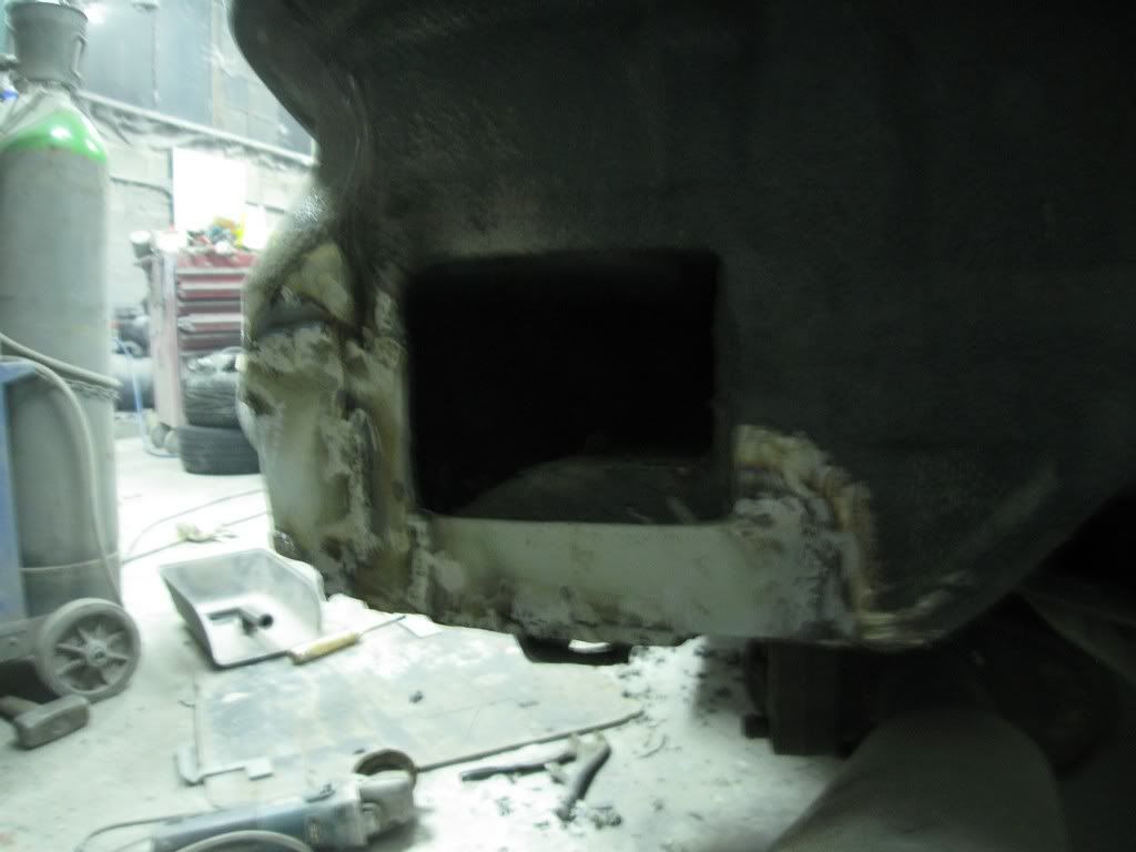

The last bits of rust removed other side side marker and handle door recess welded
arial and rear wiper deleted

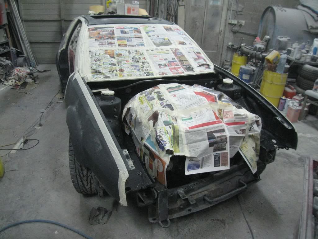

2010-05-12 day 10
everything prep'd for door entries, trunk and engine bay gettin painted
the finish line is in sight, finally

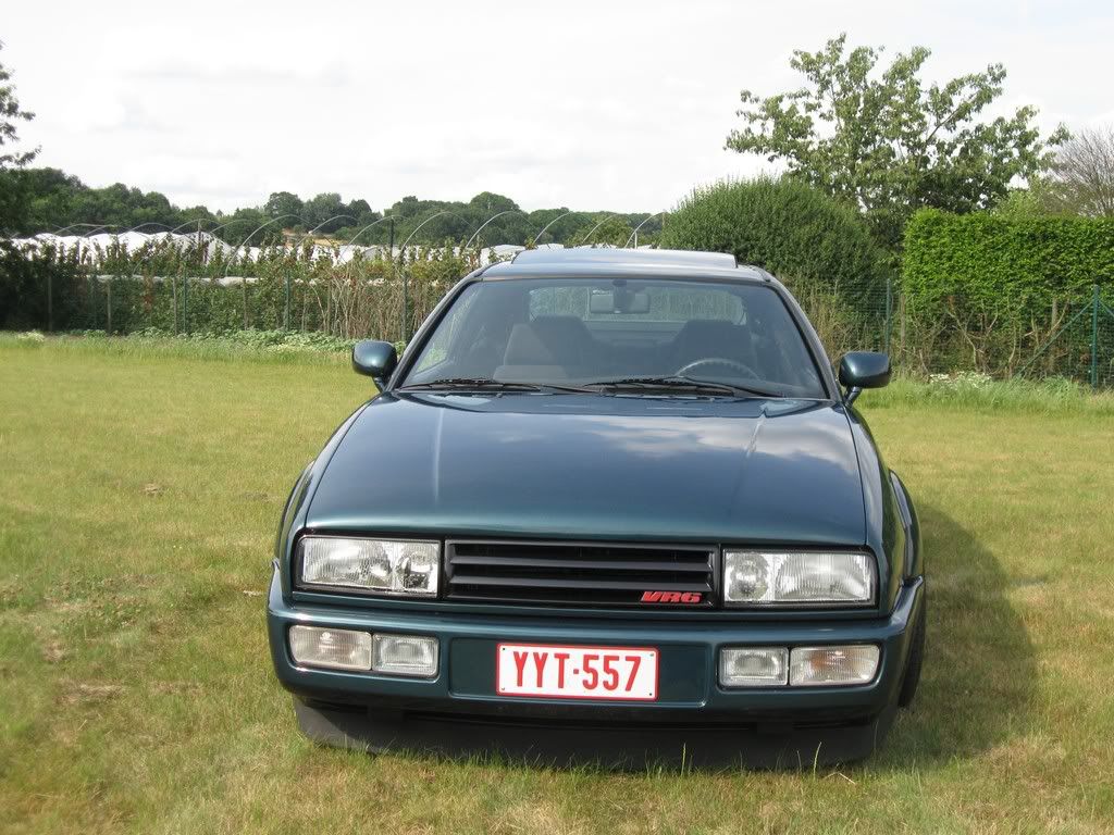

it's painted

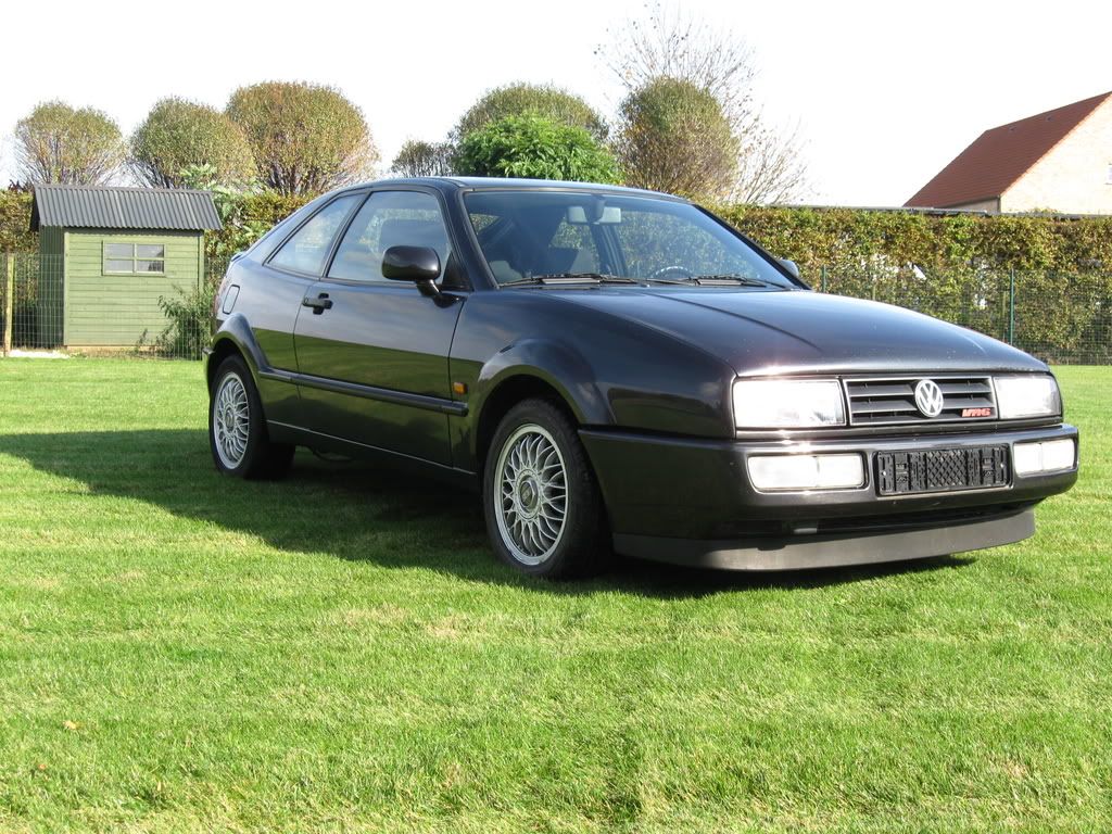

first pics:

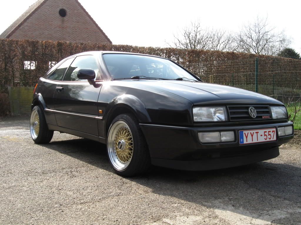

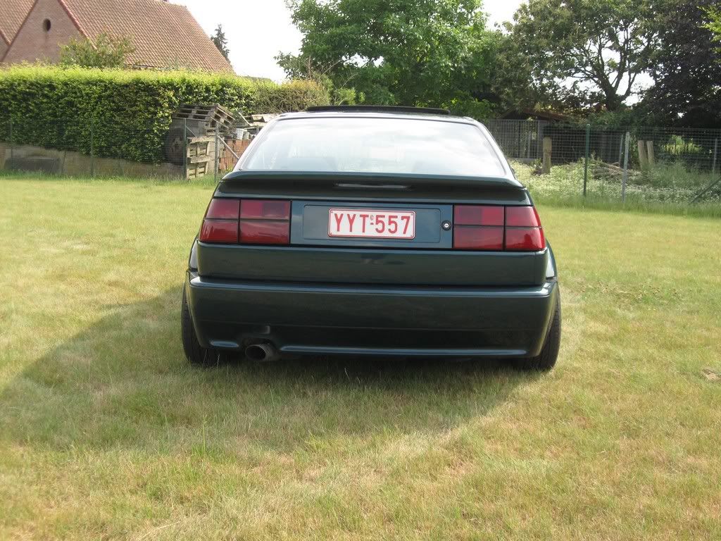

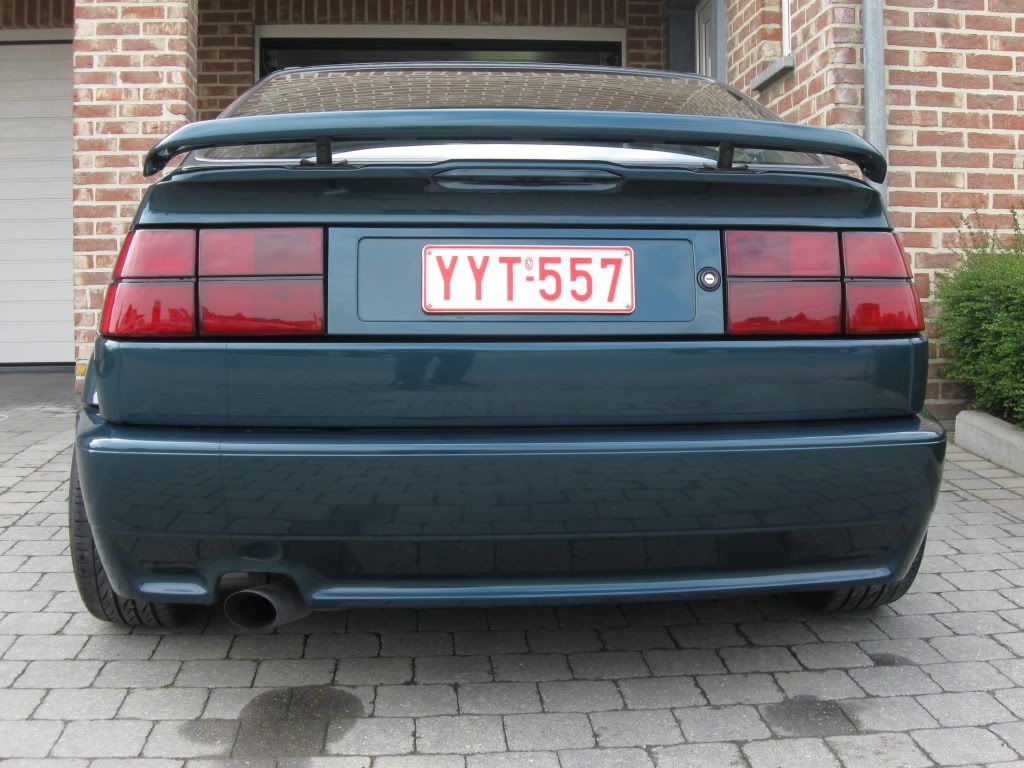

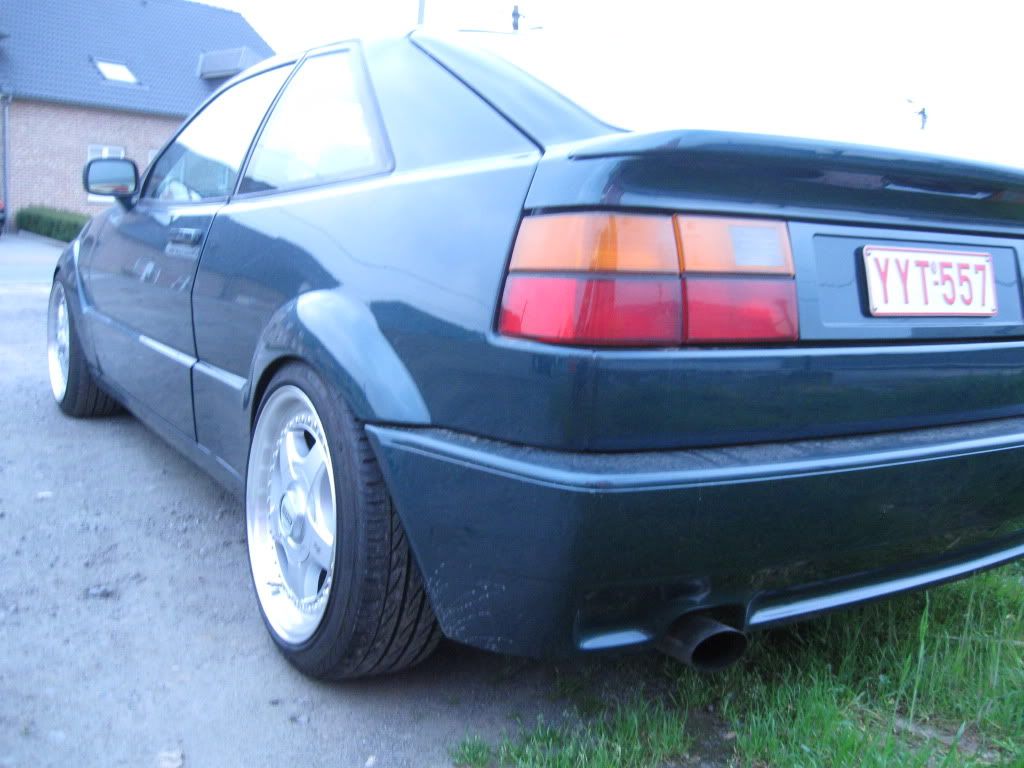

finished product:
cleaned the car and added cambershims in the rear
And took a small photoshoot
Hope you Guys and Gal's like it

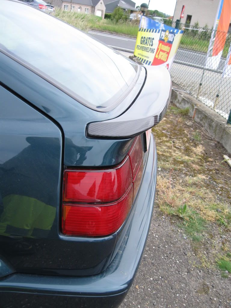

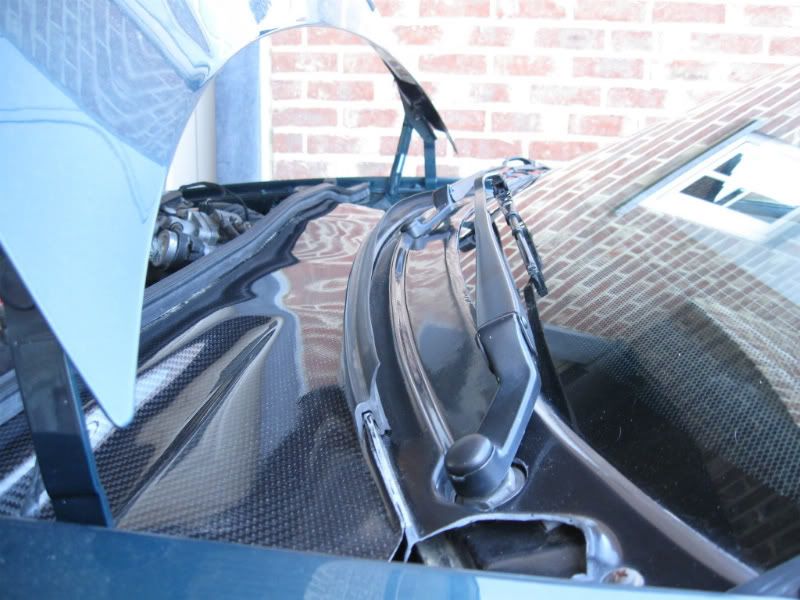

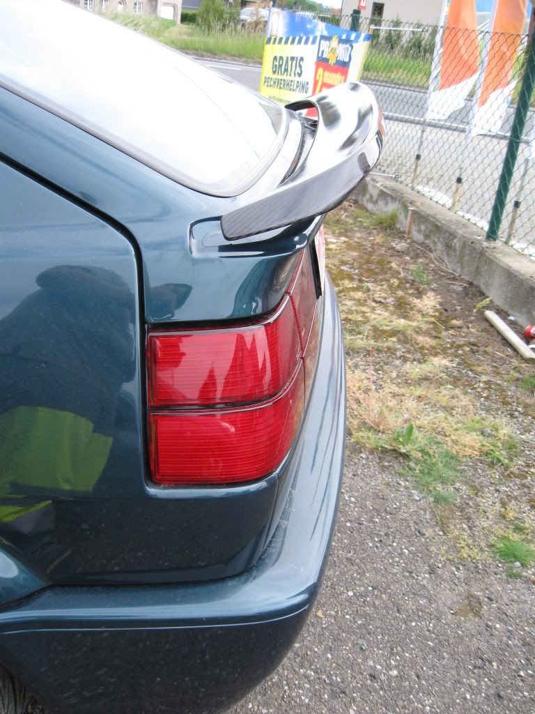

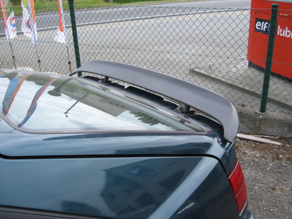

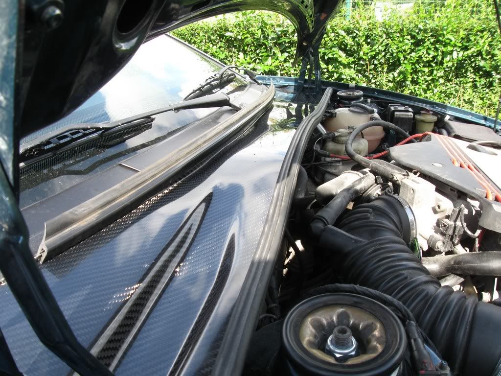

Pictures from the first owner of a CF rain tray in Europe.
after 30minutes, it looked like this:

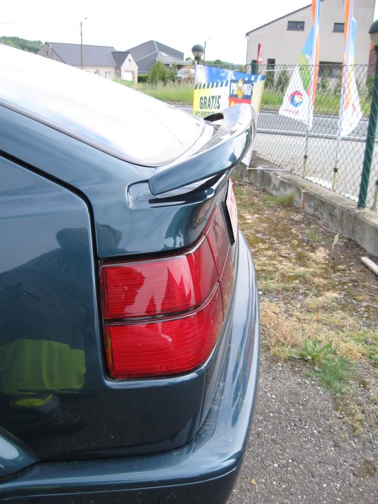

@ Edition38 I left my rear light with platinum ice paul
found a pic @ ED38X

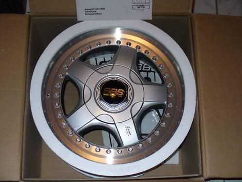

Saw them on ebay Germany, could not resist to not buy them.
offset and pcd is the same as the RS'es so stance will be the same.
If i want to go wider on the back, I have to redrill my hubs to 5x112.

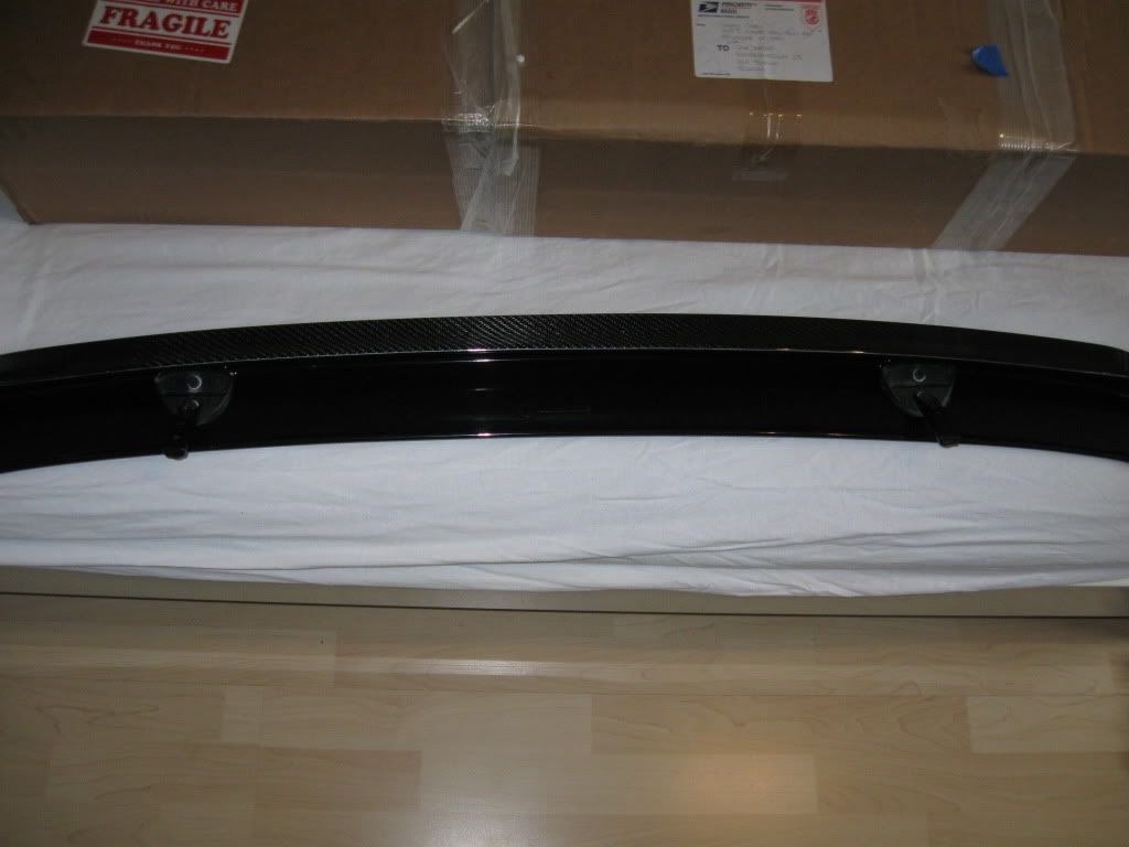

finally after almost 2months waiting, I've got this
in the meanwhile i've added some extra carbon stuff
pictures when it's installed will follow

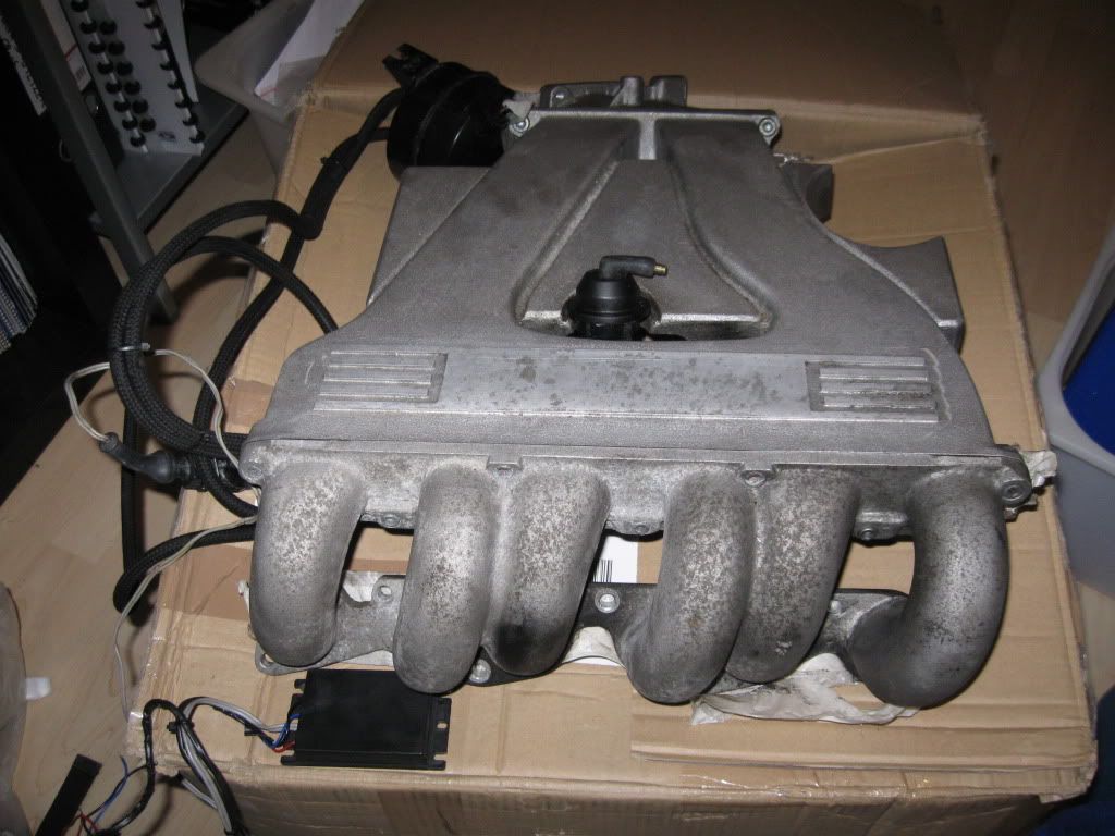

what could be in here?

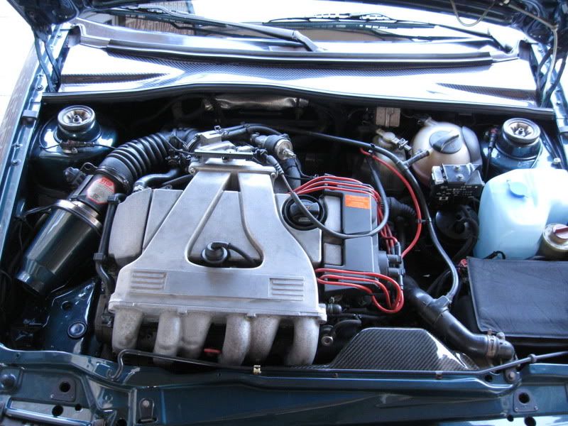

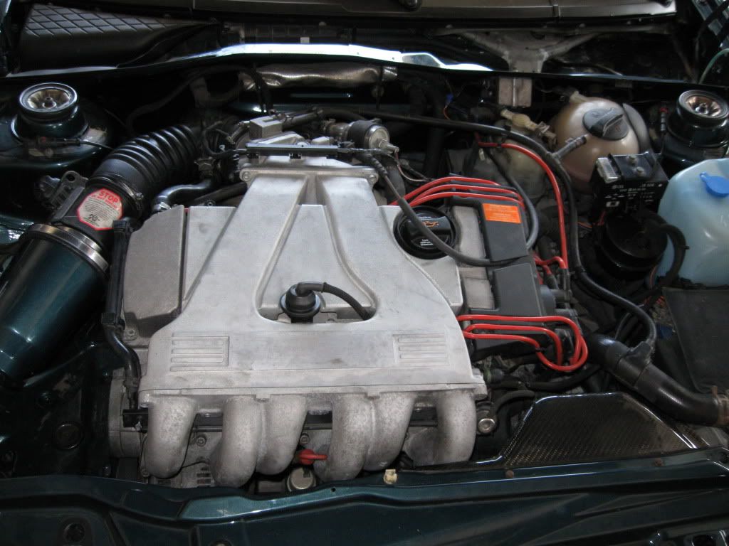

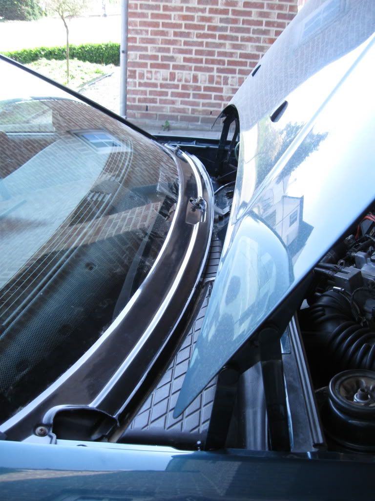

Original Debagged Schrick inlet manifold
:heart::heart::heart:
can't wait to install it, more updates to follow...

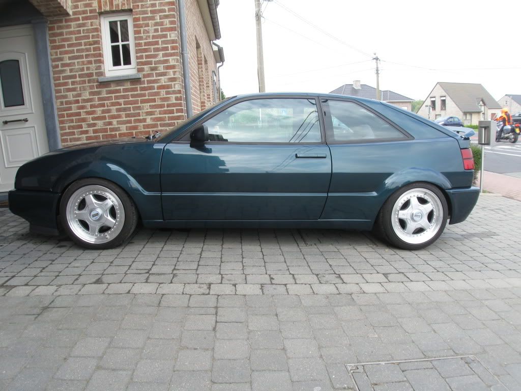

Annual inspection done today with no remarks
already lowered again and My new Rims :heart::heart::heart:

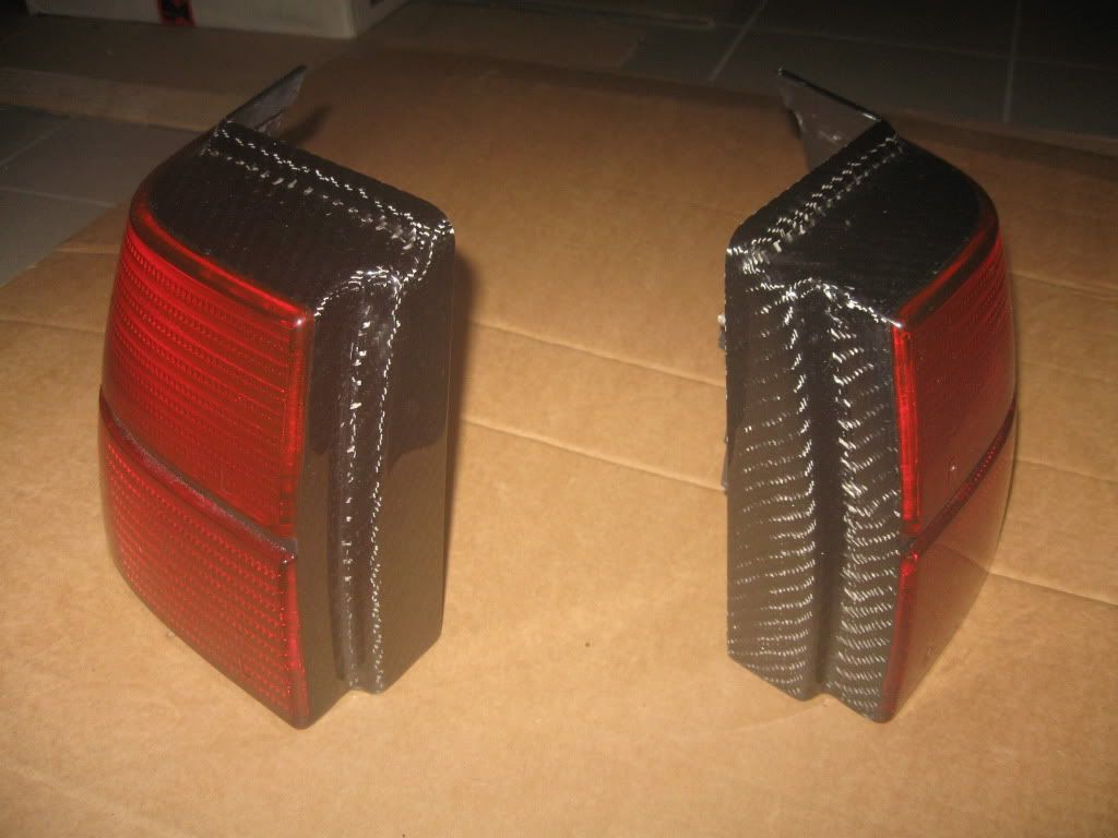

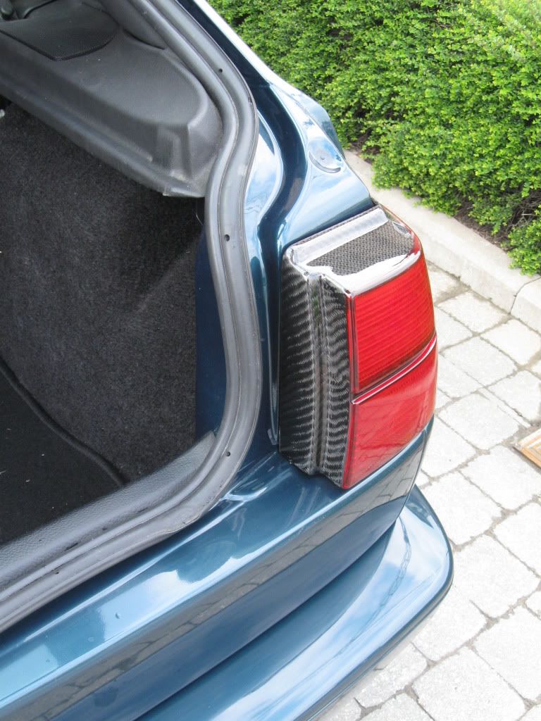

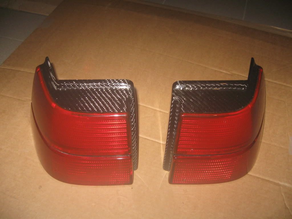

very good work, what have you used to do carbon lights ?? was it carbon look wrap, like 3m ??
awesome work so far, such a transformation. must saw im not as keen on the new bbs but still looking good. lines are so smooth and tidy! think i need to paint my door handles when i get my rear end sprayed, look spot on! good work :)
thanks for the comments. rims looks better irl, still have the RS's if i want to change back but i like it now :D

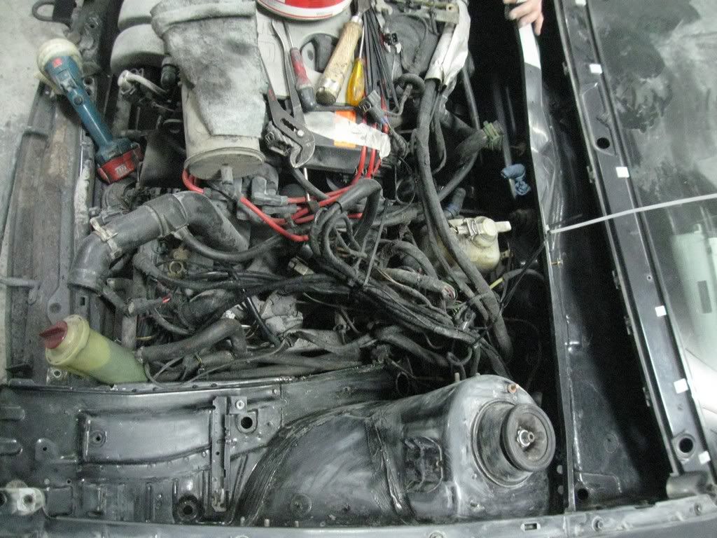

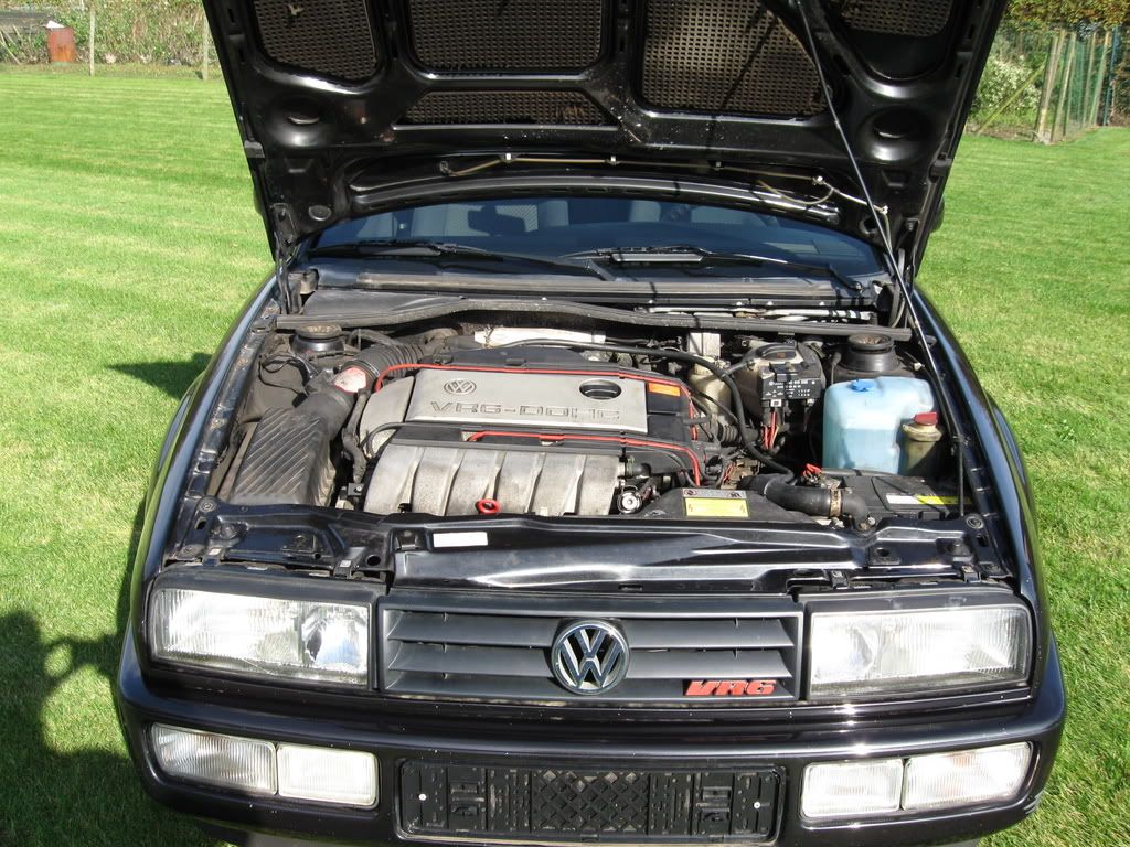

had some work done 2day
prep work

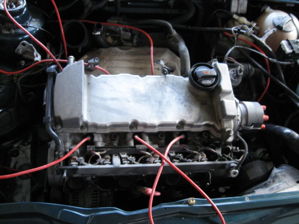

removing inlet manifold
installing schrick manifold
installing sft windshieldtrim
tyding everything up
Sam
oh yeah, love the sound and reaction in low revs with the schrick manifold.
