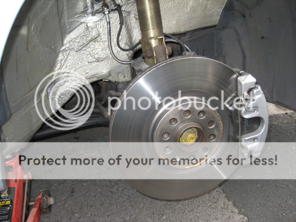

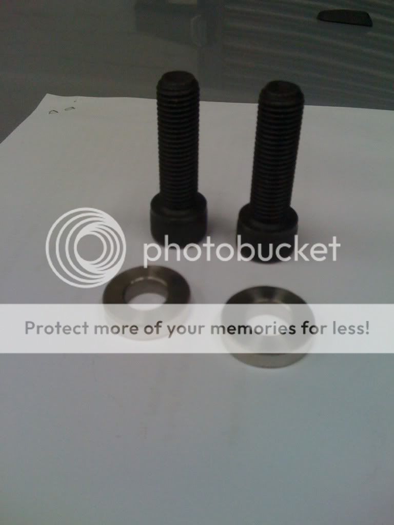

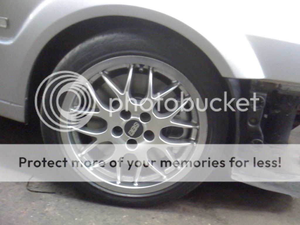

Some more progress on the car today, front end is built back up and front bumper is painted and ready for collection tomorrow. Had these bespoke spacers made for front brakes and are fantastic quality and a perfect fit.

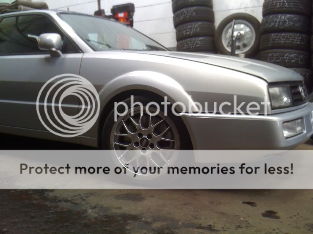

Still waiting for Goodridge hoses to arrive, but test fit with old wheels looks great...

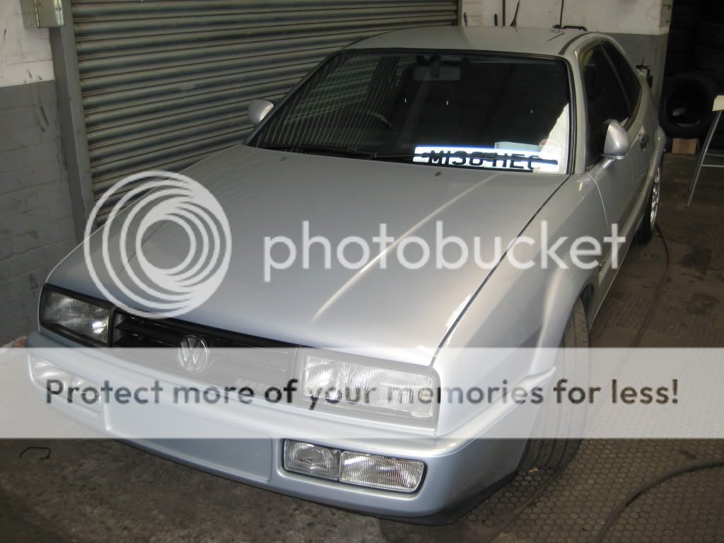

Some more progress this morning, front bumper is back from paint, looks great and back on the car!

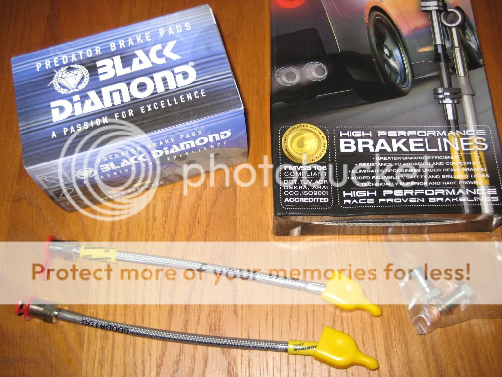

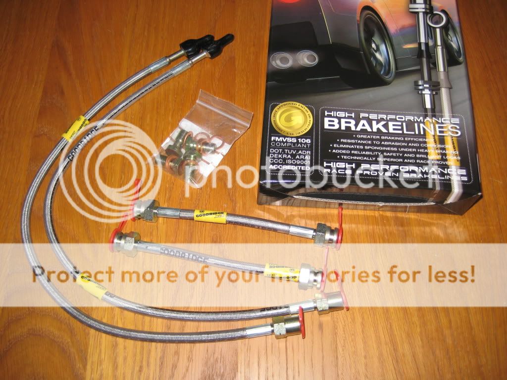

Having a nightmare with the Goodridge 312mm and Mk4 brakes hose kit from C&R - out of stock for a week so we can't complete the brakes! chasing round for alternative suppliers now...
... after trying several places for the Goodridge Hoses a massive thanks to John at C&R in Nottingham who has split kits and got the fronts this morning with the backs coming early next week! :)

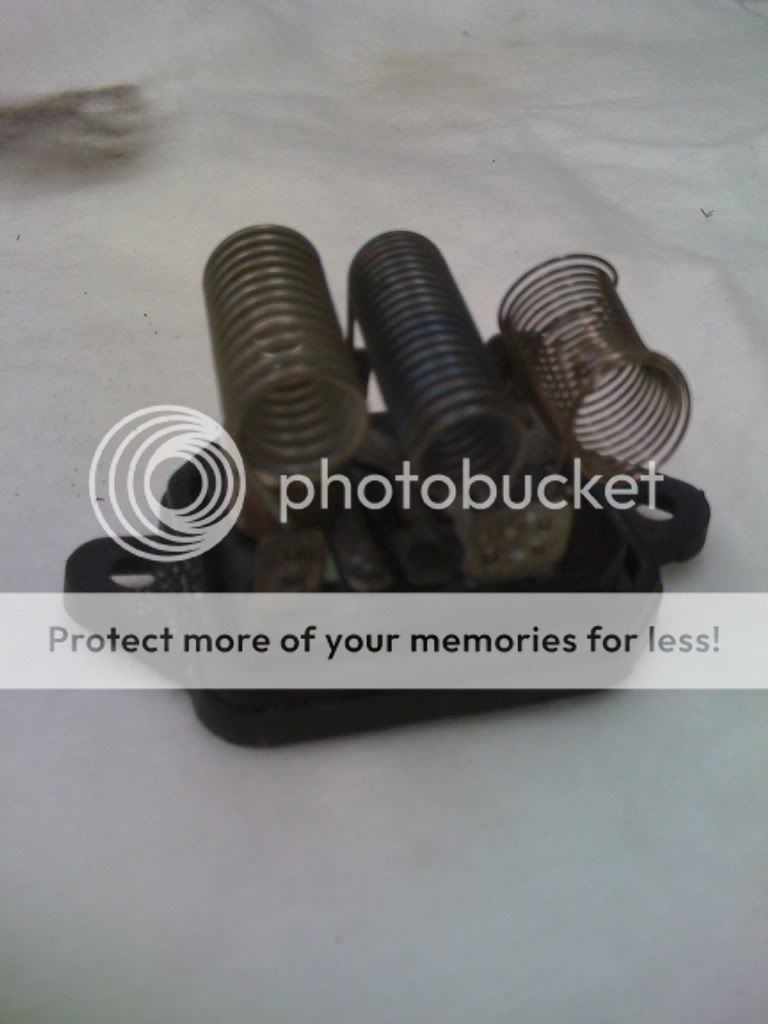

Also looked at why the heater only works on setting 4 and found the heater resistor is from a Fiat/Lancia! its been scrapped and looking for a new one.
so you had aircon in yours? The normal heater doesnt use the lancia resistor only the aircon handling units. That said, i replaced mine with a 'normal' thermal resistor and a few years on its still running perfectly.
Yeah has aircon, looking at best options... :)

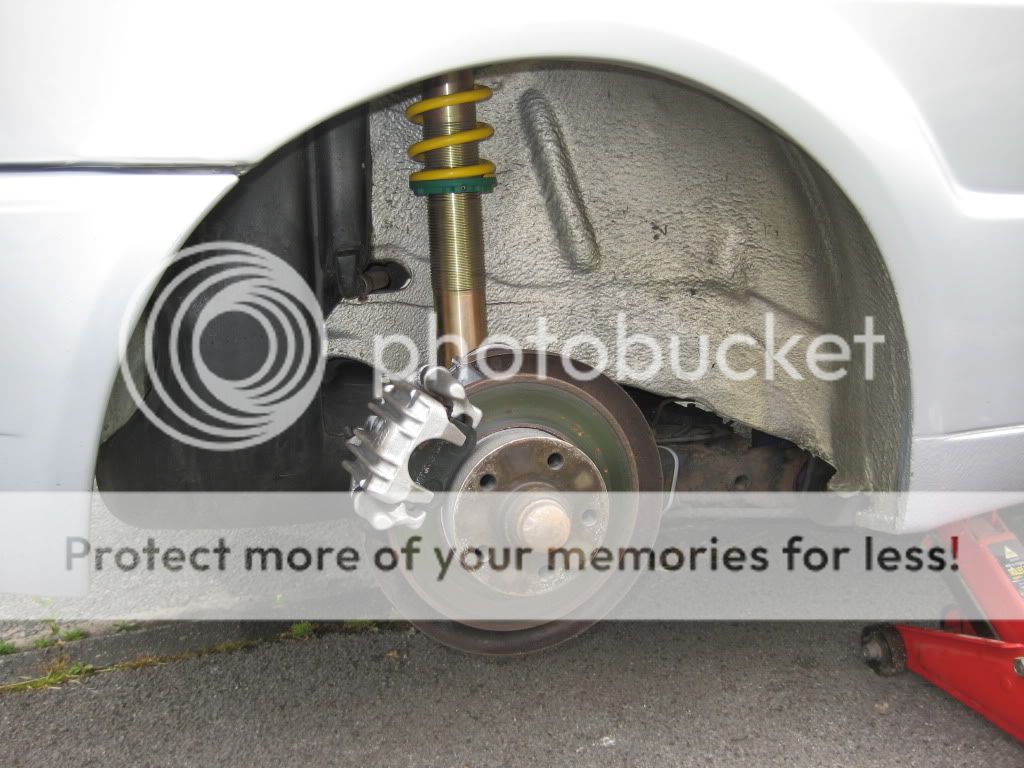

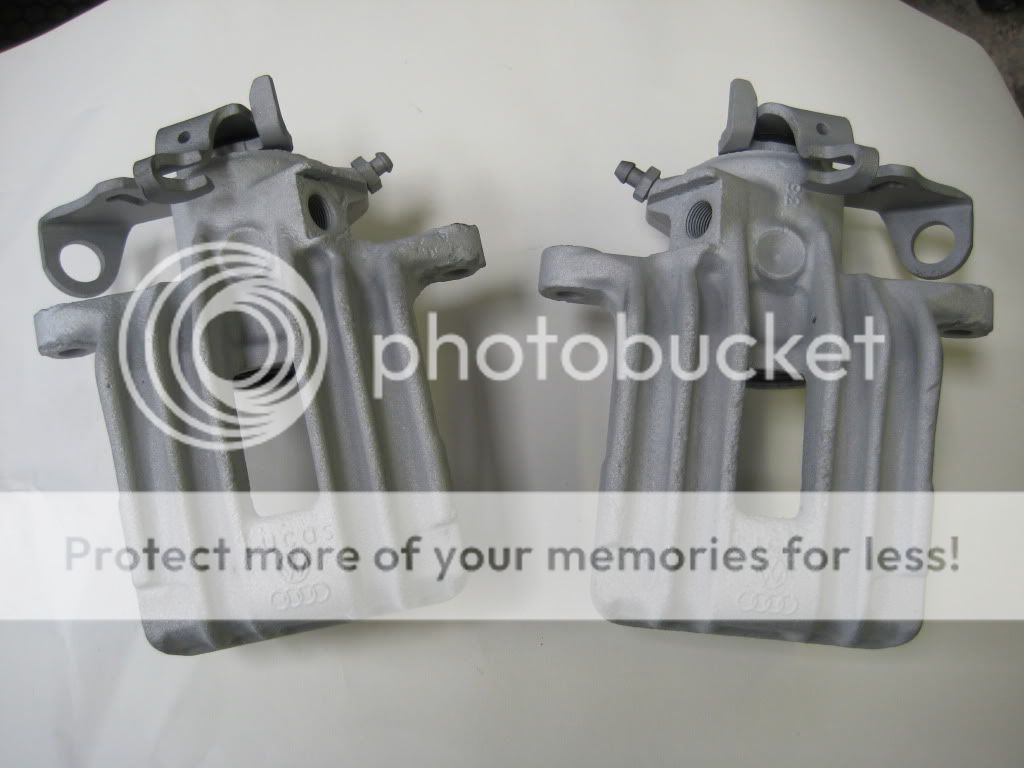

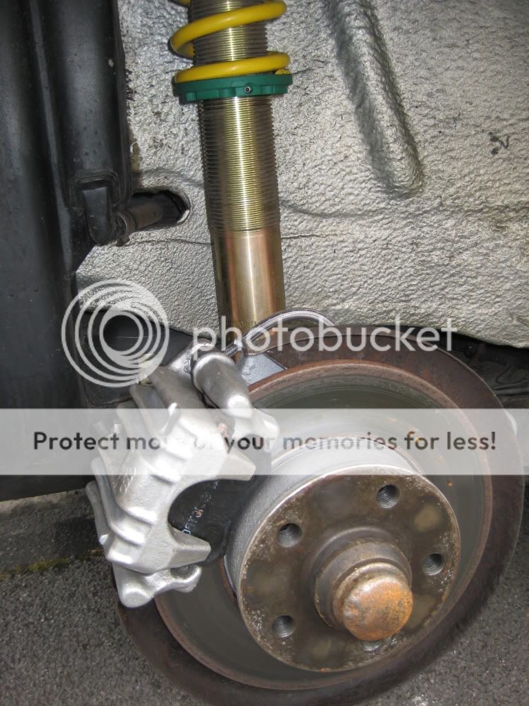

... quick update, rear calipers are back from being shot blasted and ready for paint.
Fronts have been on for a few days but can now be finished now all the hoses are here.
Car has that nice workshop coating of dust, but should be back on the road in a few days! ;)

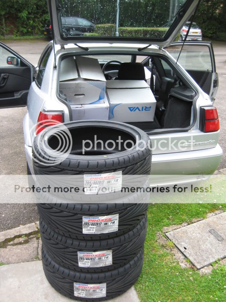

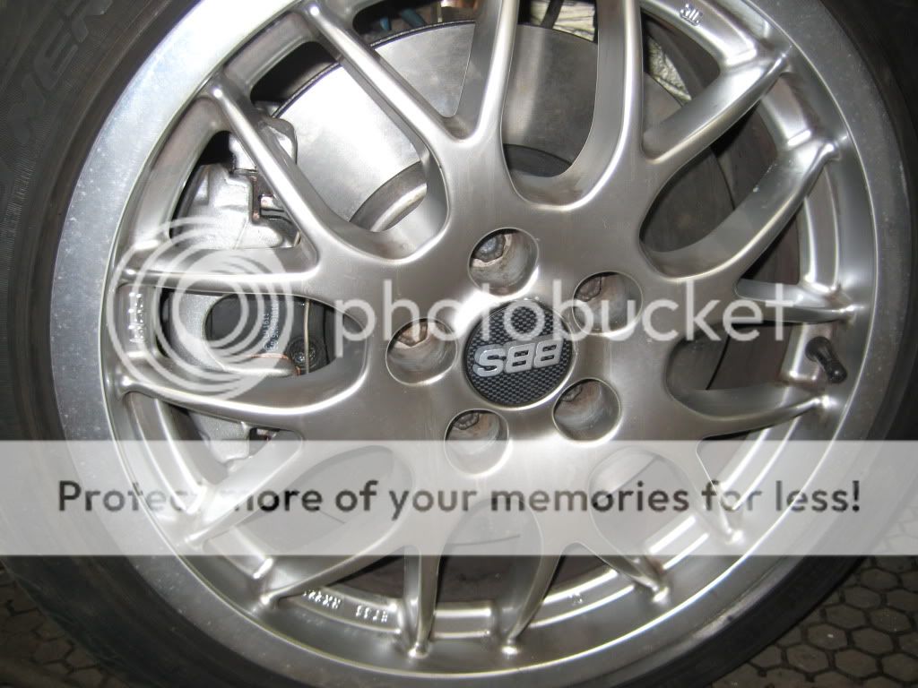

Car now back from the workshop, brakes all finished, still a little too much travel in the brake pedal, but another bleed should fix that, bonnet adjusted after front end rebuild so now time to start adding the goodstuff before the trip to Inters. New tyres arrived today too, went for Toyo Proxes T1R 205/40/17 so just need to get them on the newly refurbed rims. Weather's been crap so started stripping off the rear tonight ready for cleaning tomorrow...

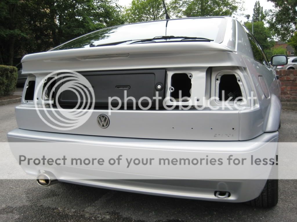

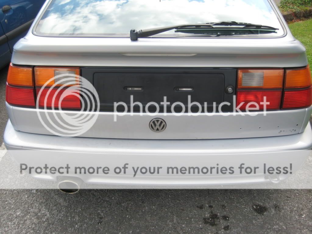

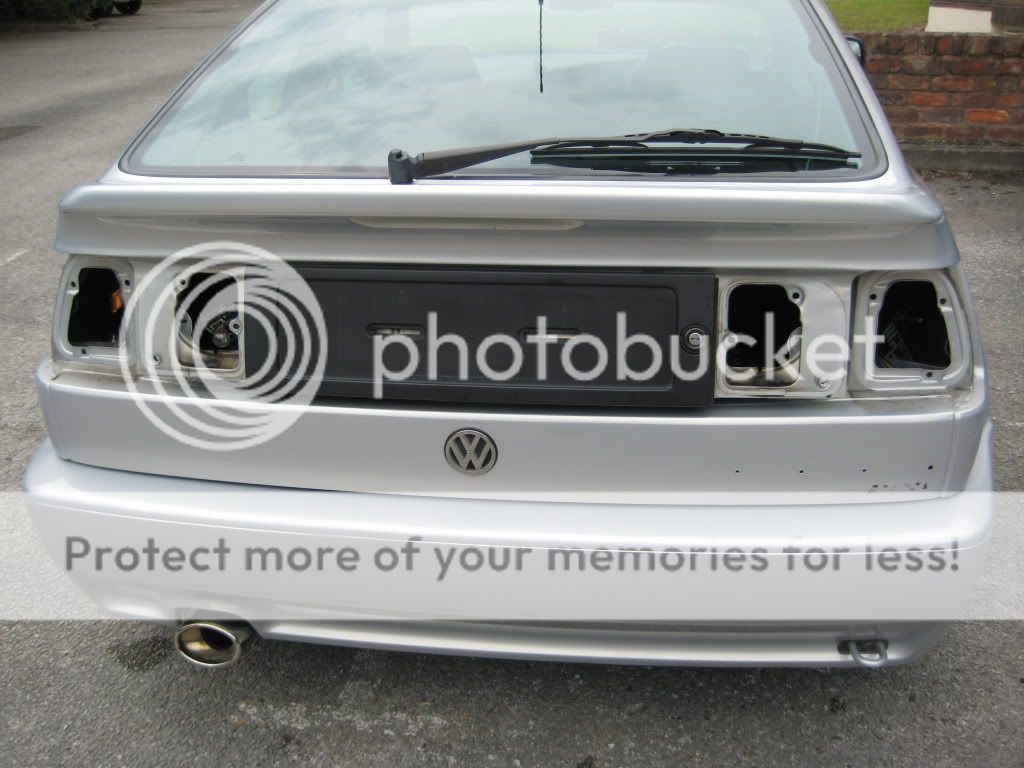

Half day today and carried on with the rear upgrade this afternoon...
Then all cleaned up
Then time for the good stuff
More work tomorrow! ;)

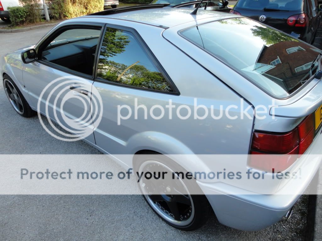

Well it was all a bit last minute rush, but here's how far we got the car before taking it to Inters today...
Then getting rims and tyres all together.

Did you take the rear brakes apart yourself, what tools do you need? I have a set of 288s for the front that I want to get blasted (so I can paint them) before I fit them.
Edited by OllieVR6
Car looks tops mate!
Rear brakes are fairly easy to split these are Golf Mk4 GTI rears, but you have to use the original Corrado VR6 carriers and discs, we then bought new pads and rebuilt with a new seal kit. Will likely change the discs soon too, so everything is brand new.
