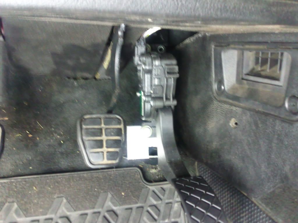

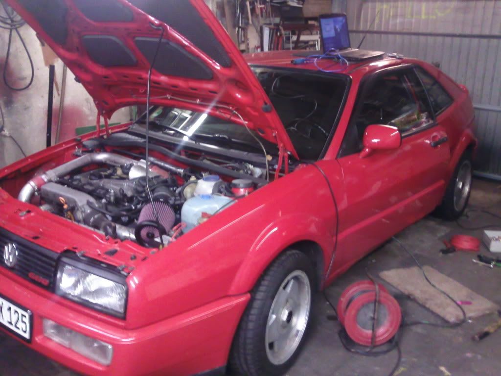

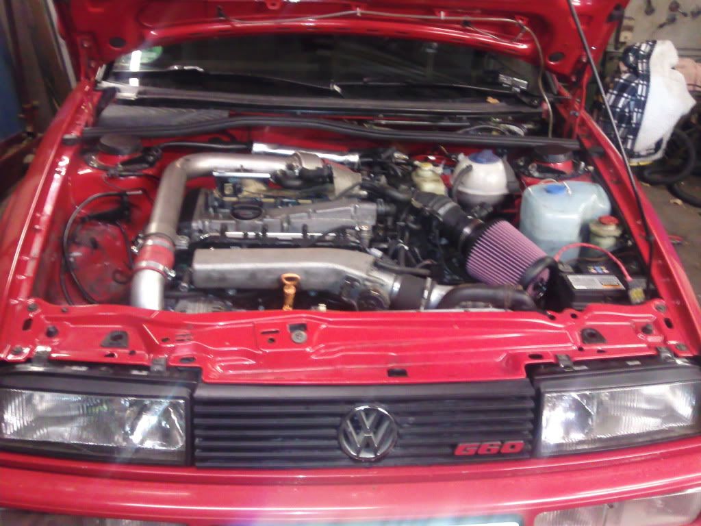

dannyboy 0 Posted November 26, 2011 Well more time in the garage.... The misses is getting annoyed that i spend more time in there than in the house.Told her she goes before the car...Im currently walking around the house dazed with a head shaped dent in the frying pan that the wife uses more to 'educate' me more than she cooks with it. Oh well...love,or something like that? Footpedal height sorted. and a nice BIG K&N filter added. Opted for the XD version of the filter as the filtration level is higher than normal one at the tiny expense of flow which is what i wanted.I'll be relocating the battery to the other side at a later date and shield the heat away from the filter but since its winter it doesnt matter Quote Share this post Link to post Share on other sites
