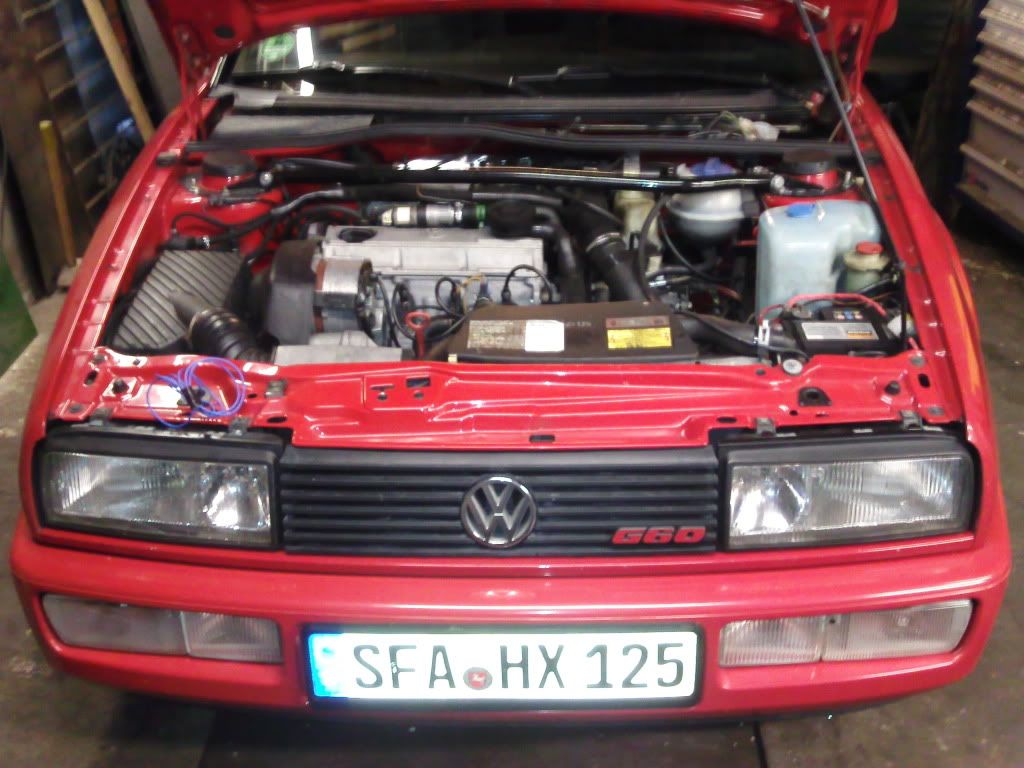

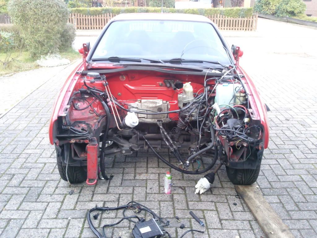

Well after a three month setback,i decided it time to get that 1.8t lump in the car and have some fun.Got lots of hoses and bits to make sure i can do it in a oner! Found that when using the Golf G60 intercooler some of the raddo G60 boost hoses fit nearly perfect on the left hand side from what i can see.only time will tell

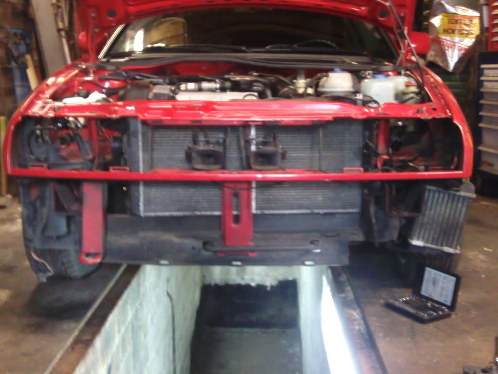

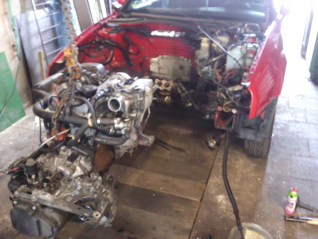

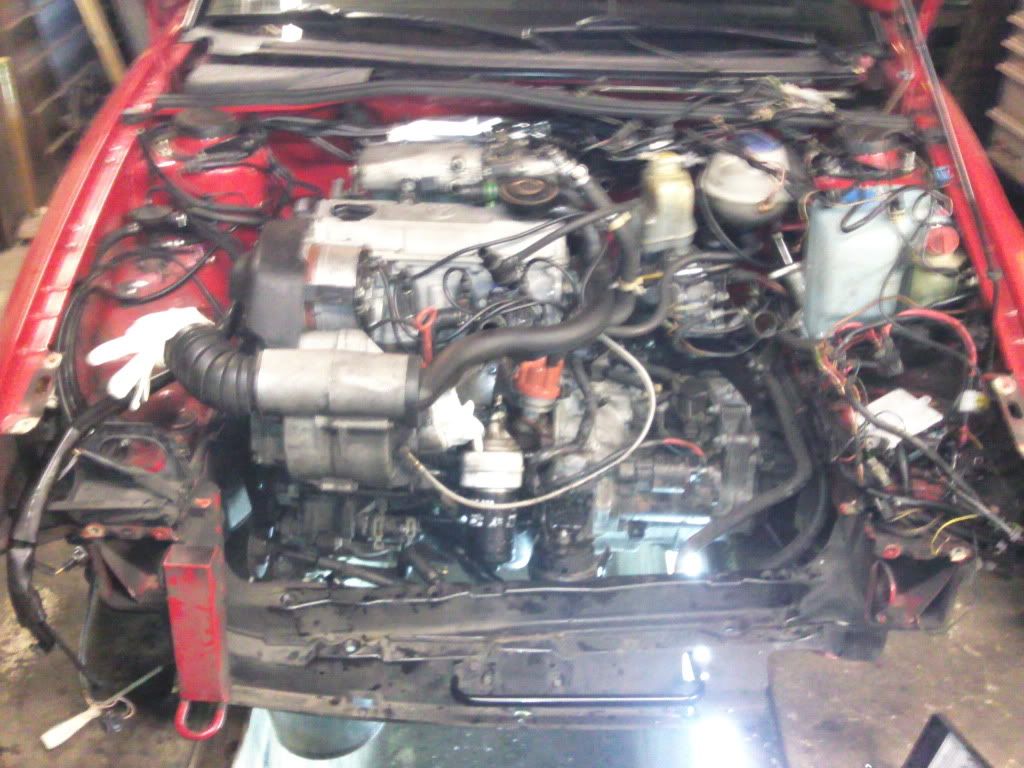

Started at 5 pm today,nearly ready to be lifted by 8 pm.Lady luck was probably on my side as most bolts and nuts came off easy with the exception of the cat bolts+nuts.
Drive shafts and mounting bolts to do tomorrow then old lump out.Would be easier if i had a second person as i working alone at the moment,might annoy the father-in-law tomorrow to help
All electrical disconnected,hoses off,exhaust nearly done,just drive shafts and mounting bolts to go,fifthteen minute job

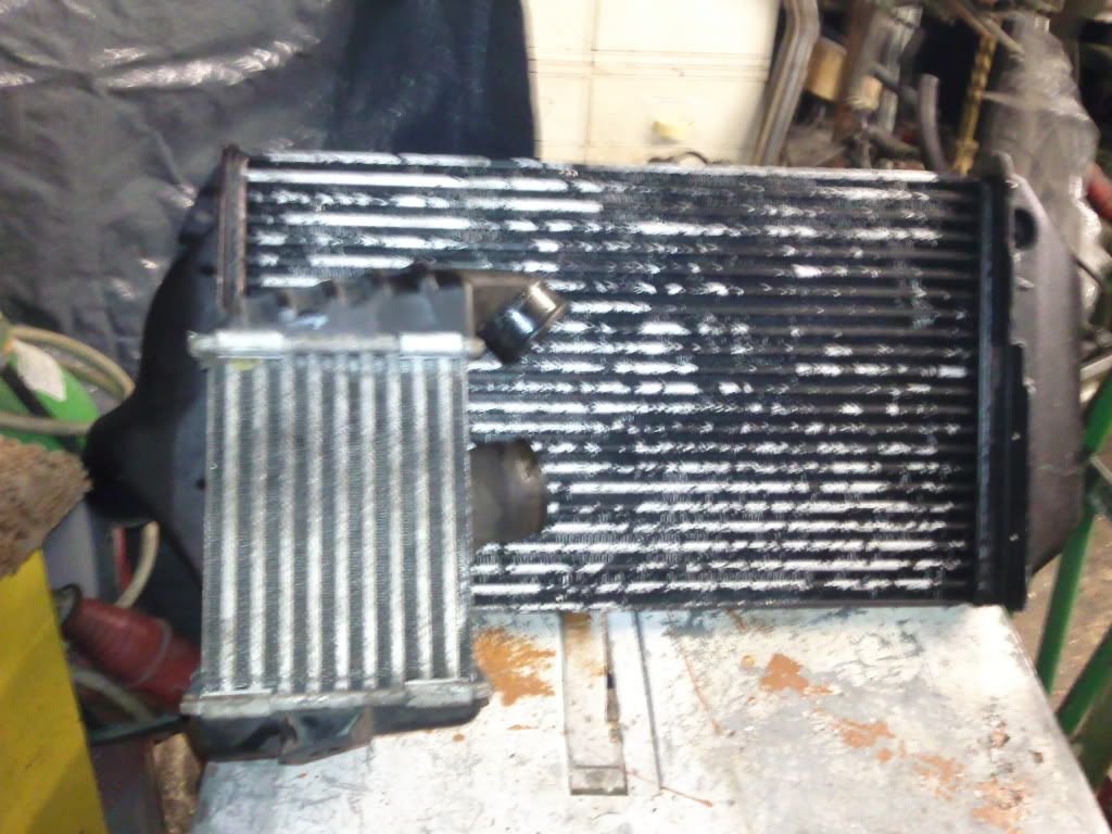

Anyone wondering the Golf G60 intercooler compared to the stock raddo G60 one,just a tiny bit of difference

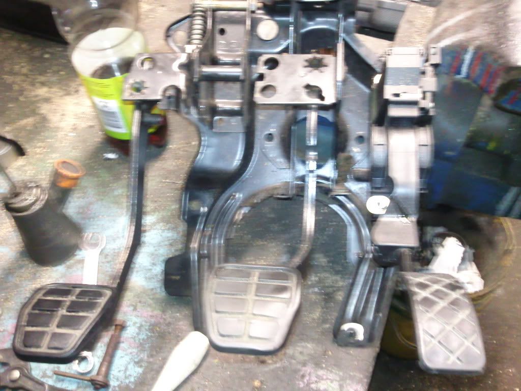

Got a bit futher today,engine out and swapped the pedal box for the DBW one.tomorrow i start wiring in the harnesses so fingers crossed i goes off without a problem.

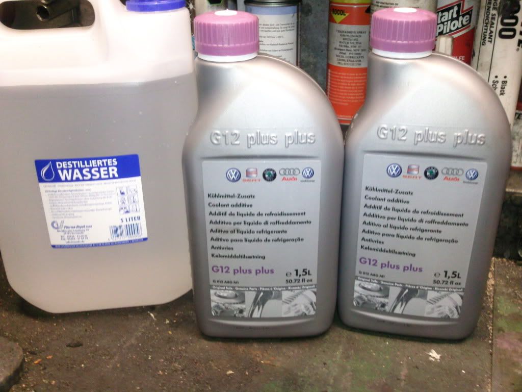

3 litres of vw's finest coolant,g12++

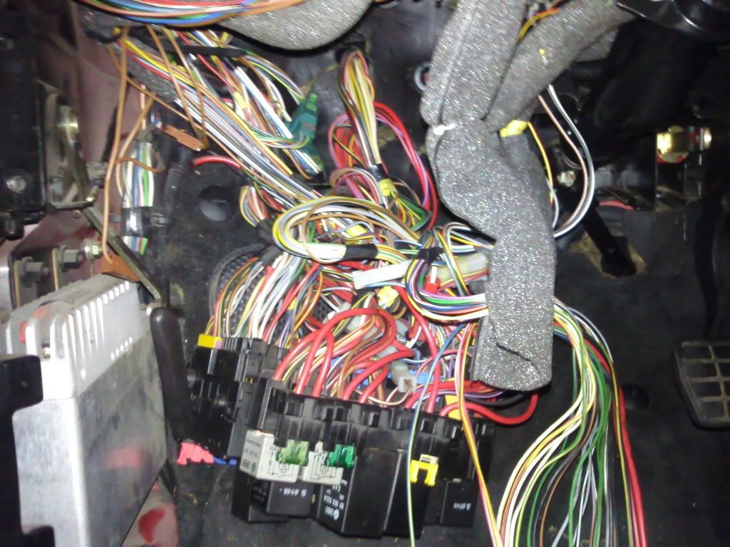

After four days of head banging electrics my 20vt burst into life.... But my DBW pedal isnt responding.and it has very tempermental starts.Sometimes straight start,others it needs two-three cranks.
Ive been cross referencing three different parts which nearly broke me-Ecu is from APX engine which is good because its an APX engine but the wiring loom is from a unknown 1.8t(maybe golf?) and doesnt have cruise control and some of the wires are different colours or end in different places.Next i have confirmed that i have a 1990 g60 wiring as the wiring is a bit different than other and caused a massive headache.I have the bentley on disc and the one page i need on the disc is not showing up(maybe disc data is missing?)

Im missing page 10 of 1990 wiring diagram(one after the digifant relay+fuel pump relay) which is still causing me problems.It could be something simple,i dont know. Major problem i was having was i was only getting 3.5 volts on switched live using a relay for coil packs common earth. So i gave it a constant 12v feed and it burst into life.
Also the ABS light is staying on but pump runs,strange.all sensors are connected.
