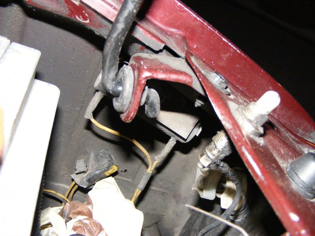

Jon_vr6 1 Posted June 28, 2011 (edited) Its not mate unless you've got some after market thing, your right that it connects to the slam panel when it down (not in use). have a closer look and you'll see that it connects to the wing on a rubber grommet trust me!! Edited June 28, 2011 by Jon_vr6 Quote Share this post Link to post Share on other sites

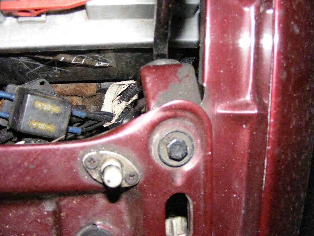

Critical_Mass 10 Posted June 28, 2011 Hi Jon, Sorry if i sound like im doubting you but im pretty sure mine is def attached to the slam panel (grommet end), unless im being completely stupid. Ive attached some pics to show you. Sorry for the pics - its dark outside. EDIT - looking at the first pic. is the pit of metal that the grommet is in an extension of the wing and the slam panel is then attached to IT? Quote Share this post Link to post Share on other sites
VWVW 1 Posted June 28, 2011 (edited) Its attached to the wing...here is a pic of it when I dismantledd my front end with the slam panel taken off. If you need to take the slam panel off.. Iam sure the front bumper will needs to be taken off to allow access to 2 bolts on either side of the slam panel. Edited June 28, 2011 by VWVW Quote Share this post Link to post Share on other sites
Critical_Mass 10 Posted June 28, 2011 (edited) Ah in that case im sorry i doubted you Jon - i was being a daft pillock :lol: :notworthy: Does it all need supporting like that or did you do that cos you took the cross member engine support off too? Edited June 28, 2011 by Critical_Mass Quote Share this post Link to post Share on other sites
